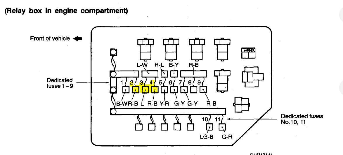

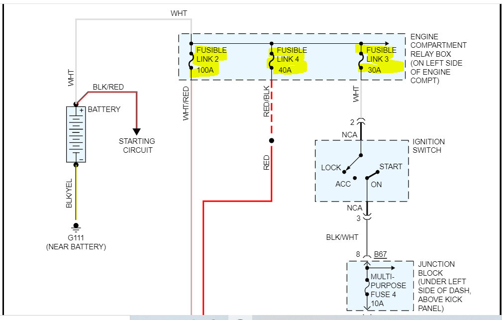

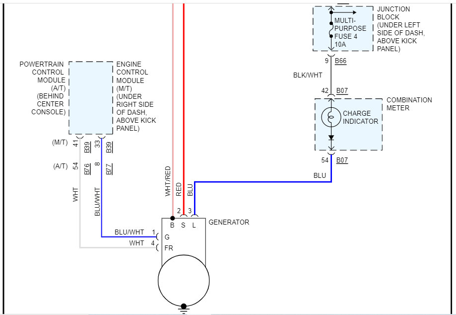

If you go to the alternator, check to see if the white wire with a red tracer has power and the solid red wire does as well. According to the wiring schematic for the charging system, these two wires receive power directly from the battery. So, they should have B+ at all times.
I attached the wiring schematic below for you to reference. Here is a link you may find helpful when checking the wiring:
Let me know what you find. Additionally, pic 3 shows the locations of the fusible links in the under-hood fuse box.
