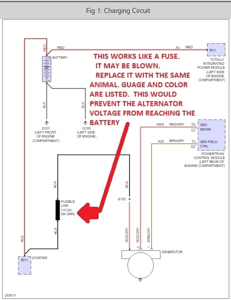

Changed alternator still will not charge. I do not have image or video.

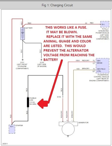

Sometimes hooking jumper cables wrong, even for a split second, might cause a fusible link to blow.
I uploaded a diagram of the charging system. Click on it below.
I added some text on it.
Let us know how it goes.
