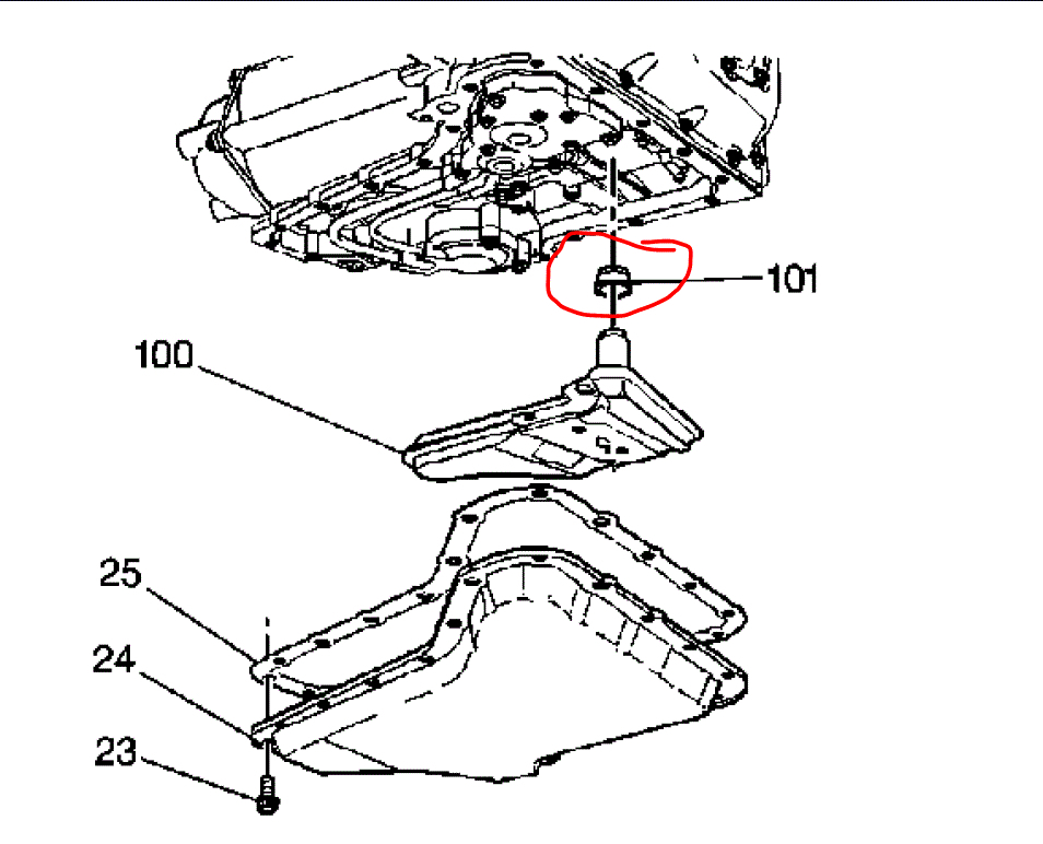

When you place it in drive, do you feel it shift into gear? Also, if I understand correctly, when you try to accelerate when in drive, the engine revs and the vehicle doesn't move. Tell me, how dirty was the fluid when you removed changed it and the filter? Also, when you installed the new transmission filter, did you remove the old o-ring in the valve body and install a new one on the new filter?
If you look at pic 1 below, I indicated the seal I'm referring to. It is very easy to forget the old one is there.

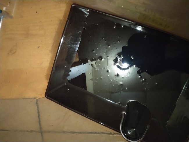

Is that as black as it looks in the pic? Also, did this happen all at once? Usually, clutches will start to slip before the vehicle won't move. If that isn't what happened and it did happen all at once, it does sound like a pressure issue.

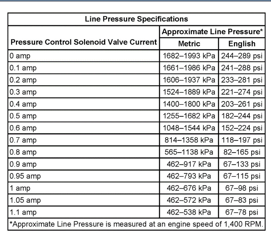

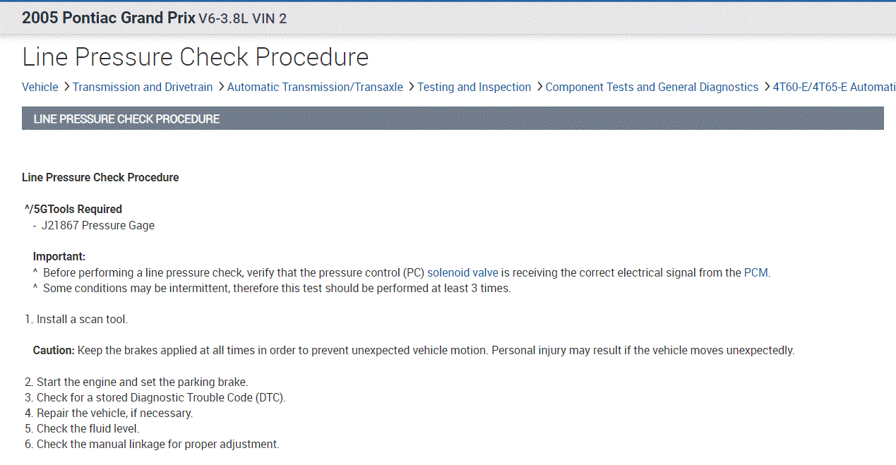

I reread your original post. If the fluid was that black and you were having issues as described, the new fluid could have finished off the clutch friction plates. Once they get extremely dirty and wear, the new fluid actually will clean the dirt off the clutch plates and cause them to slip. However, before I would say that is the issue, make sure the linkage is properly connected. If it is and the gear indicator is accurate, I would check line pressure.

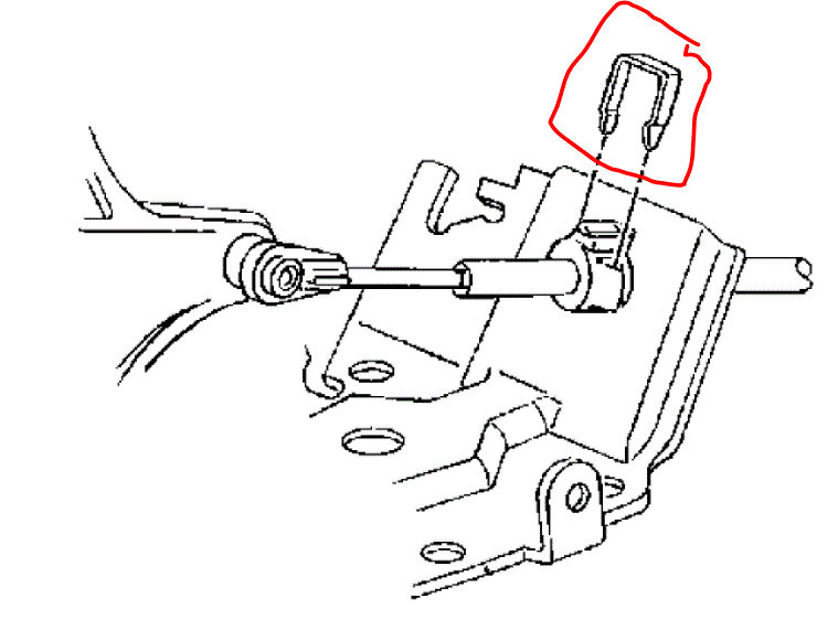

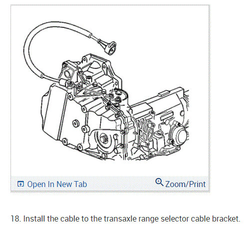

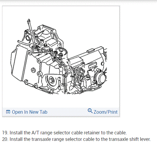

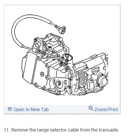

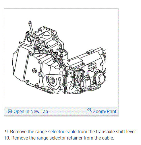

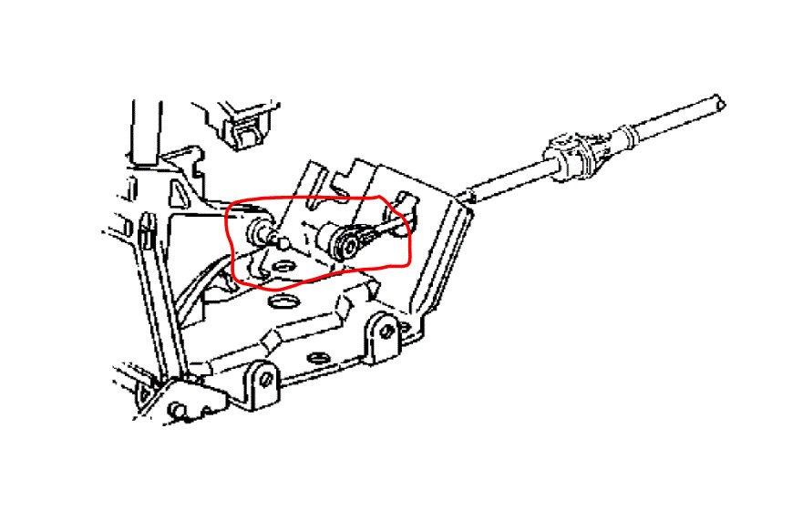

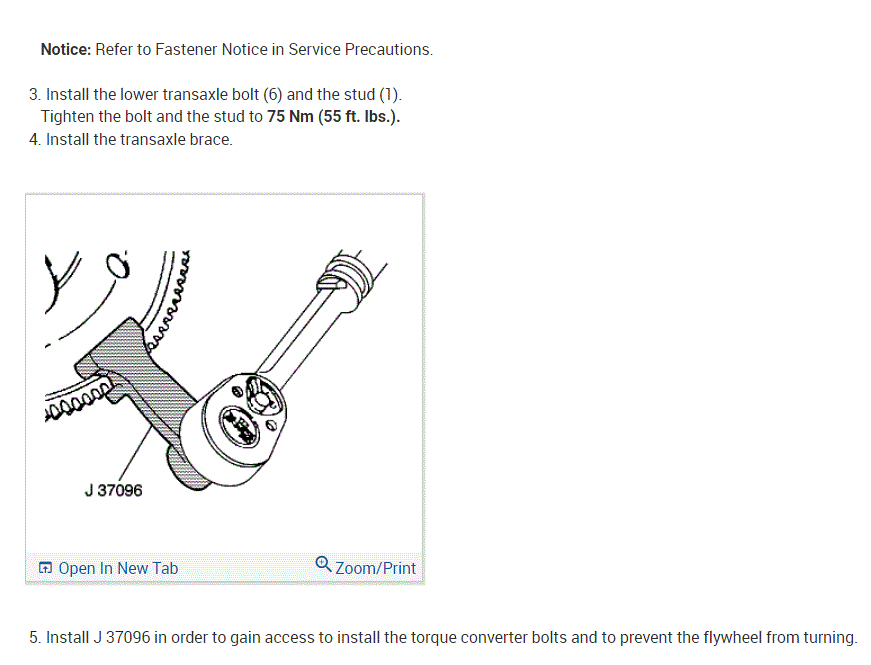

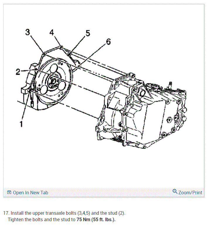

Have a helper shift through the gears while you watch the shift cable on the trans. See attached pics (1 and 2). There is a clip that could have broken that holds the cable in place. If it broke or fell off, the cable won't shift the trans properly, so check that too.

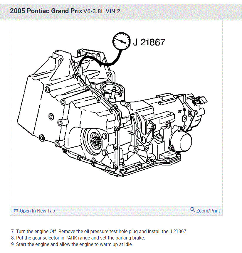

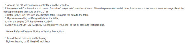

The remaining pics explain how to test line pressure. You will need a gauge and scanner to perform the test. The last pic includes the line pressure specifications.

It kind of did happen all if a sudden because it started doing this about a week after I got the cooler line fixed and yes the fluid is actually that black.

I have a feeling the clutches are done. However, it wouldn't be a bad idea to do the line pressure test. At least we can eliminate that as a possibility.
As dark as the fluid is leads me to believe there are internal issues.

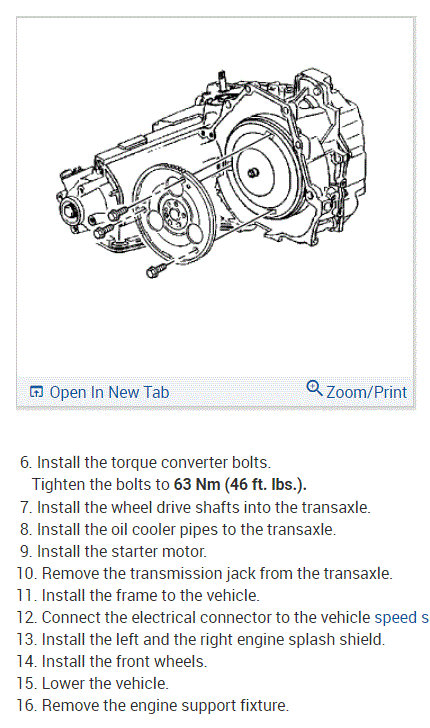

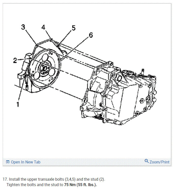

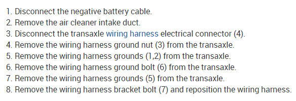

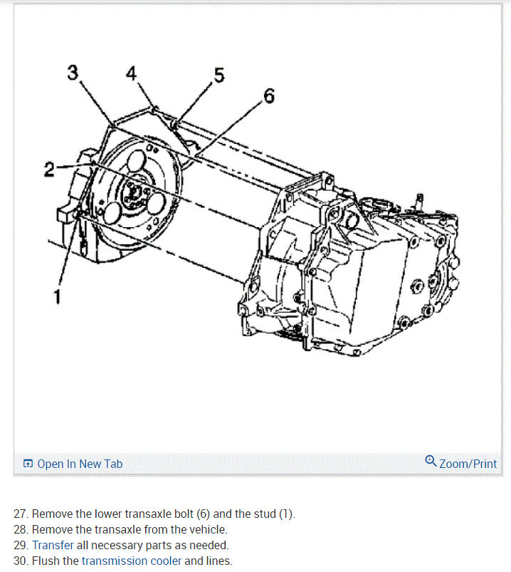

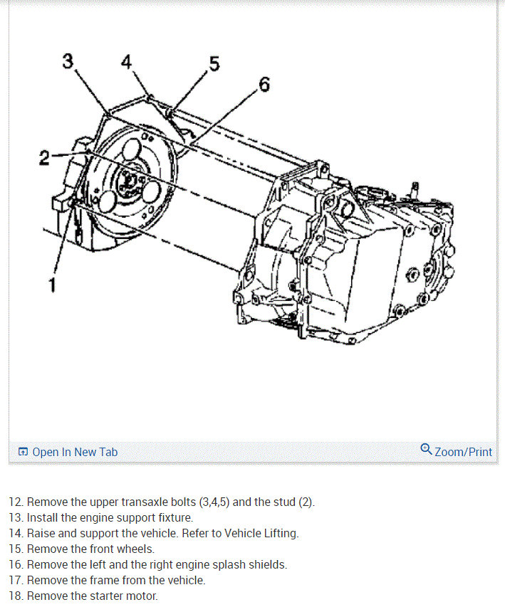

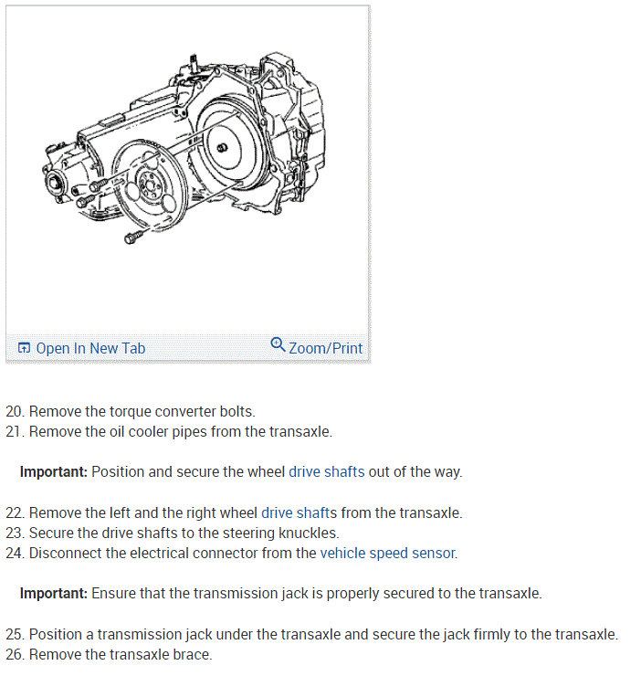

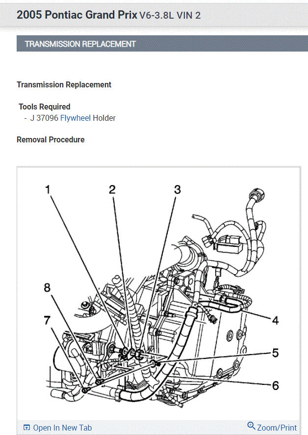

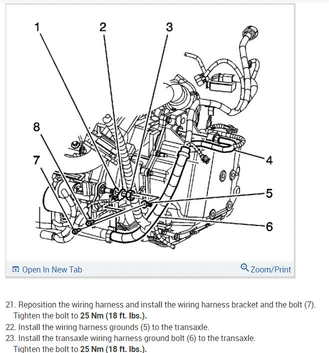

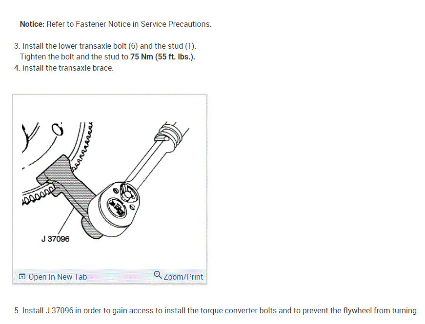

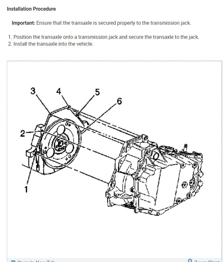

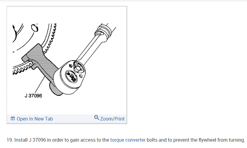

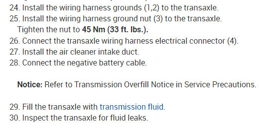

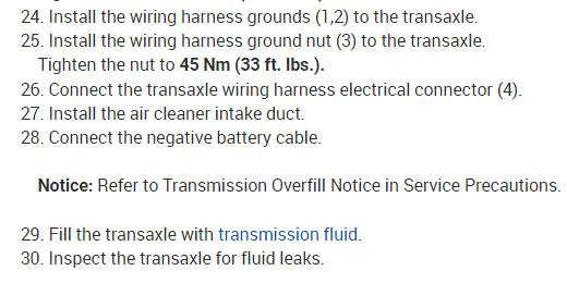

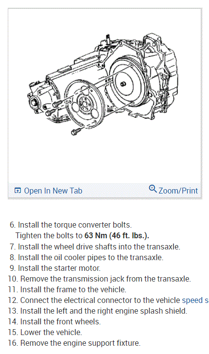

I don't know your plans, but in the event the trans needs replaced, I attached the directions below. The directions and pics are specific to your vehicle.
