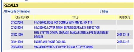

IMPALASS
  • 3,112 POSTS
Hello -
Great to see you got it running. . .. . .. . ..
By the way, you may have some recalls on your vehicle. The dealer may fix these for free. Please contact the dealer service department, give them the VIN number of your car and have them check on these to see if they apply to you.
https://www.2carpros.com/forum/automotive_pictures/248015_Recall_1.jpg
