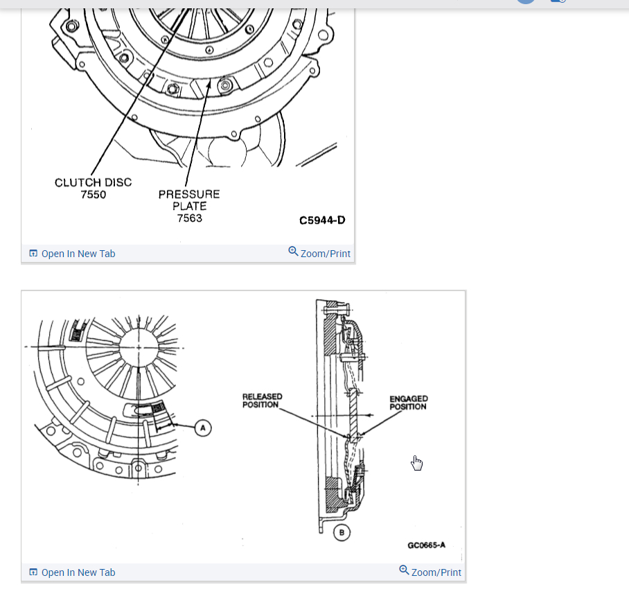

It wont shift into any gears but 4th. Is the clutch dropped completely or is it the pressure plate, throwout bearing or what??? Transmission out completely?
Apr 13, 2021 at 7:41 AM

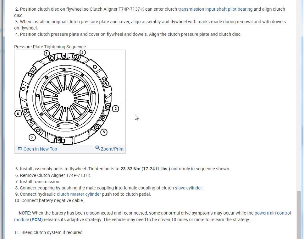

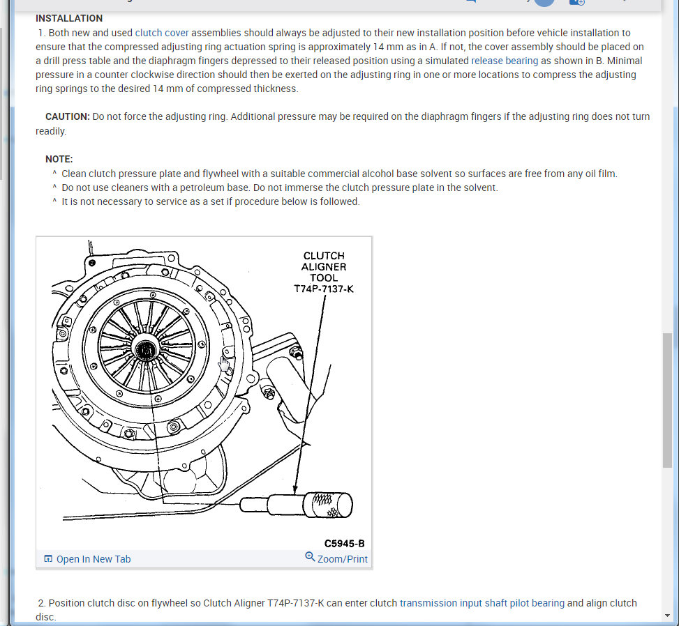

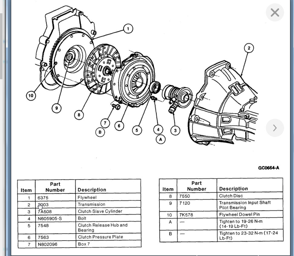

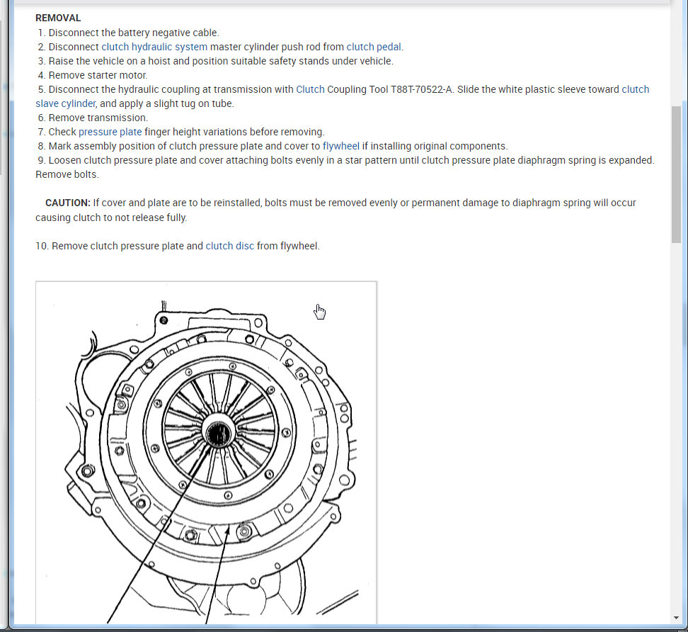

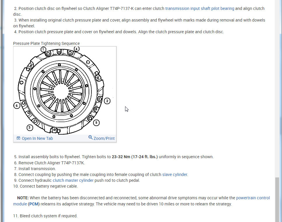

Yes. You need to remove the transmission and I would replace everything shown below so you don't have to go back in when the next part fails.
Here are some guides that will help:
https://www.2carpros.com/articles/how-to-replace-a-clutch
https://www.2carpros.com/articles/throw-out-bearing-replacement
https://www.2carpros.com/articles/pilot-bearing-replacement
Below is the process from the manual that will help with this as well.
