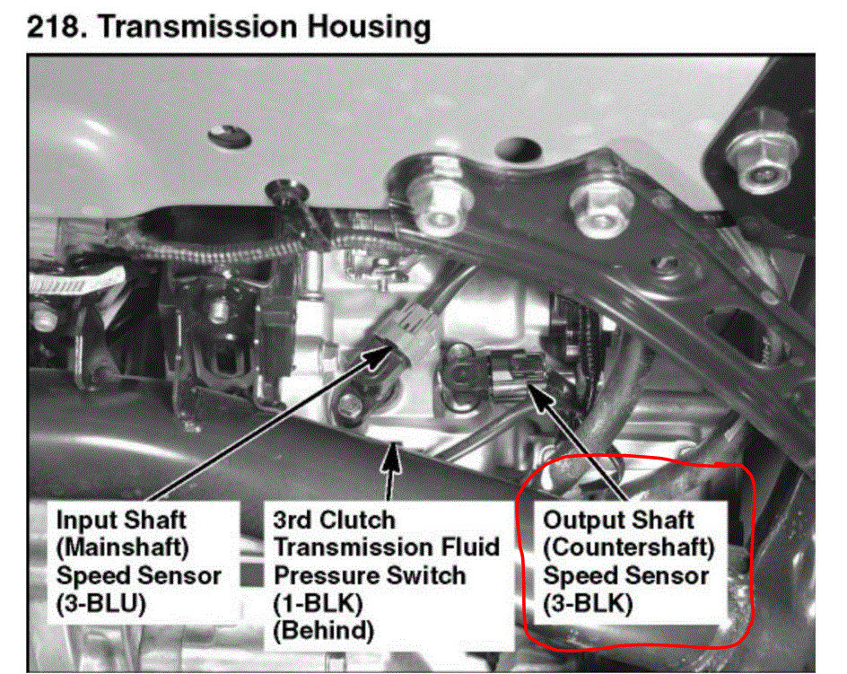

Hi, my fiancé’s vehicle listed above just started having problems where it won’t change gears at all, even manually from second to third and the speedometer doesn’t move off of 0. There are no lights on and I had the car scanned and all that came up was an ABS code that was unrelated.
Jun 16, 2020 at 7:58 AM
  • 110,240 POSTS
Chances are the vehicle output speed sensor has failed. The sensor is on the side of the transmission. If you look at pic 1, it shows location.
First, make sure the connector hasn't been damaged or has come loose. If it appears okay, without testing further, that is my first suspect.
By the way, what code was found because that can all tie together.

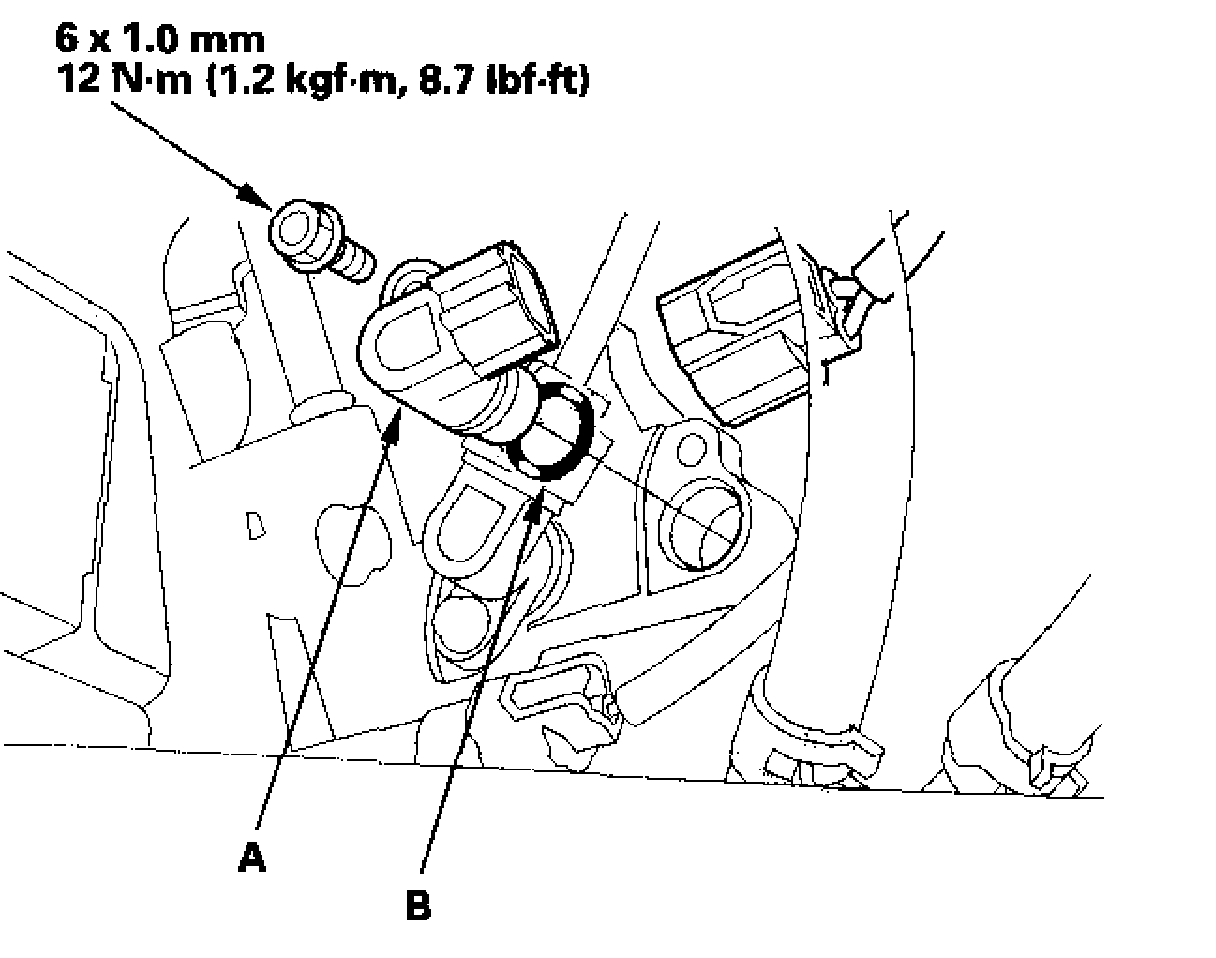

Here are directions for replacing the sensor. Pic 2 correlates with these directions. Please let me know what code was found for the ABS before you replace the sensor.
_______________________________________________
2006 Honda Truck Pilot 4WD V6-3.5L
Output Shaft (Countershaft) Speed Sensor Replacement
Vehicle Powertrain Management Transmission Control Systems Sensors and Switches - Transmission and Drivetrain Sensors and Switches - A/T Transmission Speed Sensor Service and Repair Procedures Output Shaft (Countershaft) Speed Sensor Replacement
OUTPUT SHAFT (COUNTERSHAFT) SPEED SENSOR REPLACEMENT
Output Shaft (countershaft) Speed Sensor Replacement
1. Remove the splash shield.
pic 2
2. Disconnect the output shaft (countershaft) speed sensor connector, and remove the output shaft (countershaft) speed sensor (A).
3. Install the new O-ring (B) on the new output shaft (countershaft) speed sensor and apply clean ATF to the O-ring, then install the output shaft (countershaft) speed sensor in the transmission housing.
4. Check the connector for rust, dirt, or oil, then, Connect the connector securely.
5. Install the splash shield.

Hi Joe, thanks for your help. I really appreciate it. I honestly don’t know the code. The mechanic only said it was unrelated to the issue she’s having. Your answer was also his initial suggestion as to the problem. I will take it to him tomorrow and have him put the sensor on. Fingers crossed and prayers that it solves the problem. Thank you again.

You are very welcome. And honestly, the ABS issue can be related. If the vehicle has stability control, everything ties together.

Hey Joe, just wanted to reach back out to you and tell you that we replaced both the input and output sensors. They were both looking worn out and chewed up and that seemed to have cured the problem completely. Thank you for all of your help. I really appreciate it. My fiancé is a happy lady again, haha.

Hey Joe, the car was working fine until this afternoon and now it’s doing the exact same thing again. Won’t change from 2nd to 3rd and speedometer won’t work at all. Any more ideas?
Jun 19, 2020 at 6:26 AM
  • 110,240 POSTS
Move the wiring around on the sensors you replaced. Chances are there is a bad connection or a broken wire. When you installed the new sensors, it was likely making connection.
