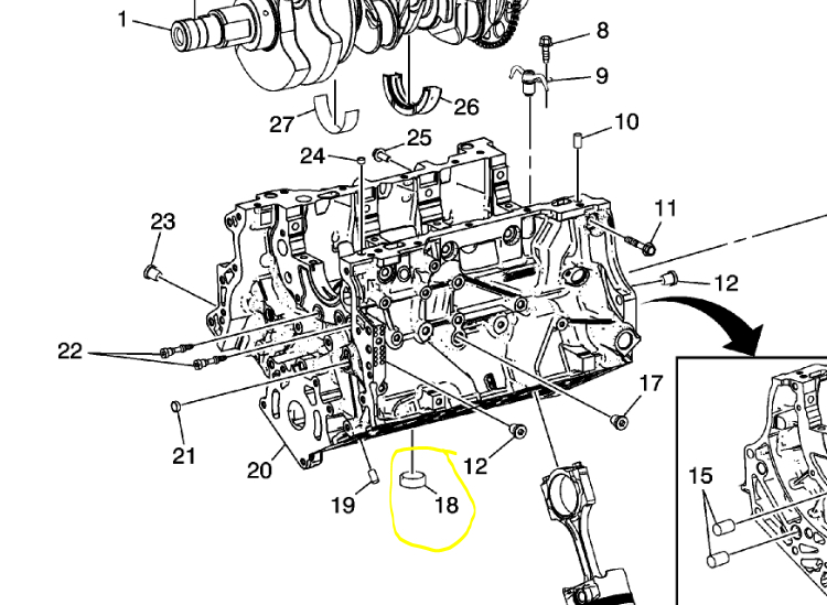

Does this vehicle have freeze plugs?
2014 CHEVROLET TRAVERSE
200,000 MILES • 3.6L • 6 CYL • 4WD • AUTOMATIC
SMITH0211
I went to my local AutoZone and nothing came up.

Yes, there is an engine block expansion plug/freeze plug for this vehicle. See pic below. Note the engine in the pic is upside down. It's the only one I could find showing the freeze plug. It's number 18 in the pic.
As far as the plug is concerned, it is 34.3mm in diameter.
Let me know if this helps.
See pic below.
