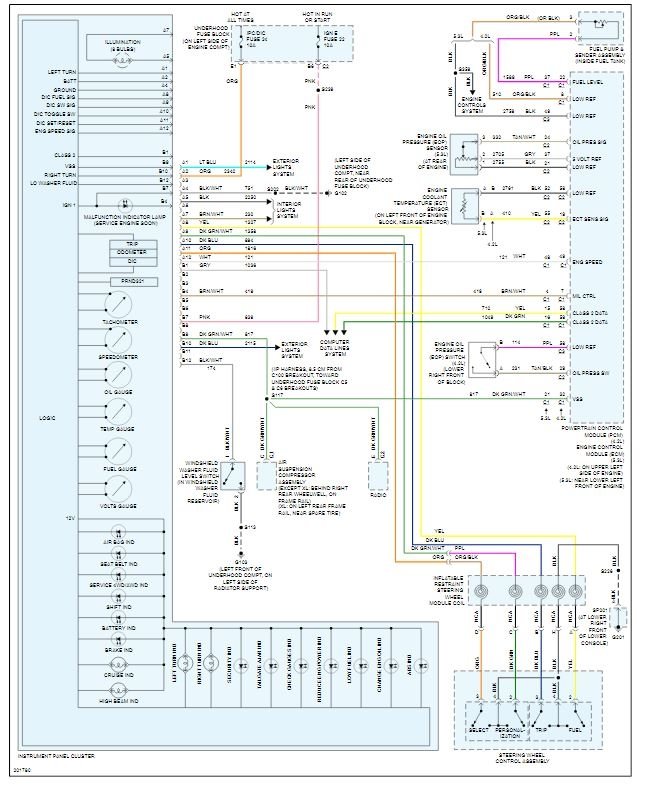

Instrument cluster wasn’t working, I checked all the fuses none of them were blown. so I went to the junkyard got a different cluster that didn’t work either. I’m wondering if I can just use the ultra gauge for a temporary solution to see the gauges I need will this work?
Jun 8, 2019 at 1:22 PM
KENW1
  • 213 POSTS

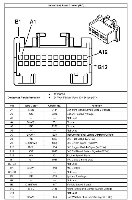

Thanks for visiting 2CarPros. The ultra gauge will give you the gauges you nee to operate the vehicle safely. if you want to troubleshoot the gauge issue further I'll post the wiring diagram below.Check all pins showing that they should have voltage for 12 volts and the grounds for continuity to ground.
