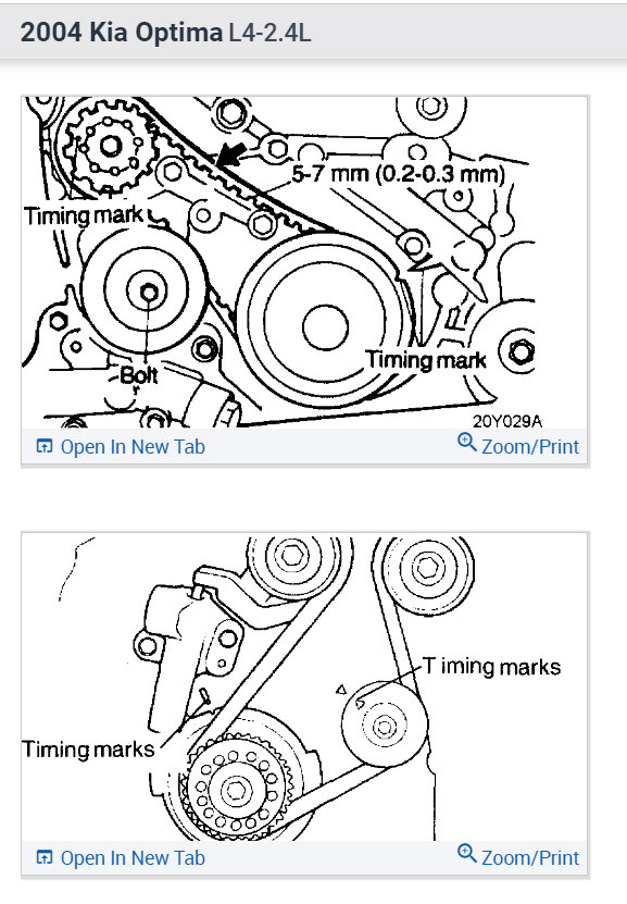

when my vehicle gets hot it loses power timing retards?
165 MILES • 2.4L • 4 CYL • 2WD • AUTOMATIC
JEFFREY WOLFF SR.
I get cam Sensor malfunction. just replace cam sensor for same fault code. drive 10 miles with A/C on makes it worse. installed correct plugs, wires, and a new timing belt. It just started 10 days ago. help
Jun 15, 2023 at 6:05 AM
  • 55,711 POSTS

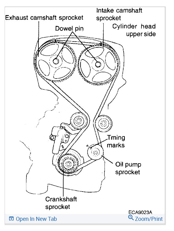

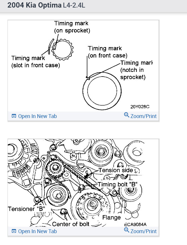

First best avatar ever! lol what is the code number you are getting? I would make sure the timing belt is in good shape because it can jump time, here are the timing belt marks so you can check it and do a replacement if needed. Check out the images (below). Let us know what happens and please upload pictures or videos of the problem so we can see what's going on.
