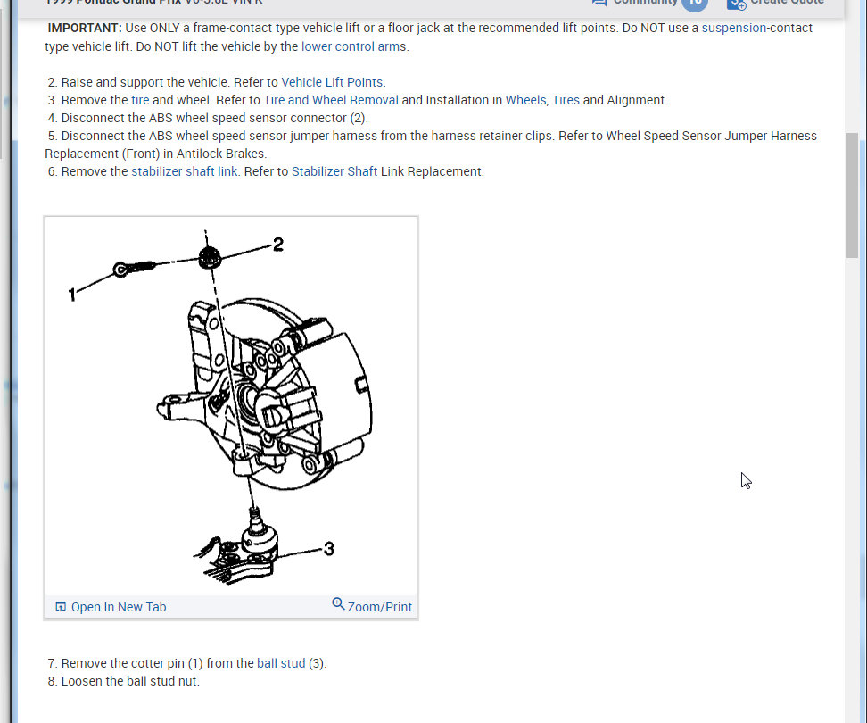

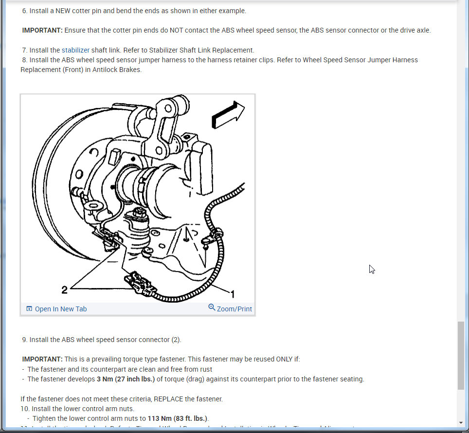

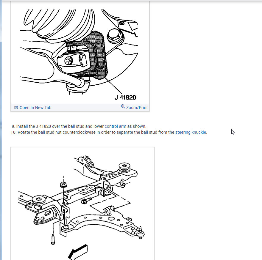

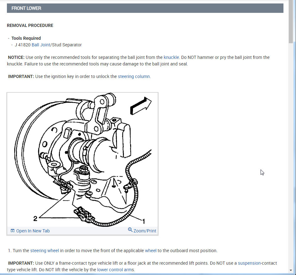

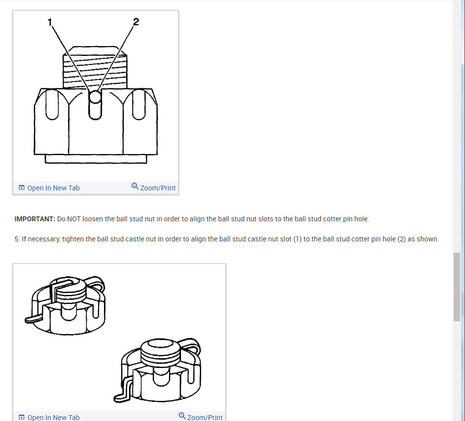

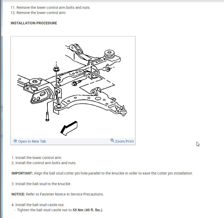

That is great that you found that. If the lugs were tight then that was the next thing we were checking.
So that means it is most likely the lower ball joint which means the control arm needs to be replaced. I am attaching the process below of the control arm.
Feb 11, 2021 at 12:01 PM

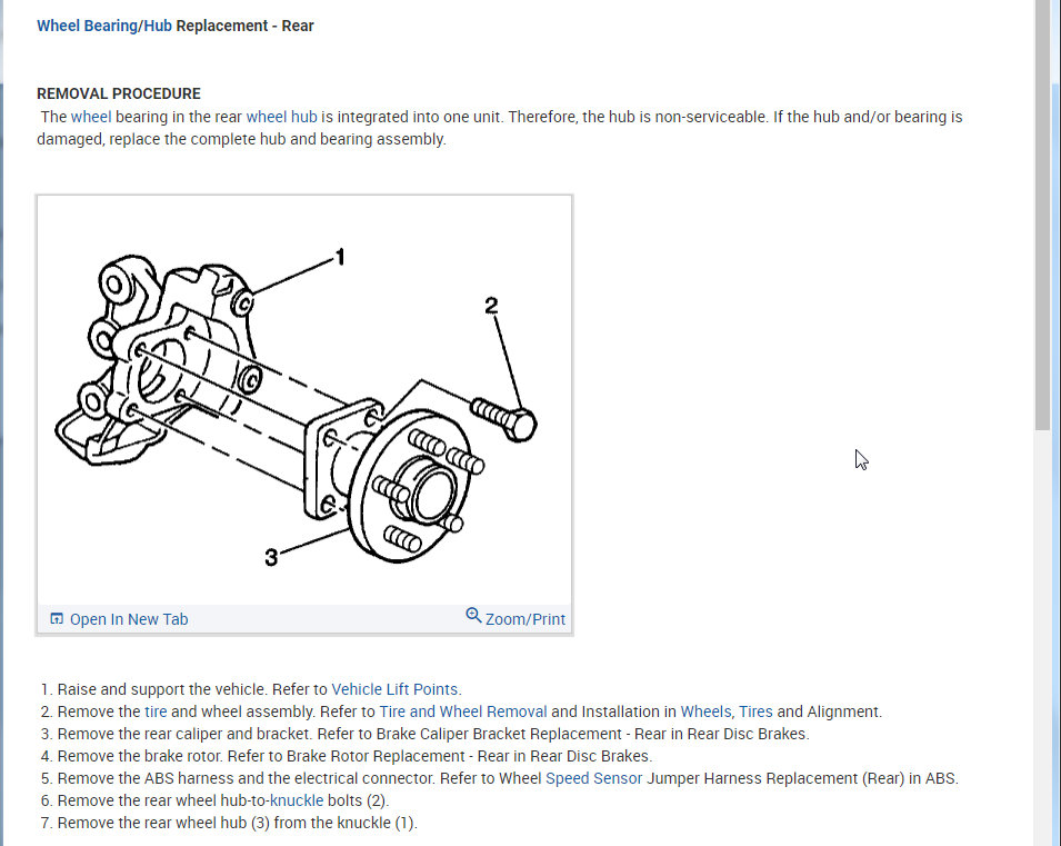

That is great that you found that. Wheel bearings are less likely when you have movement at 6 and 12 but once you add in the info of you get movement in all directions, then that points solely at the wheel bearing.
https://www.2carpros.com/articles/how-to-replace-front-wheel-bearings-and-seals
Here is the process from the wheel bearing as well. Thanks for the update.
