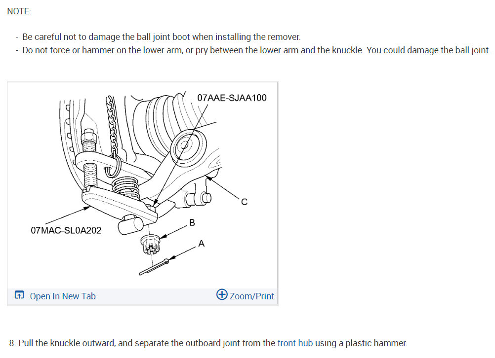

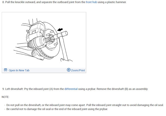

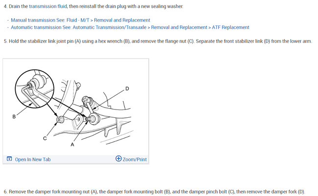

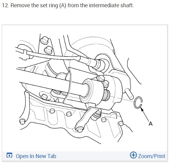

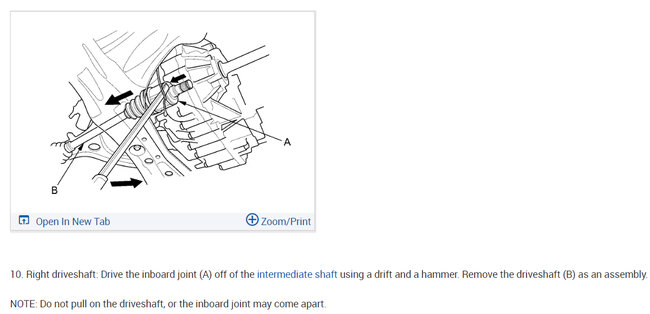

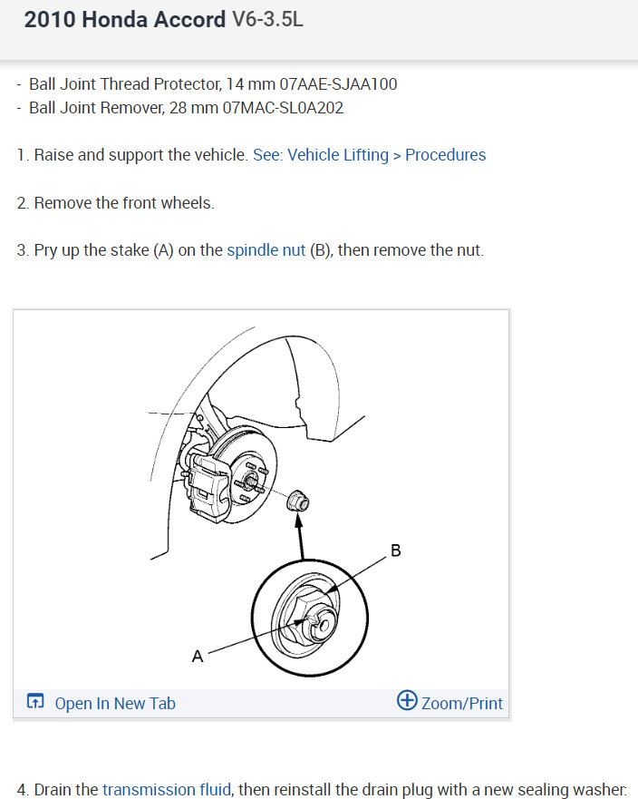

  • 55,808 POSTS

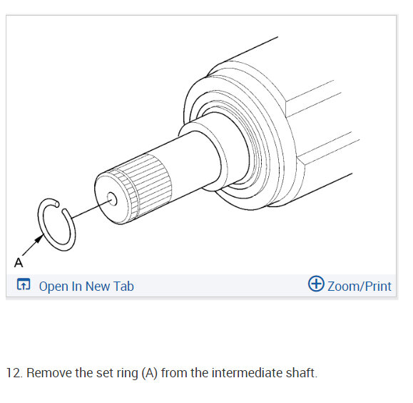

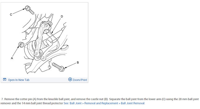

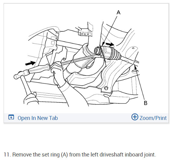

Low speed wobbles are usually the tire or CV axle. Since you say the tires are okay I would swap out the CV axle, her is how. Check out the images (below). Please let us know what happens.
