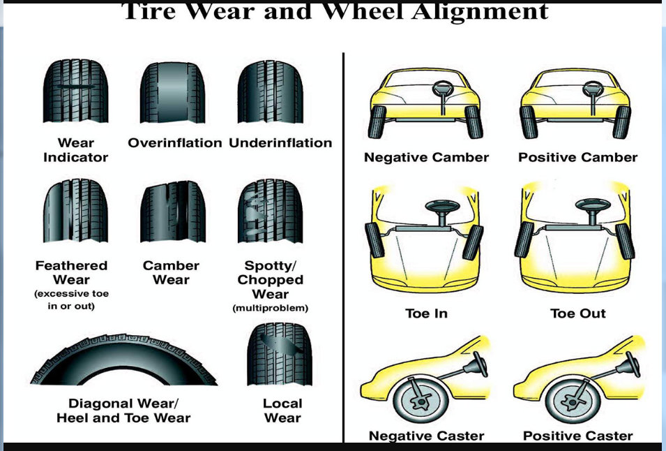

Also, are the tires showing any kind of wear on them? That will give us a good idea what the issue could be.
Please see the chart below and let us know what you find with this. Thanks
