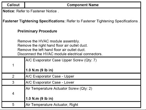

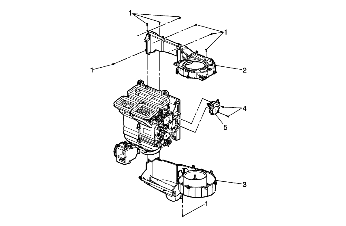

When heater is turned on, it blows hot air on the driver side, but it blows cold air on the passenger side. How do I know which actuator to replace? there are three of them.

Sounds like you have a bad passenger side blend door actuator.
Oct 23, 2017 at 3:48 PM
STEVE W.
  • 15,239 POSTS
The right hand side actuator is a bear on those. GM put it inside the HVAC case. Instead of where it can be reached from outside.
