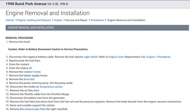

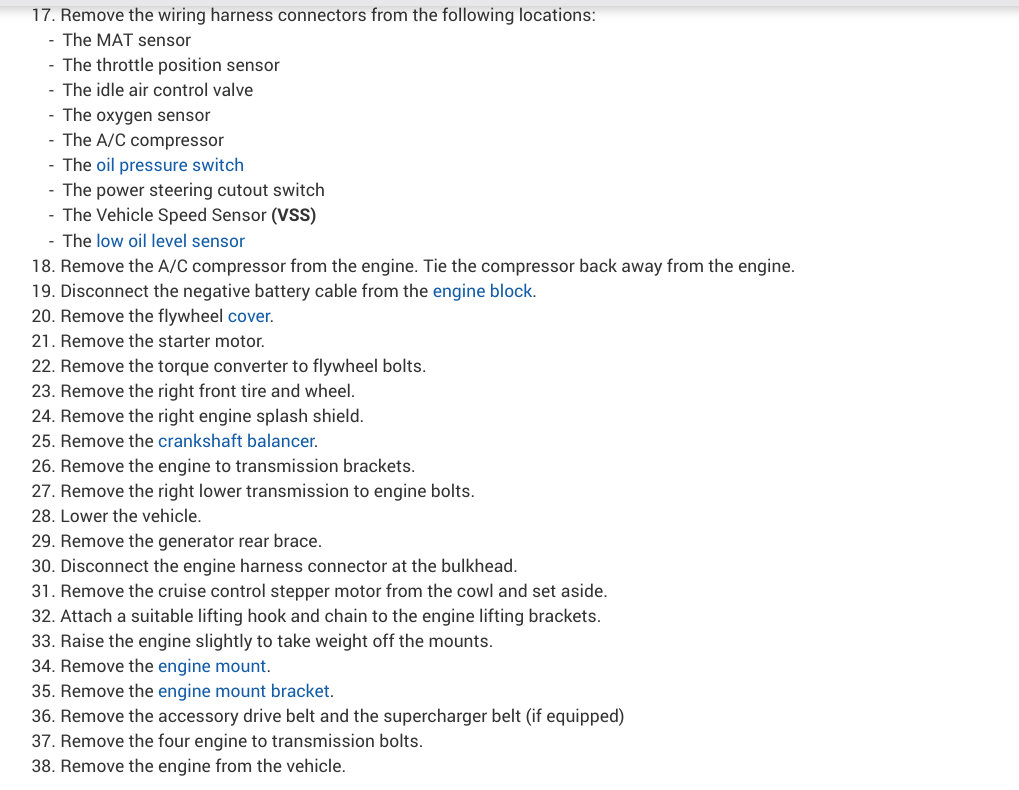

My Dad and I are trying to remove the engine from our car listed above. As far we can tell there should be nothing hindering the engine as we removed all the bolts. Of course we have the engine supported by a cherry picker, but after releasing tension, the engine remains suspended. We are wondering how to remove the wish bone engine mount bracket so we have enough room to pry and shimmy the engine off of the transmission.
Thanks in advance.
Dec 9, 2019 at 10:37 AM
SCGRANTURISMO
  • 4,897 POSTS

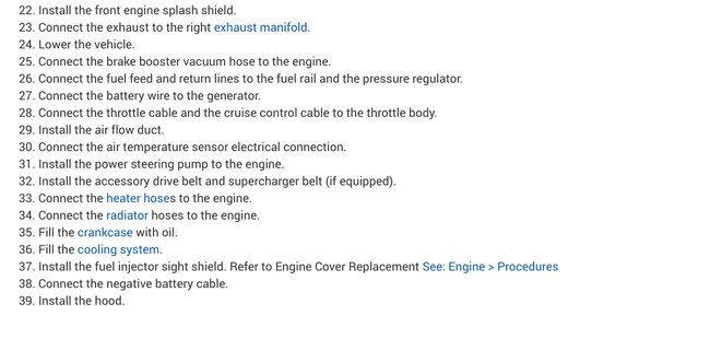

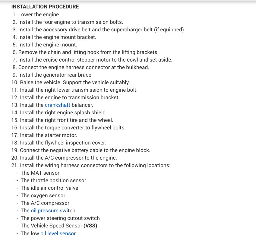

I have included the guide for the removal and installation of the engine in your vehicle from the manufacturer. Please go through this guide and ensure that all the steps have been followed. Please get back to us and we can address anything that needs to be addressed then.
