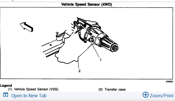

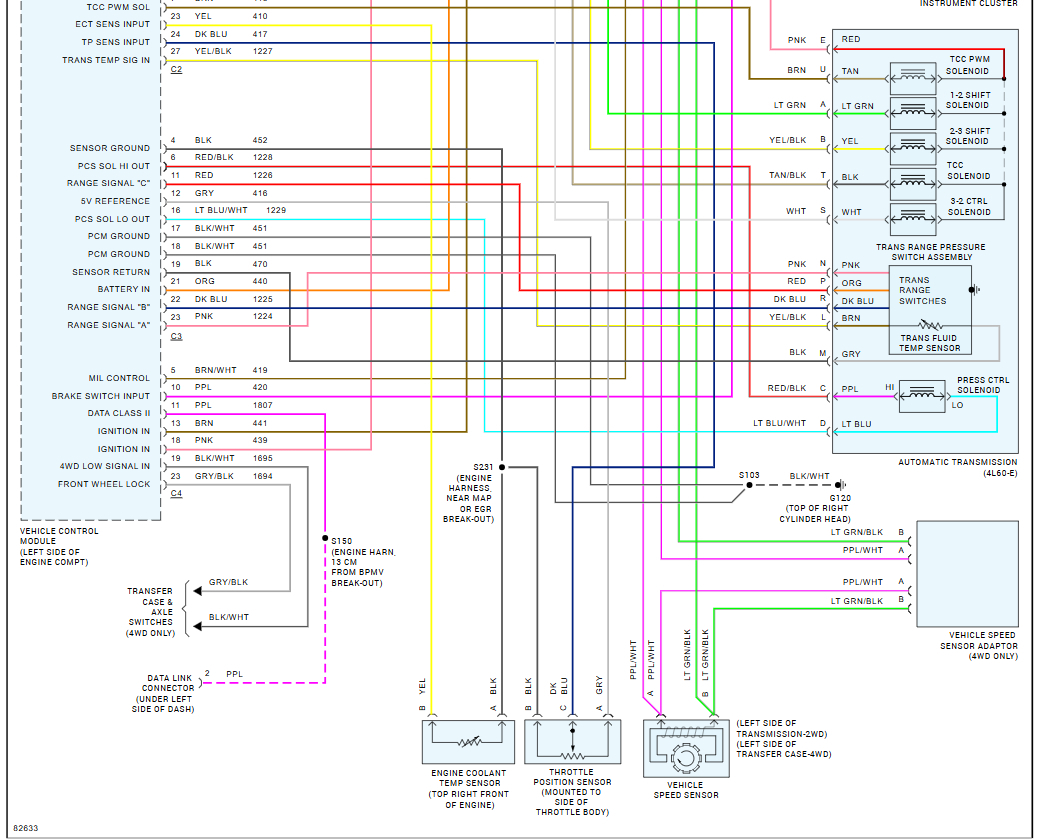

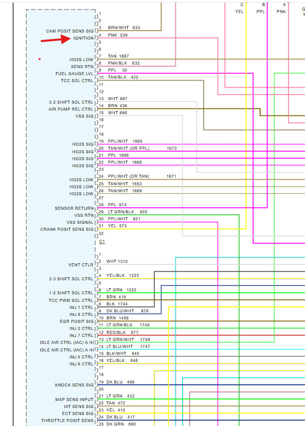

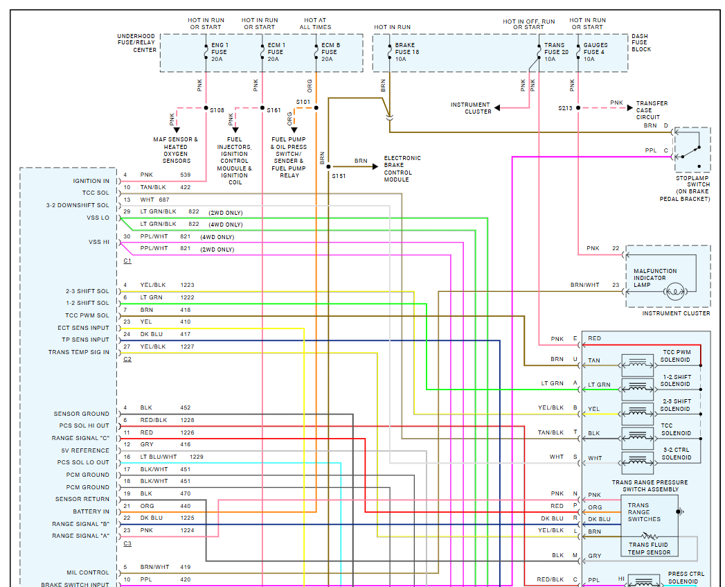

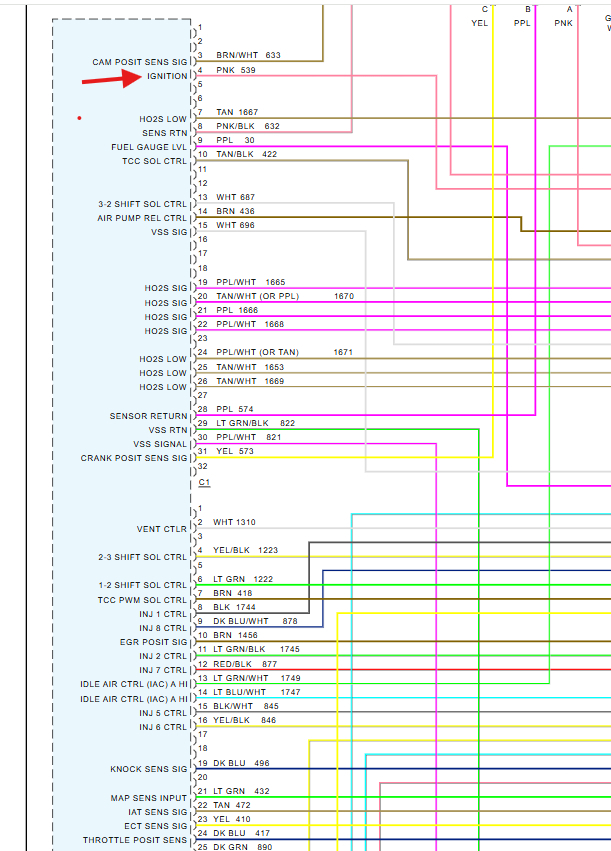

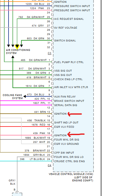

So you have the VSS wiring connected to the transferase sensor, also there is a VSS in the transmission as well that is used while the 4wd is not engaged. So, both need to be wired correctly, here are the wiring diagrams so you can double check your work. Check out the images (below). Let us know what you find.
Aug 8, 2025 at 4:44 AM
ROBBERGERON55
  • 17 POSTS
if you're speaking of the purple/white and green/black wire, which is shielded, yes it is intact, as well as after making and installing a temporary test wire, (prior to opening up harness to inspect for any damages) to verify that the sensor was working. how would i legitimately test this sensor if needed? if a second sensor is "in" the transmission, are you saying internally? or plugged into the transmission case? i see a.
Aug 8, 2025 at 7:47 AM
  • 55,433 POSTS
Sorry I was mistaken, there is only one VSS, my bad. It is in the tail housing of the transfer case. You can unplug it and use a voltmeter on millivolts and then spin the driveshaft and you should see voltage generated.

Okay, then the sensor is working. I would test the wiring between the sensor and the PCM, here is a guide to help:
Use the wiring diagrams above to see which wires to test and where in the PCM wiring connector they are. Let me know what you find.
Aug 9, 2025 at 2:34 AM
ROBBERGERON55
  • 17 POSTS
audible tone/ continuity showing good on vss harness

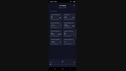

scanner, as in an obd2 scanner? would an Ediag elite scanner work on this? its a bidirectional/ active test one.. or, are you wanting me to probe the pins on the vcm connector?
Aug 18, 2025 at 8:50 PM
  • 55,433 POSTS
Yes, that scanner should work. See if it has an option to see vehicle speed.
Aug 19, 2025 at 1:03 AM
ROBBERGERON55
  • 17 POSTS

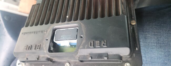

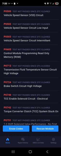

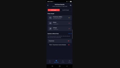

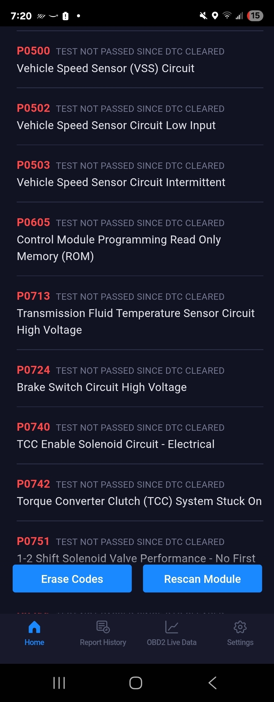

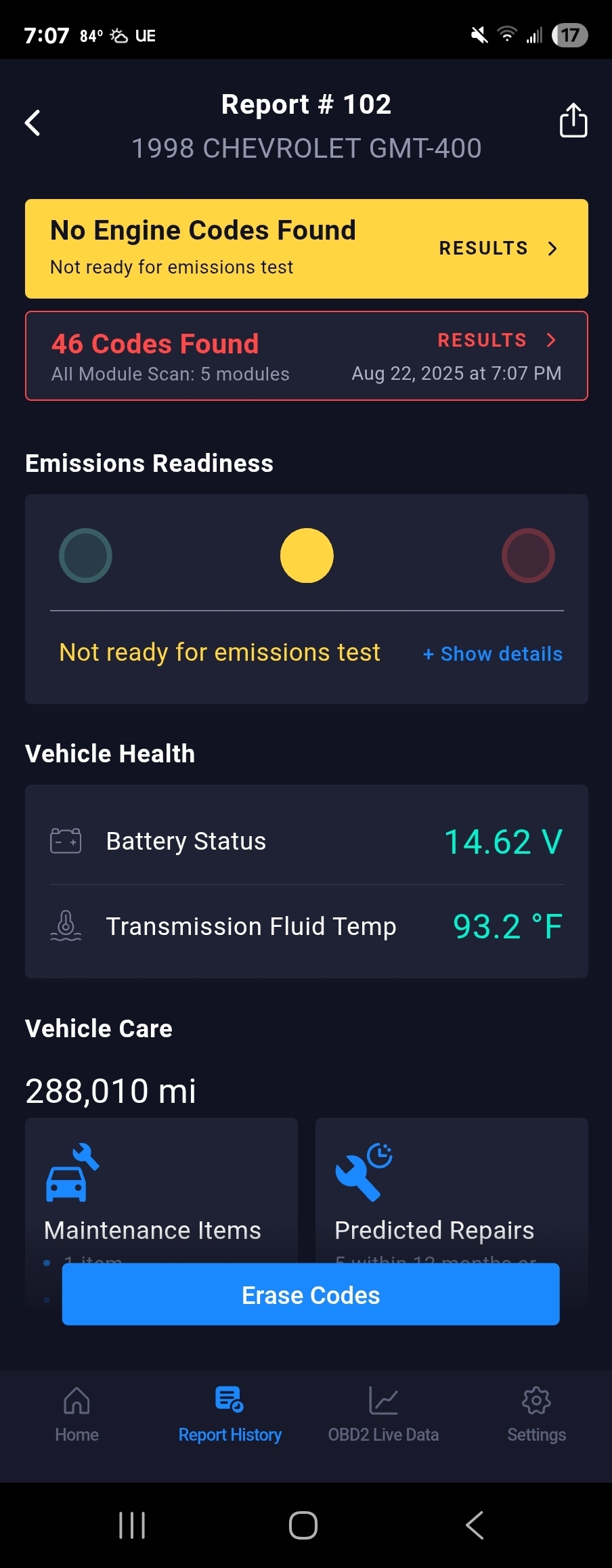

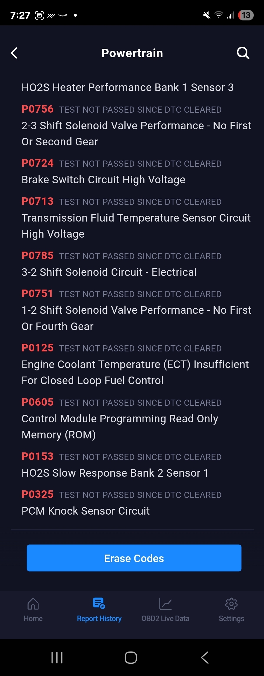

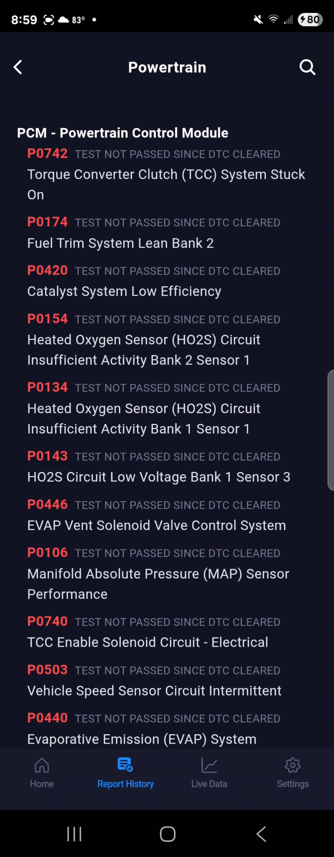

Okay, so after initially thinking there were no codes, this dongle code scanner is showing a lot of issues, and there's still no check engine light. There's power to the transmission, but I've never seen anything like this before. The vehicle doesn't have catalytic converters or O2 sensors (previous owner). What I can't understand is that it shifted with the incorrect transfer case, but only had trouble getting in and out of overdrive.. im guessing the trans was on its way out? or did something happen somewhere accidently? just bizzare. no vss action still while driving etc. i drove it around the yard, and took a short recording.i have came across broken wires etc and its almost like im chasing a ghost. rebuild/replace all harnesses? or junk the truck? haha
Aug 23, 2025 at 2:22 AM
  • 55,433 POSTS

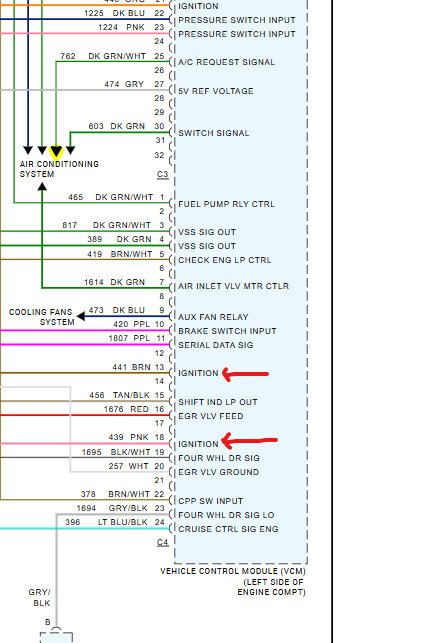

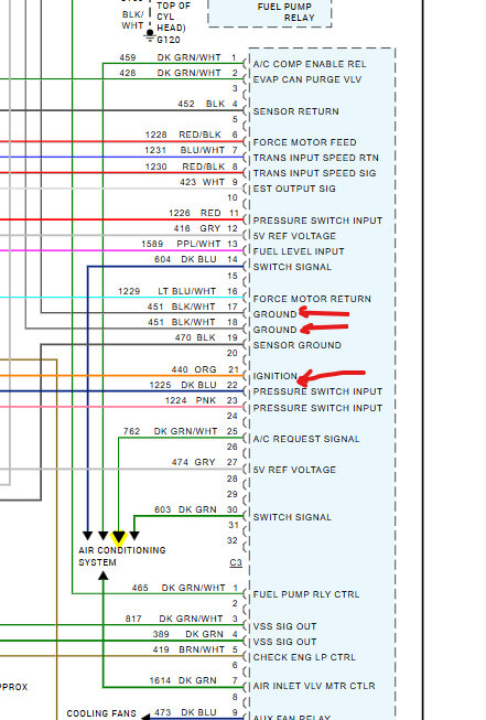

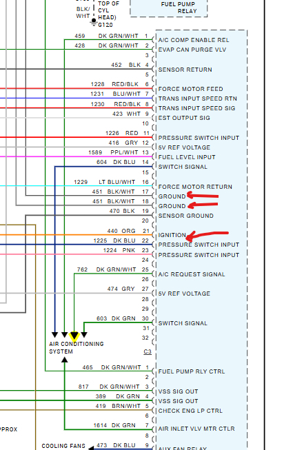

Wow, you are not kidding, it looks like many codes, like the PCM has a bad ground or the vehicle needs a rebuild PCM, this can be your problem. To recap, you have checked the wiring to the PCM, replaced the sensor and the speedometer still does not work and the PCM cannot see the vehicle speed correct? if so I would check the PCM grounds and power inputs and fi they are okay swap out the PCM. Here is a guide to help and the PCM connections so you can test them.
Aug 23, 2025 at 5:02 AM
ROBBERGERON55
  • 17 POSTS
so far, the c3 (white/ clear connector) pins 17 and 18 aren't showing anything. the rest check out good. the pink wire in c1 pin 4, doesn't even exist. which i did notice on the schematic i have, which is normal. you may have shared a schematic to a different year. we are definitely on the right track now lol.. i did a little further investigating myself, ground circuit 451 (c3 pin 17,18) goes to g103 and g104. 104 i have cleaned and reattached 2 weeks ago. which became a handy ground location while doing these latest tests. the 103 on top shows good to the battery, i also noticed the MAF sensor ground/ signal and the ignition control module gets to the vcm on that same harness, so ill check the sensors out. could a MAF or ICM cause all these codes and showing no ground? ill report back shortly. if anything else comes to mind on those 2 c3 vcm grounds, let me know! thank you

What codes are you getting?
Aug 25, 2025 at 2:28 AM
ROBBERGERON55
  • 17 POSTS
all the same ones, pop right back up
Aug 25, 2025 at 4:17 AM
ROBBERGERON55
  • 17 POSTS
they're in the video i sent yesterday. if i clear them, they come right back on the scanner not a minute later.. no check engine light on the dash, but they are showing on the module scans..

That is a lot of codes, its like the PCM is bad, I would try to get a replacement and see what happens, you can also send the old PCM in for testing.
Aug 25, 2025 at 6:35 AM
ROBBERGERON55
  • 17 POSTS
I did mention in the beginning, that I tried that, relearned it, kept the same eprom etc. Same results :/.... im wondering if a different year harness with a different pinout may be a possibility? What about the pin 17, 18 grounds you had me check?

you had me test the pins 17 and 18 (vcm grounds) on c3? i did. not showing anything
