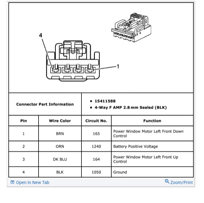

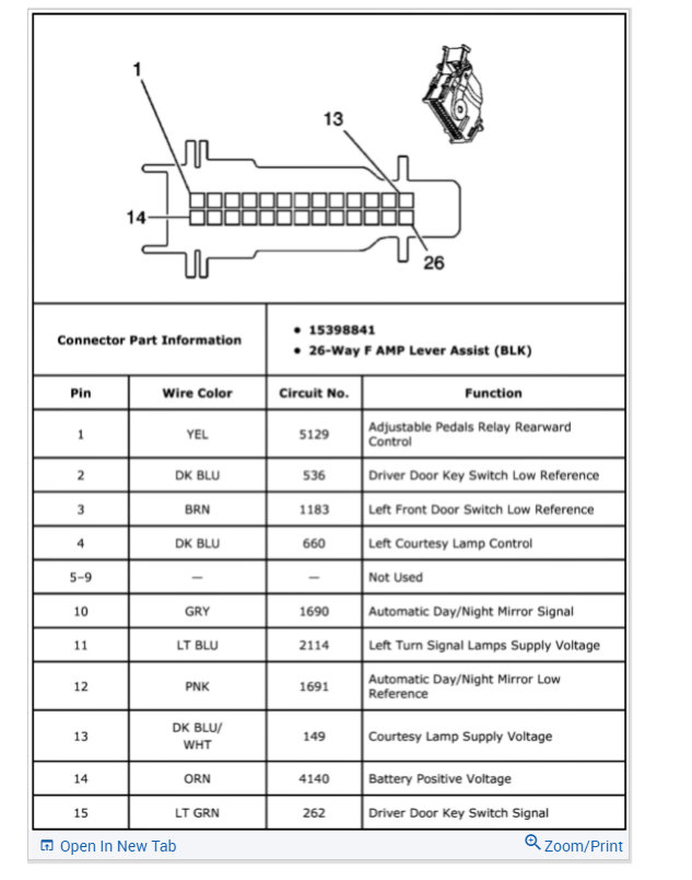

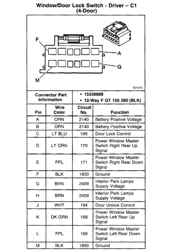

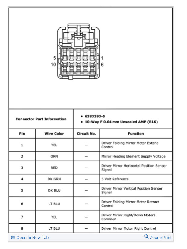

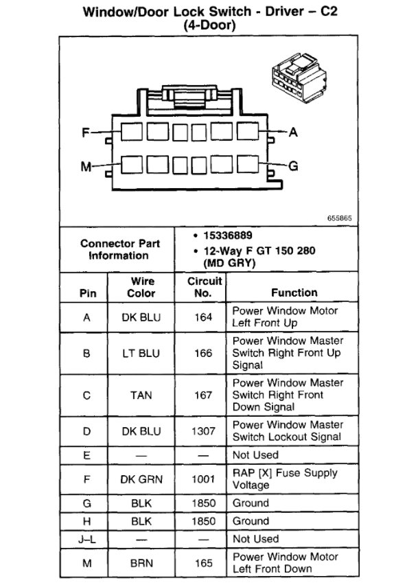

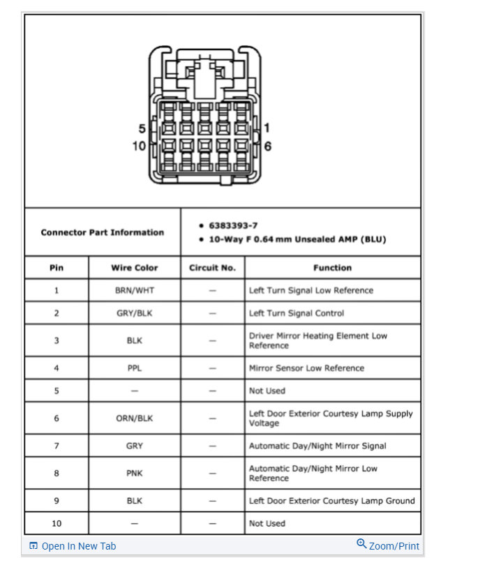

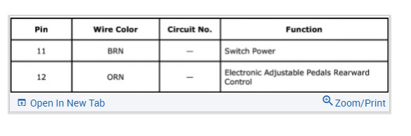

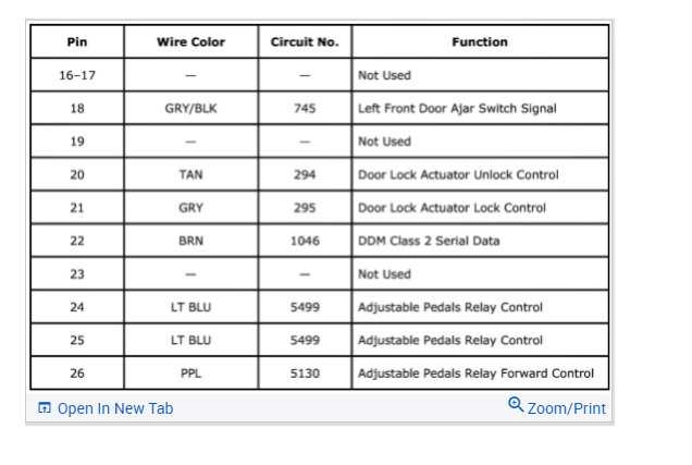

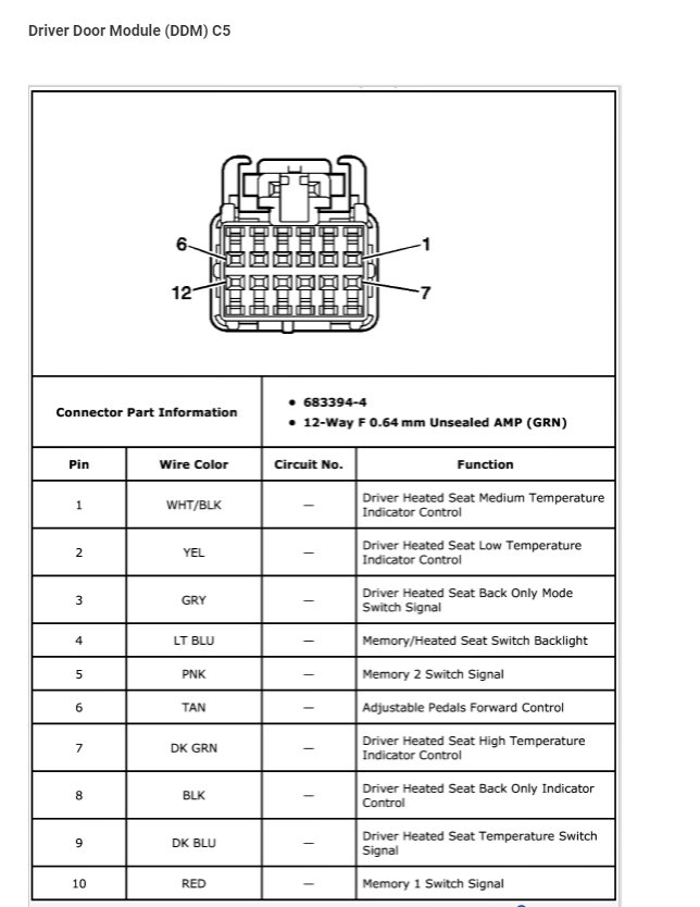

Trying to swap my vehicle listed above power window cluster to a 2003, but they use different connectors and different wire colors. Is there a diagram available for which colors swap and to where?
Dec 14, 2021 at 6:11 PM
Good morning,
The 2001 was a simple system setup.
The 2003 is different. There is a door driver module, and the body control module is part of the system.
I attached the connectors with locations and wire colors for you to view.
