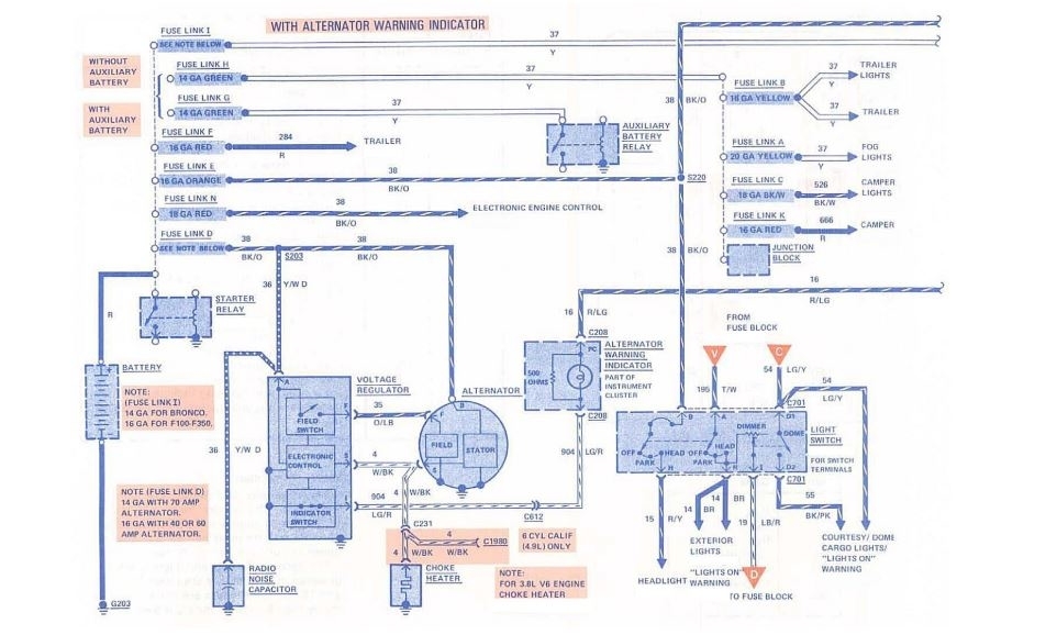

The alternator is not charging even with a new alternator. The old one was wired with the feed from the battery terminal going to the ignition module through the hot wire from the battery to the ignition module. The field wire terminal was wired to the a port on the regulator and had a second wire going nowhere but had a plug on it that appeared to go to the carburetor. The ground prong on the alternator was not grounded and the starter terminal was not connected. Needless to say i didn't make it far before my battery was dead.
Mar 21, 2019 at 10:16 AM

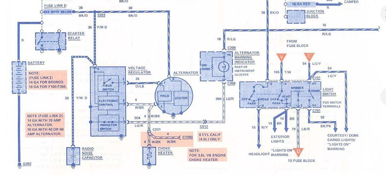

Good evening,
I attached a wiring diagram for you to view with the wiring required for the alternator to work.
Mar 21, 2019 at 10:32 AM
KENNY F150
Thanks, but i also need the wiring diagram for the solenoid. I did not see it in the diagram. Two of the wires from the alternator with fusible links were also attached to the battery hot side of this unit and i presume the hot feed from the alternator should go straight to the battery.
Mar 21, 2019 at 10:39 AM

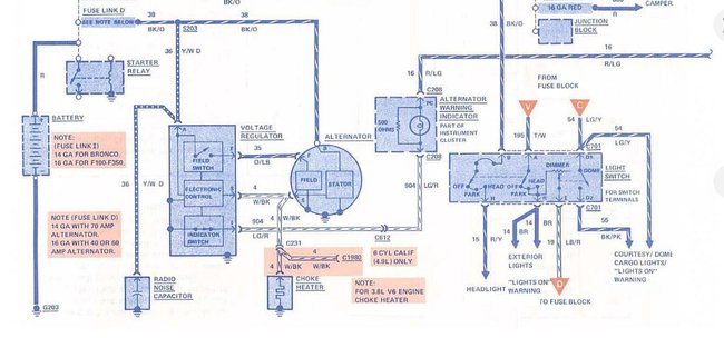

Try this.
Mar 21, 2019 at 10:44 AM
KENNY F150
Thank you so much! That is what i have spent most of the day looking for and my battery is now charging back up from 5.5 volts to 11.8 volts. I'll check the alternator when it gets high enough to crank the truck to see if it is charging while running. I can't thank you enough. I am sure I will have more questions in the future.
