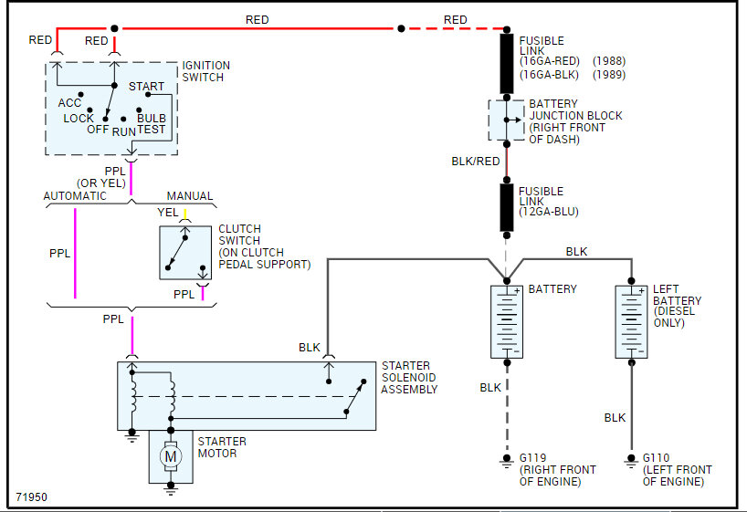

I'm not completely sure I understand what is happening. When you say it only clicks when it is installed, are you sure the engine isn't locked? Also, are all battery connections clean and tight? Is the ground from the battery to the engine block in good shape and tight?
I attached the wiring schematic below, so you have it as a reference. Take a look at it and let me know if it helps.
See pic below.

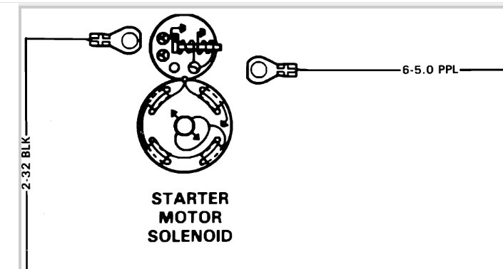

The purple wire goes to S terminal on the starter solenoid. The large power wire from the battery goes to the large post on the starter solenoid. You indicated a red wire and I'm not seeing it on the schematic.
I need you to confirm something for me. In the heading, you indicated the model year as a 1989. In the last post, you asked about an 88. Let me know which one you are working with. I don't want to get you the wrong information.
I attached a pic from the manufacturer showing a black wire (heavier gauge from battery) and a purple wire (lighter gauge/trigger wire). This purple wire will not have power to it until the key is in the start position.

According to the manual, there should be a purple (smaller gauge wire) to the S post and a heavy gauge black wire to the larger post on the starter.

So, the small purple wire is the ignition/switch wire? And it goes to the S terminal? And the thick positive battery terminal goes to the biggest post on the starter solenoid?

What you described is correct. The purple is the trigger wire that engages the starter motor when you turn the key. The heavy gauge black wire is what powers the electric motor once the starter engages.
