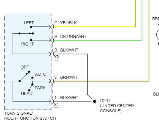

I need the turn signal lever four wires red orange yellow brown placement on 1-4 spots on the lever.

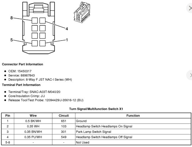

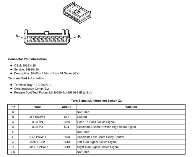

I have attached the pin out for the turn signal harness below.
It shows the position and the wire colors.

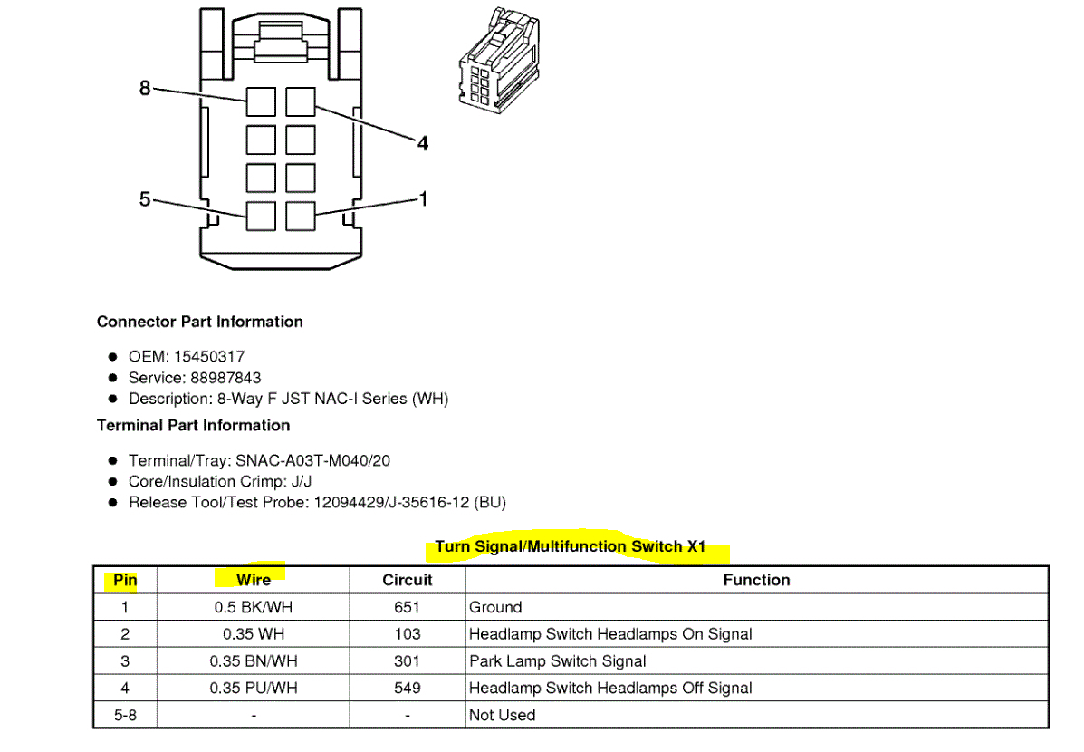

Is this an 8-pin connector? If it is, the colors you mentioned are not listed. Pin 1 should be black with a white tracer. Pin 4 shows purple with a white tracer. Pins 2 and 3 must go to a different component. However, I want to be sure I have the correct connector before I start digging through wiring schematics.
Take a look at the pic below and let me know if that is correct and if you see the colors listed.
See pic below.

Okay, I need to know what color wire goes to which number 1 through 4 and it has colors brown, red orange yellow.
Oct 16, 2022 at 7:16 AM
  • 110,244 POSTS
The colors you have don't match what I have. See pic 1. The only thing I can think of is if the vehicle has an early or late production date. So, I checked 2008 and 2010 vehicles and they are identical to what I have listed below.
This is still for the turn signal/multi-function switch, correct?
