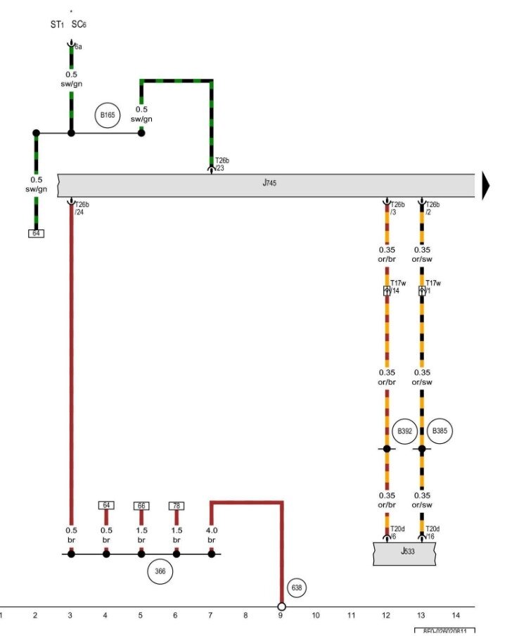

Wiring schematics for 14 pin Aokus Xenon headlight needed?
130,000 MILES • 2.0L • 4 CYL • TURBO • 4WD • AUTOMATIC
AD1984

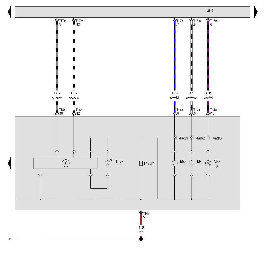

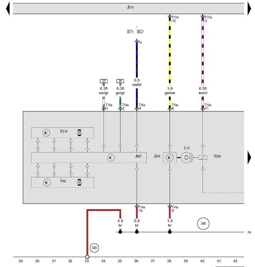

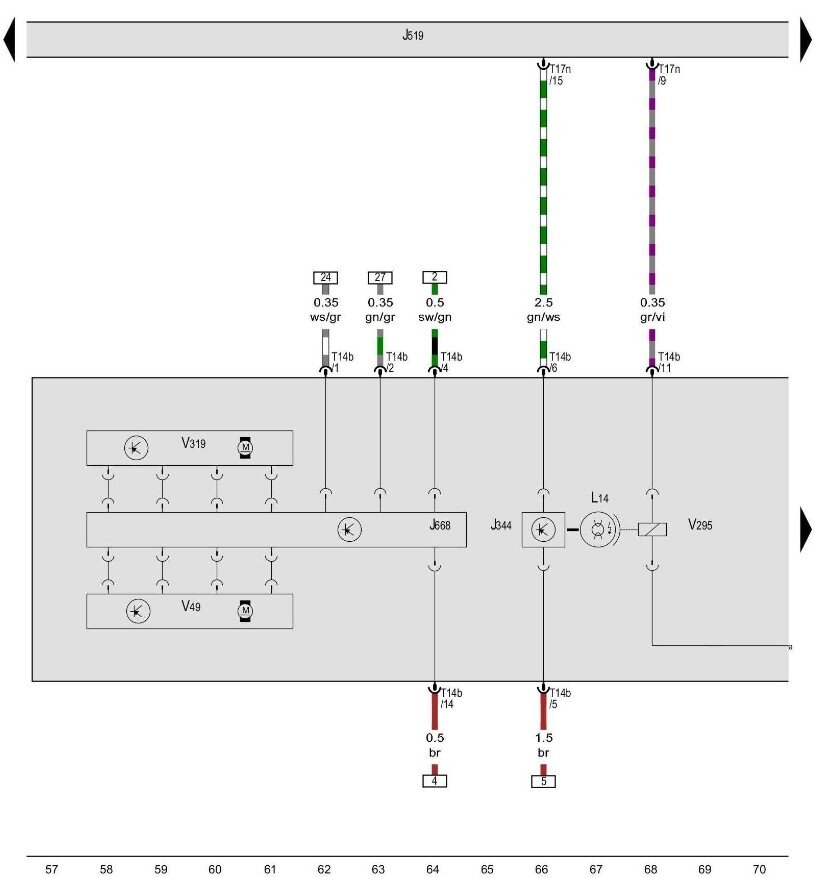

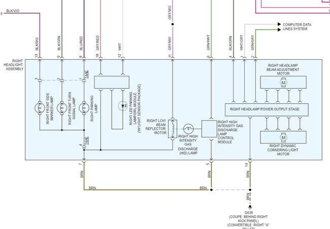

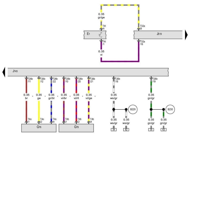

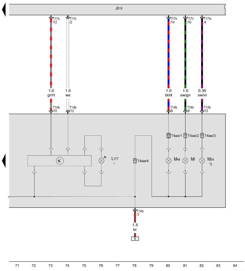

I had 5 wires pulled out of my headlight connector on the passenger side.
Dec 7, 2022 at 4:54 PM
STEVE W.
  • 15,367 POSTS

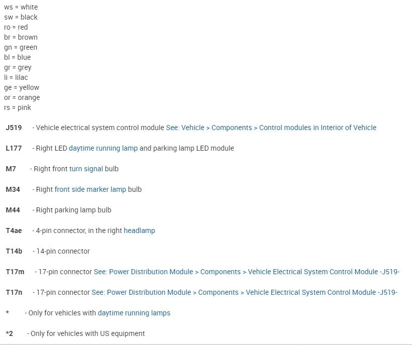

These are the diagrams for the light modules. The first one is just the right-hand lamp module. The other 7 are the OE wiring diagram and the key for the symbols and colors. If the wires pulled free with the contact pins be sure to bend the retainer tangs out so they clip in when you put them back.
