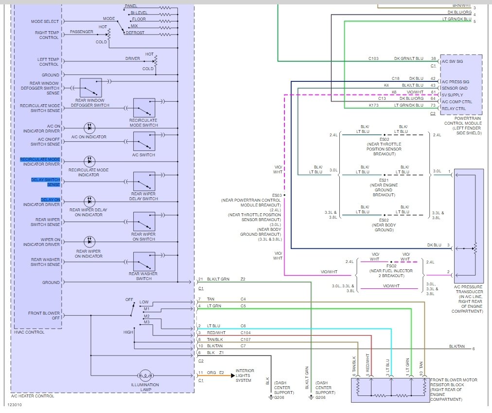

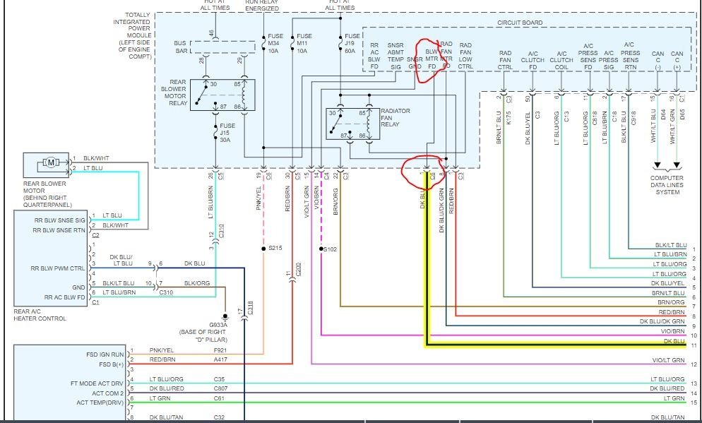

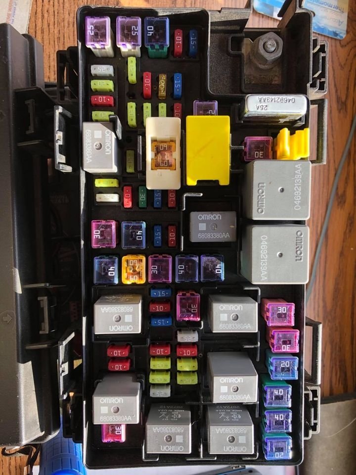

The wiring schematics in the Haynes manual don't reflect my van listed above. I have a front blower problem and have traced all the wires to no avail. In the Haynes it says the circuit goes to the TIPM's circuit board but mine goes to a relay. I have successfully ran a fused ignition feed to the blower motor control module to get everything to work correctly. But I can't figure out the relay feed back from the blower control module. A schematic for the whole car would be appreciated because I purchased a factory manual on line but it only goes to 2011 not to 2014 as advertised and the wiring schematic doesn't work for my van too.
My van is listed above with the digital heating system with right and left and rear HVAC.
Thank you again, David W
Oct 28, 2020 at 7:05 PM

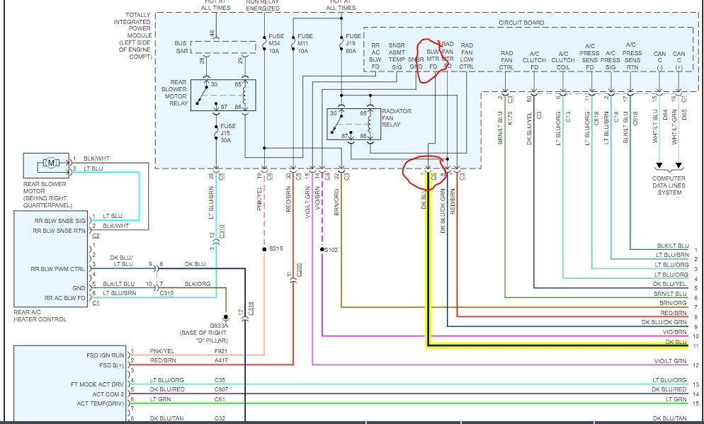

Good morning,

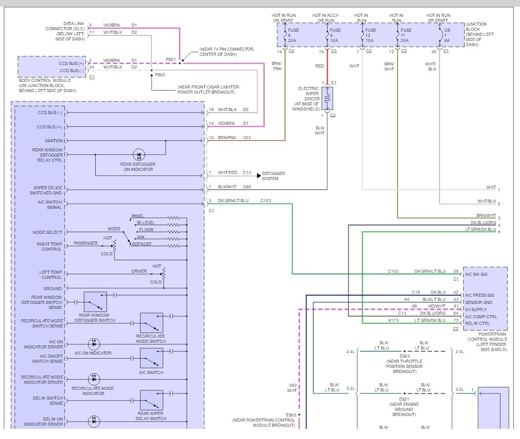

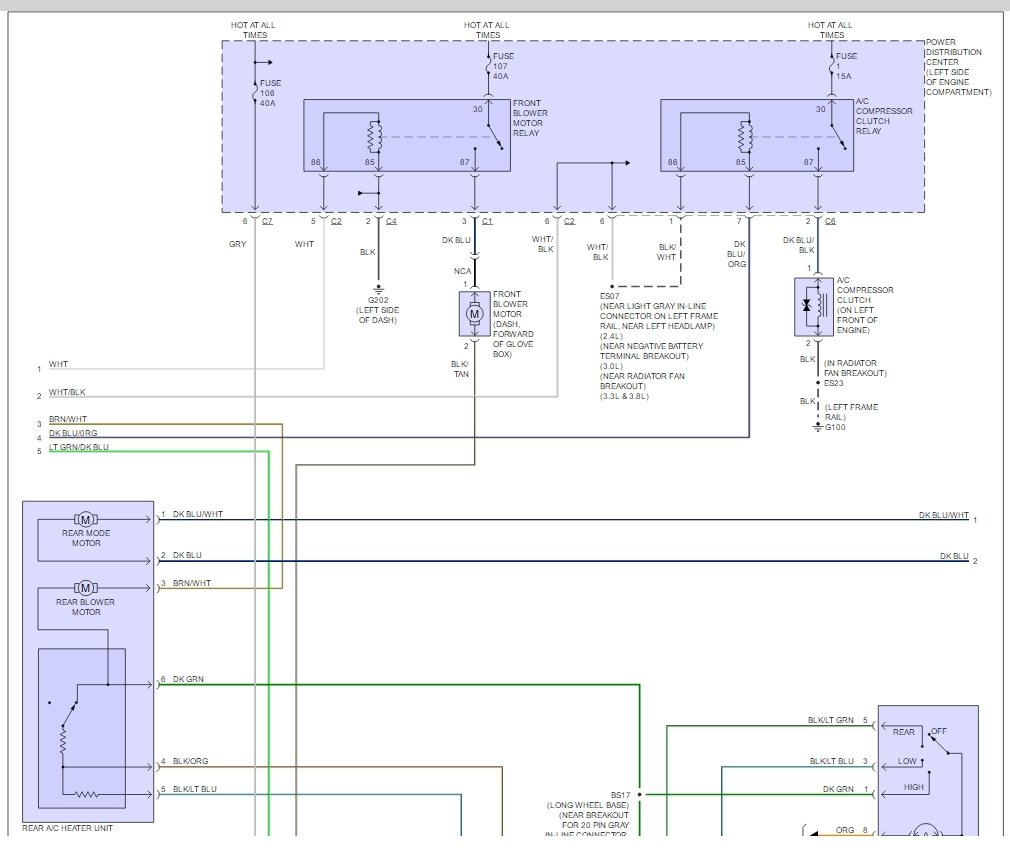

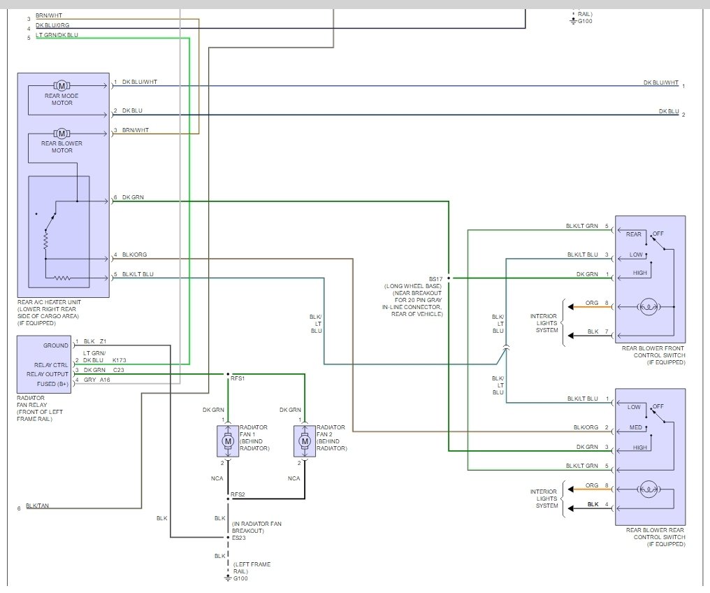

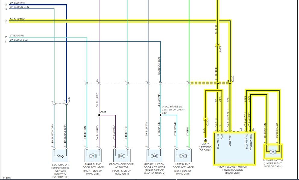

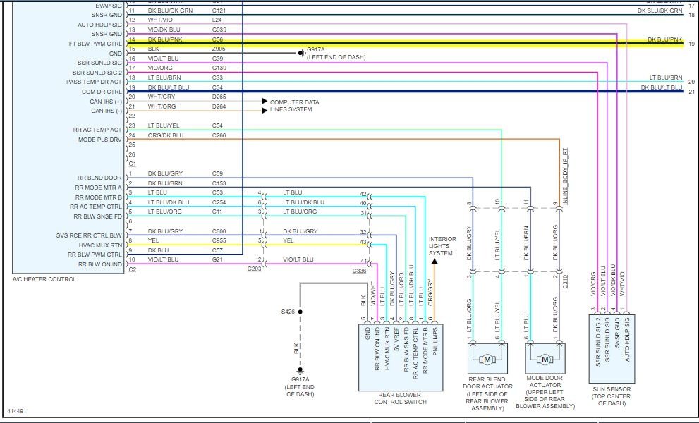

The relay is for the rear blower, not the front blower motor.
I attached the wiring diagram for you to view. The front blower module is powered by the dark blue wire from the TIPM. You need to verify power is to the module from the module.
If there is, then the module is bad. If there is not, then the TIPM is the issue.

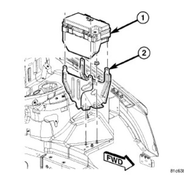

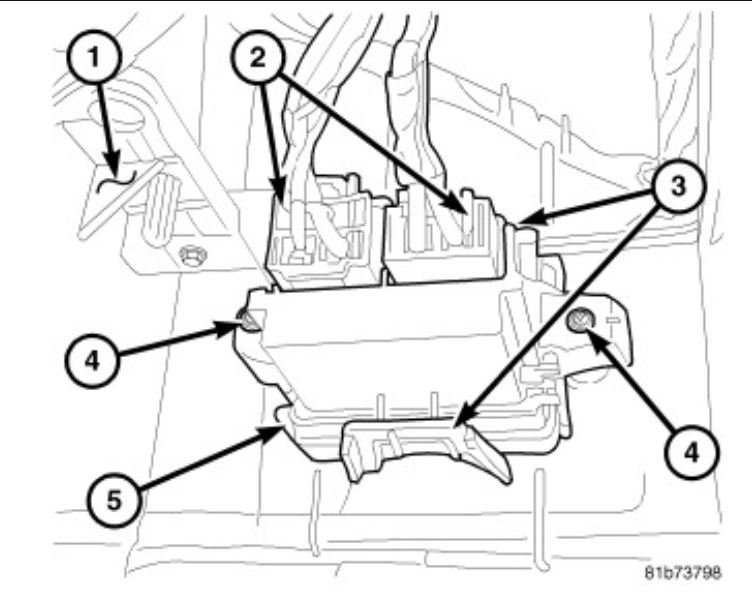

Open hood.
Disconnect and isolate the battery negative cable.
Release the Totally Integrated Power Module (TIPM) cover retaining clips and open the TIPM cover.
Remove the TIPM positive cable retaining nut and remove the cable from the stud.
Depress the four mounting clips to disengage and remove the TIPM housing from its mounting bracket.
Disconnect the wire harness connectors.
Remove the TIPM from the vehicle.

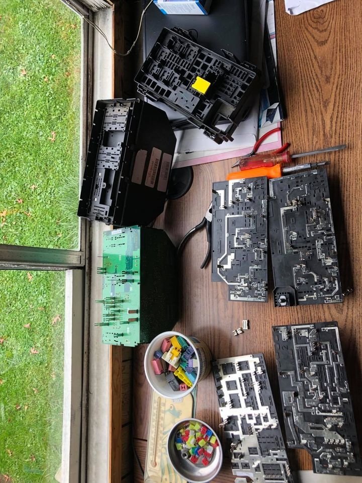

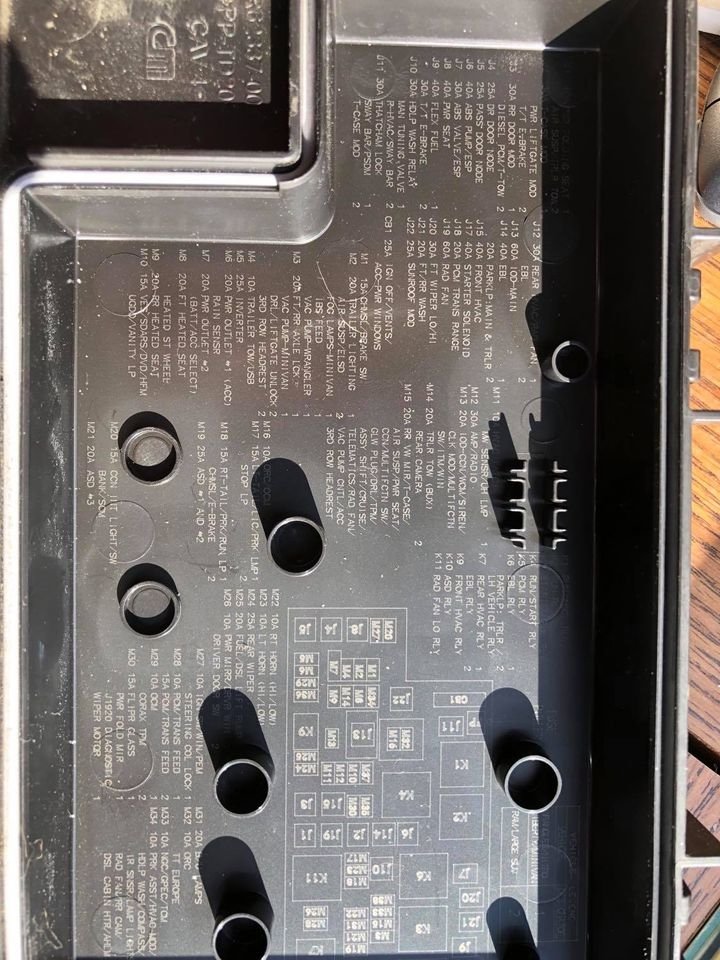

Howdy Roy, where to begin. That is the same wiring schematic that I have but it doesn't seem to be correct for my digital HVAC system. Last thing first, I have ran a fused jumper wire in the TIPM from a fused ignition feed to the dark blue wire feeding the blower resister module and everything works correctly but not with the relay in place. The relay was replaced with 2 known working relays but did not fix my problem.. I actually took the TIPM out and tore it down plate by plate looking for corrosion (scary) but did not see a problem still. I scanned the HVAC system and it told me all the switches in the dash were working correctly, my scanner will actually activate the heater controls one by one to see them working. So i took the heater controls out and traced the wiring there too, they were okay also. The relay in the TIPM if removed has no effect on the operation for the rear HVAC. That relay ( K9 ) is between fuse M36, M13 and M25 in the TIPM it also is where I jumped the dark blue wire from the blower resister control module in the TIPM to a good fused ignition feed. The relay socket has a good ignition feed on 2 legs a good HVAC system (dark blue wire) system going out of it but I don't know where the other 2 wires going out of the relay go to. I have been looking at different schematics for different years hoping for a correct schematic, none of them show a relay feed going to the dark blue wire going the my HVAC system! Right now my system is working correctly but not the way it was built :( . Sorry for being so long with details but it is driving me crazy, lol. As you can see my van in spot K9 actually has a relay for the front HVAC relay so I don't know why I can't find a schematic for this van.
Thank you again frustrated, David W
Oct 29, 2020 at 4:31 AM
Got it.
From all your testing, I still think you need the TIPM.
Oct 29, 2020 at 4:57 AM

Alldata and Mitchel have the same diagrams I sent you.
You could go to the dealer and ask them for one.

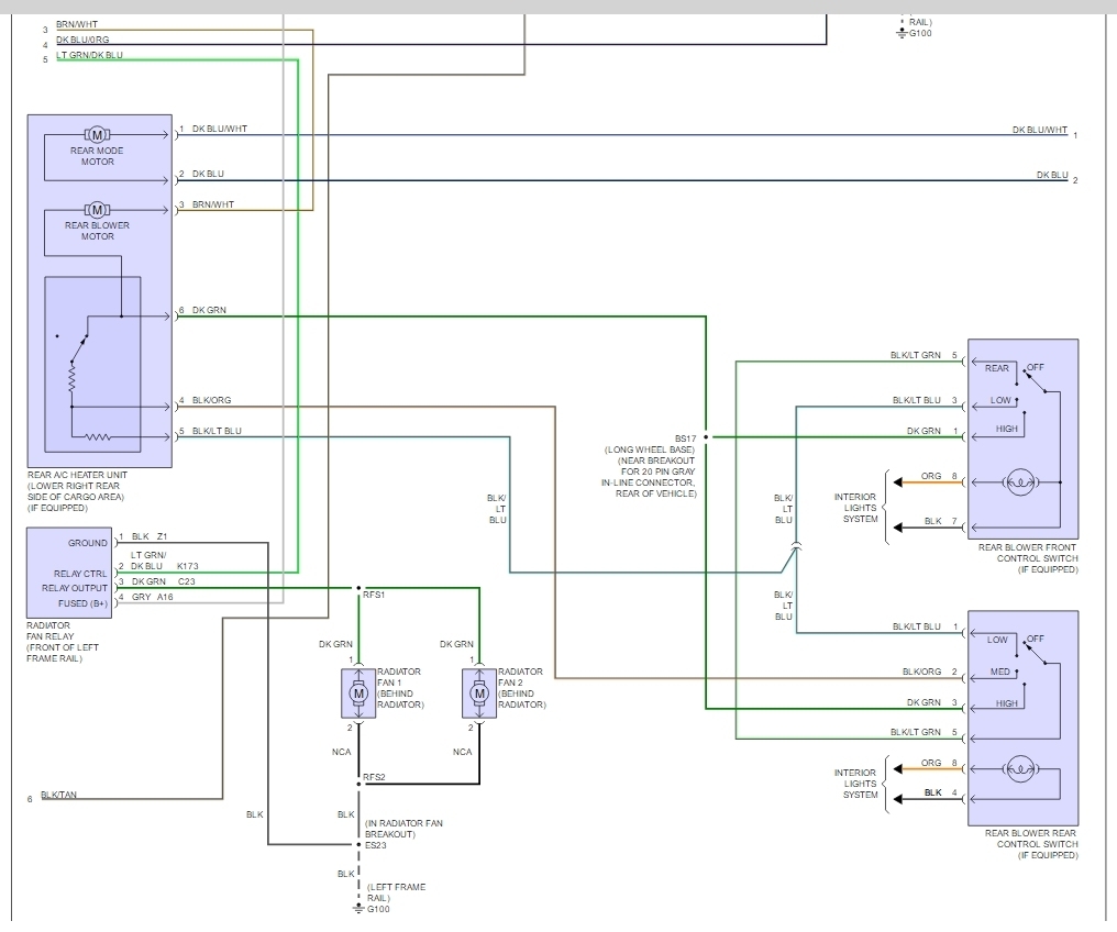

VMOLMEN
Blower motor will not run. Replace the resistor, heater switch test/replaced.
Feb 27, 2021 at 2:29 AM (Merged)
  • 55,423 POSTS
Hey VMOLMEN,
I have found these wiring diagrams for you to help with the testing. Check the blower fan first then use these guides to continue testing.
https://www.2carpros.com/articles/blower-fan-motor-works-on-high-speed-only
