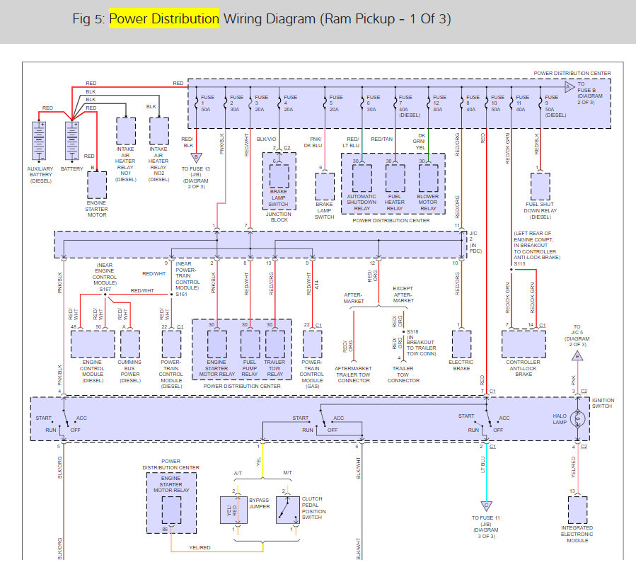

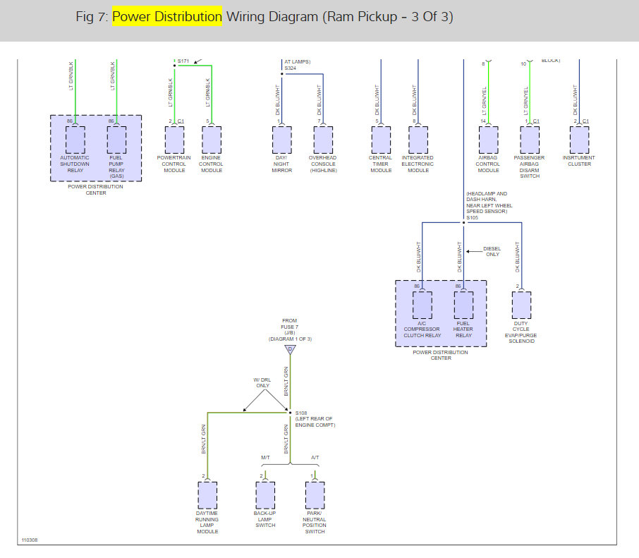

I am trying to locate a detailed diagram that identifies the colored wires that lead into the power distribution center Engine Inline connector. Can you help?

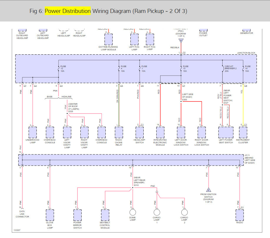

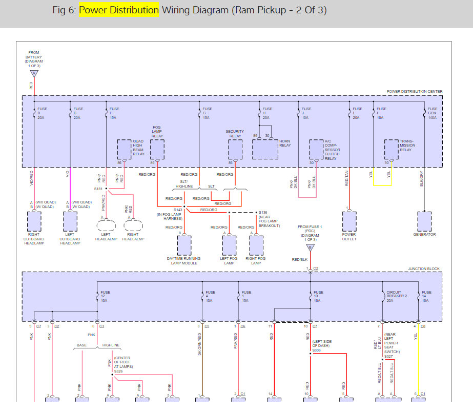

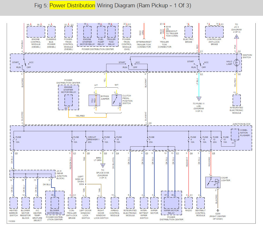

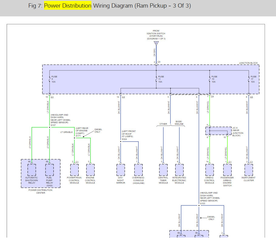

I have attached the entire power distribution system schematics. There are a total of three, but I had to cut each in half because of size. Therefore, you will see a total of six pictures. They are in order. All odd number pictures, 1, 3, 5 are the tops of the schematics and even numbers, 2, 4, 6 are the bottoms. I overlapped the schematics so you can see how they fit together.
Pics 1 and 2 = schematic 1
Pics 3 and 4 = schematic 2
Pics 5 and 6 = schematic 3
They do not list wiring in that way, by system only. If there are many systems leading to the PDC you will need the pertaining diagrams. Here is what they give us which is what Joe found. I hope these are easier to read. Cheers, Ken

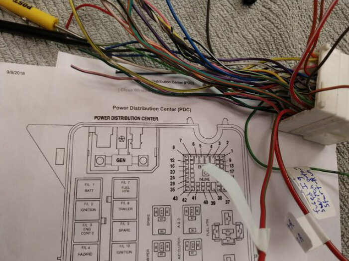

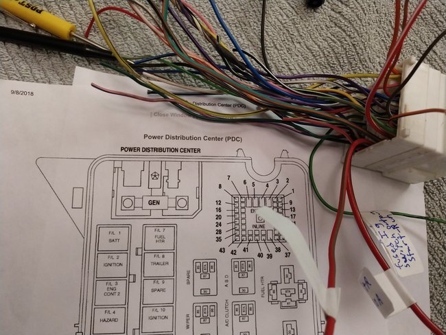

Thanks, not quite what I was looking for. I have the white plastic connector with wires coming out of the back of it. It is the Engine Inline Connector that plugs into the PDC fuse block with one screw.
The 43 wires are coming out of it, and I wanted a list of what the wires go to via color or number code. I will attach a photo.

They don't give us diagrams like that, these go to many systems I can give individual systems no problem. Let me know the systems you need.
