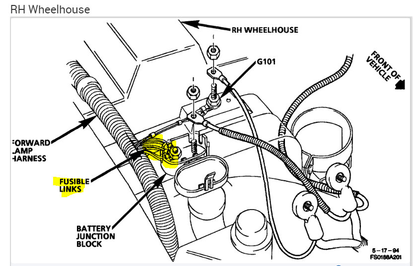

I not getting power to most of the fuses to the fuse box under the hood #1, #2, #9, #10, #11, and #12 not getting power. The driver's window don't go down and sometimes when I try to start the car I turn the key and I have nothing it got brand new battery in it so can't be that. Thank you in advance for any help.

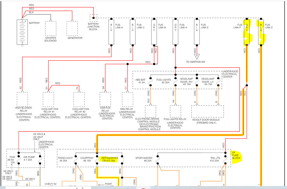

I'm looking through the wiring schematics and the fuses you mentioned all get power from fusible link K.
I attached a pic of the link locations below. Check to make sure none are damaged. Check for power at both ends of the links to see if one has failed. Note: There will be a total of three gray links. One of them is link K. It isn't shown in the manual which one. There also will be four black ones. They are not of concern.
Let me know what you find.

Yes, those will go to the box. A fusible link works just like a fuse but is in wire form. It is designed to melt (disconnect) if the amperage exceeds its limits.
Were you able to check both ends? If you want, disconnect the battery and follow the wires. Using a multimeter, check if there is continuity in the fusible links from one end to the other.
Let me know. Also, I do feel this is the source of the problem. However, I've been wrong before. LOL

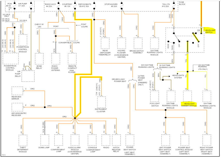

Now, the crank fuse should only have power when the key is in the start position. Power comes from the ignition switch. I'm saying that because you may not have checked it for power when the key was in the start position. See pic below.
The dimmer switch for the IP is powered by the headlamp switch. If the headlamps work, chances are the switch itself is faulty. There is a built-in circuit breaker for the IP dimmer/lighting. It may have failed. See pic below
Let me know. Also, do the other fuses you mentioned before now have power? Also, have you scanned the computer to see if there are diagnostic trouble codes stored? In your original post, you indicated a new battery and no response from the starter. Since it is running (rough), I suspect the starter is now working. Is that correct?
See pics below. Note: I had to cut the schematic in half to make it readable. I did overlap the two and highlighted wiring and fuses of interest.
