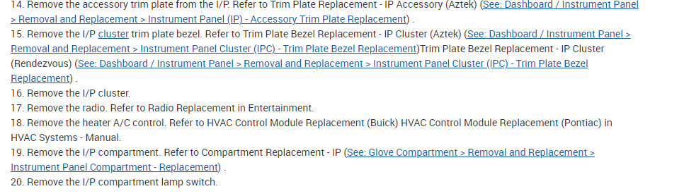

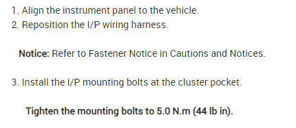

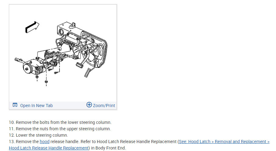

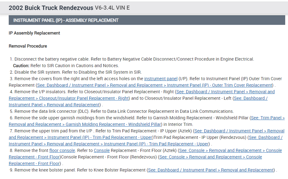

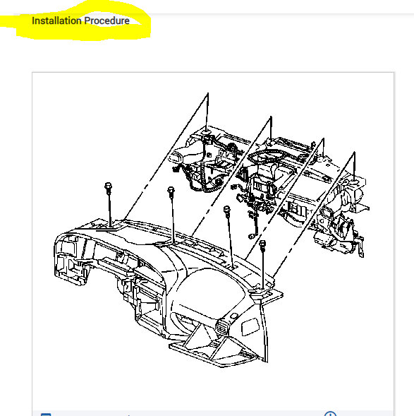

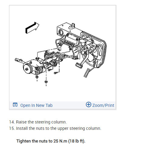

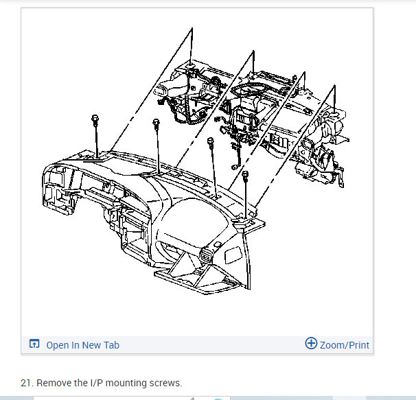

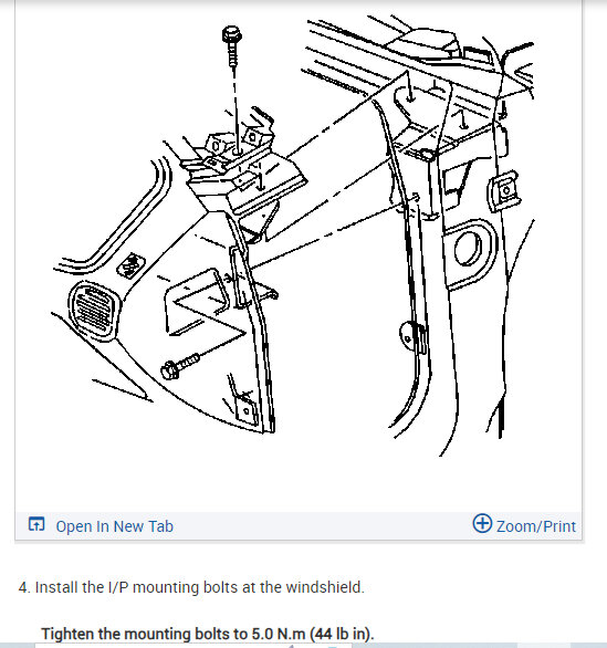

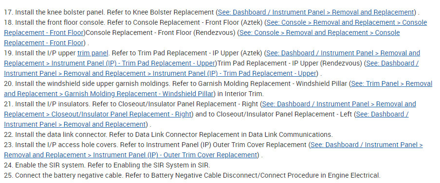

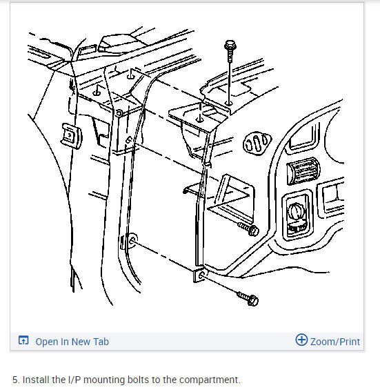

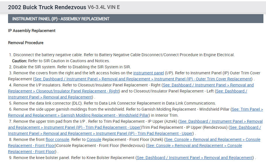

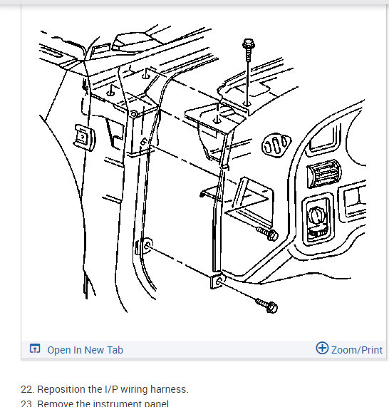

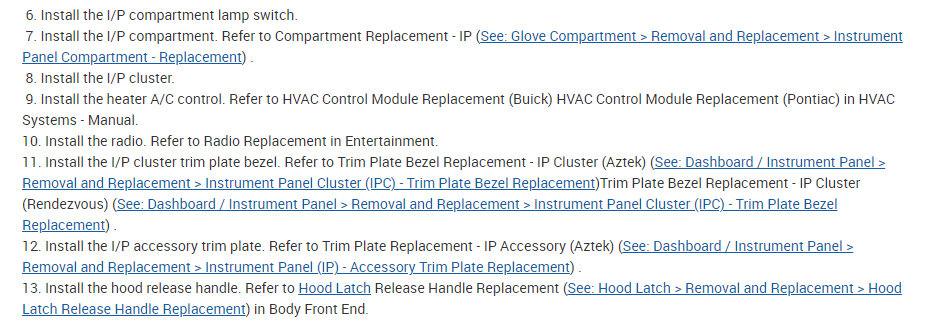

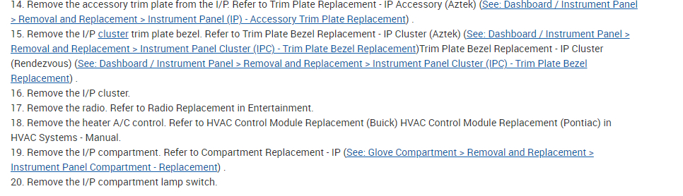

Removing the dash is a bigger job. However, it is doable. If you look below, I attached the directions for the removal and installation of the dashboard.
Take a look through the directions and let me know if you have questions.
