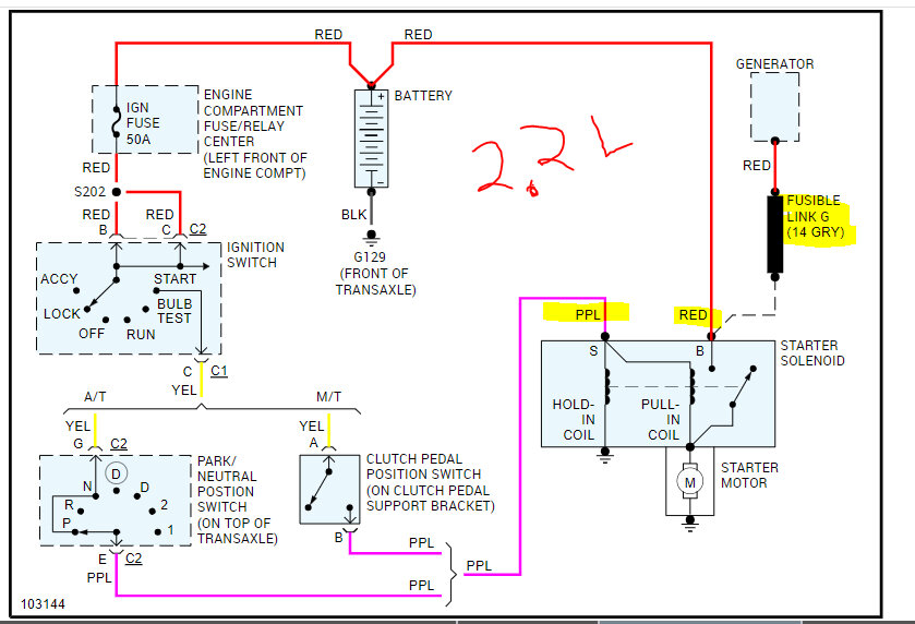

Where do the wires go on a new starter?
1998 CHEVROLET CAVALIER
141,000 MILES
NITA LANDERS
Wiring on a starter.
Aug 15, 2024 at 8:32 AM
  • 110,190 POSTS

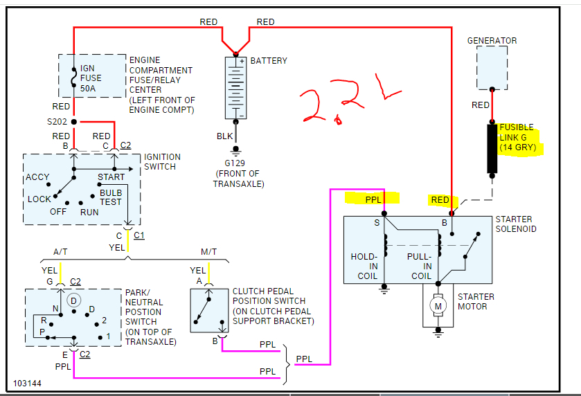

I attached the wiring schematic for the starter circuit. The schematic is for the 2.2L engine. If you have something different, let me know.
As far as the wiring is concerned, there is a larger lug on the starter that will have a heavy gauge red wire to it and another wire that goes to the alternator. There is also a smaller gauge lug where the smaller gauge purple wire goes.
Take a look at the schematic and let me know if it helps.
joe
See pic below.
