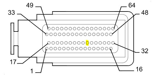

hey, i have the car listed above, TS model. my cam angle sensor yellow wire g got loose somehow i have a red, white and yellow wire where does the yellow wire go to?

The yellow wire should go in cavity three at the connector, see image below.
Pin 1, red wire.
Pin 2, white wire.
Pin 3, yellow wire.

Hey, thanks for your answer, but what i need is from the connector to where should the yellow wire go? It's connected on the connector so I only need to know where it needs to go please, thank a lot.

The yellow wire will go to the engine control unit at pin 26 of the 64 pin connector.
Please see image below, pin 26 marked with yellow dot.

Hey, I'm going to do it now. thanks a lot for all your help.
