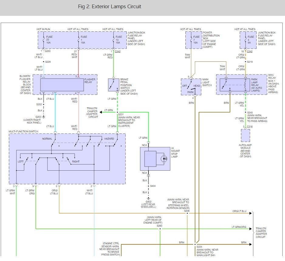

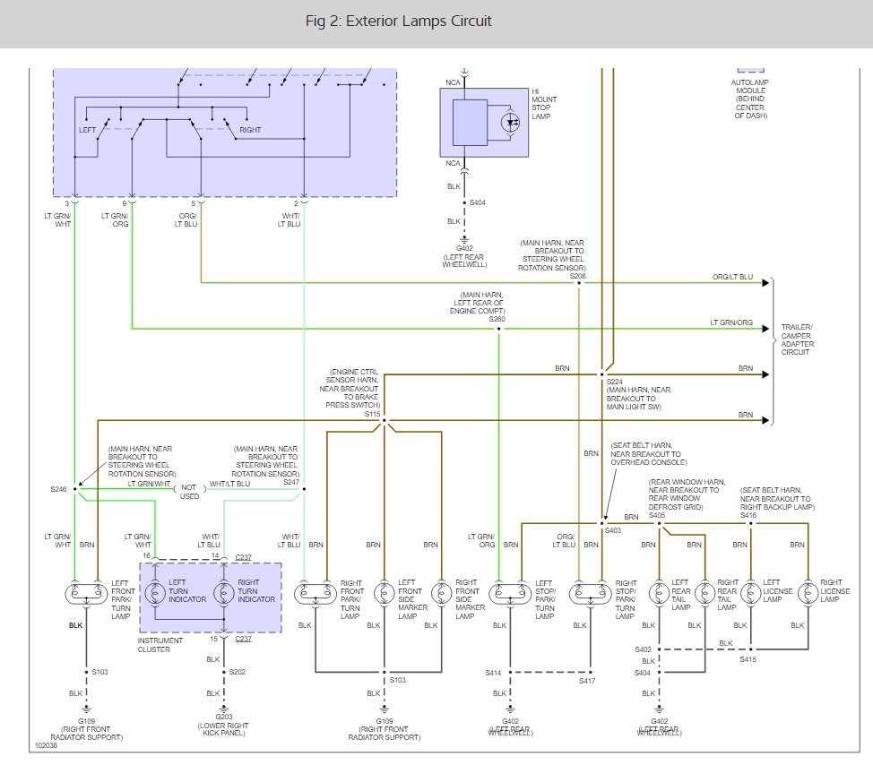

when i turn on my right turn signal every once in a while the hazard lights turn on then the taillights are fading and my right turn signal in my dash does not work. if anyone knows what this is please help!

Sounds like a bad ground in one of the lights, check this first.

It sounds like you have a wiring or bulb problem, here is some wiring diagrams (below) and some guides to help you do some testing so you can get the problem fixed.
https://www.2carpros.com/articles/no-tail-lights-exterior-running-lights-tail-lights-out
and
Please run some tests and get back to us so we can continue helping you.
