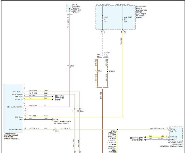

I need the wire location and description for power to the pcm to solve a p0882 code
Sep 5, 2025 at 5:03 PM
  • 55,433 POSTS
So this is a TCM power issue. I would start by checking the fuse# 94 - 10 amp an fuse# 57 - 20 amp in the fuse panel under the hood.
P0882 - TCM Power Input Signal Low
Test for power at the fuses as well, this guide will help.
Please go over this guide and get back to us.
Sep 6, 2025 at 9:48 AM
JONATHAN5929
I am a veteran mechanic. I need to know where the voltage supply wire is located for the TCM
Sep 8, 2025 at 1:19 AM
JONATHAN5929
All fuses and relays have been checked
Sep 8, 2025 at 1:20 AM
  • 55,433 POSTS

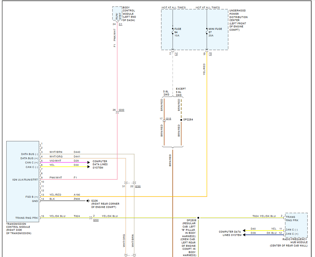

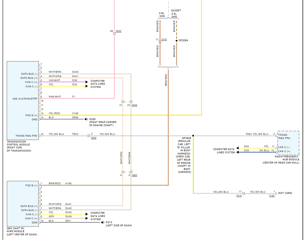

Okay, thanks for the clarification. Here are the wiring diagrams for the TCM which shows the power and ground wires to help confirm. Check out the images (below). Please let us know what happens.
