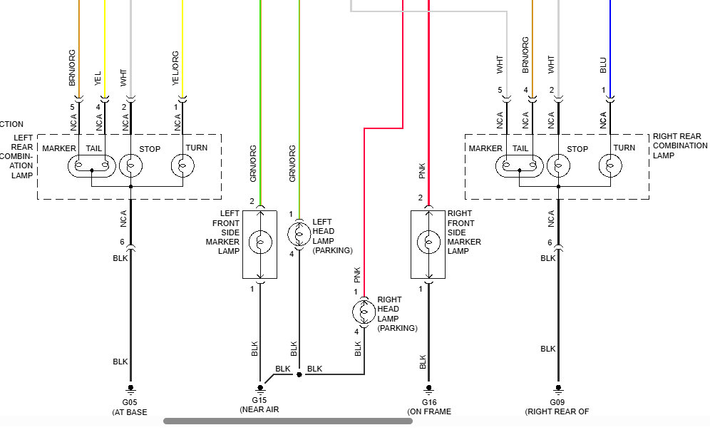

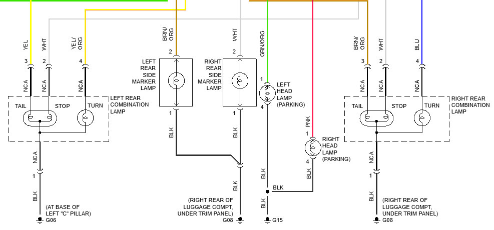

Wiring in trailer plug to car, can I splice into the rear taillights?
80,000 MILES • 2.0L • 4 CYL • 2WD • AUTOMATIC
ONDY
Can I splice into the rear taillights?
where can I get a color wiring diagram as I do not have a test light?
Mar 17, 2025 at 8:23 PM
BORIS K
  • 836 POSTS
You can splice into taillight wiring to connect a tow bar wiring kit
There are 2 different diagrams, one for 4 door and one for 5 door.
Please follow the manufacturer's instructions.
Image 1 below is for 4 door, image 2 is for 5 door.
