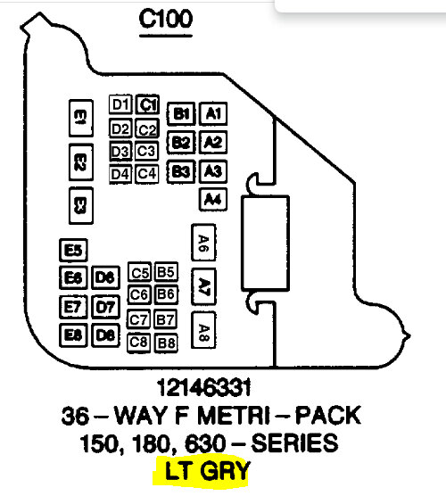

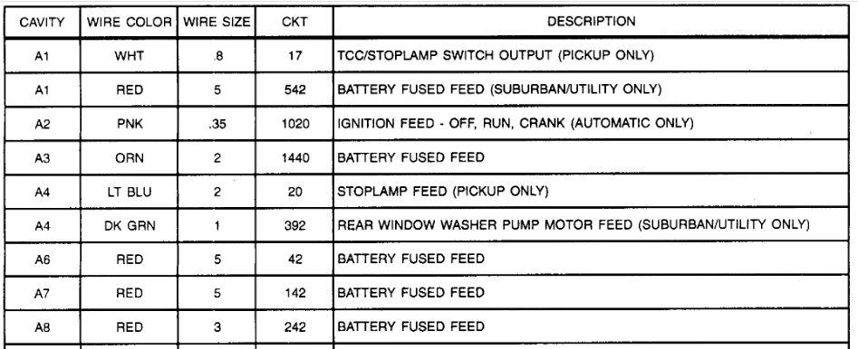

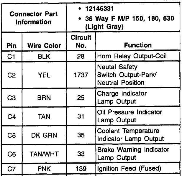

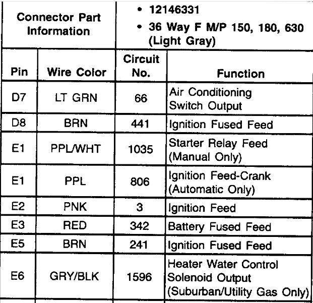

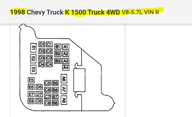

I need a firewall plug diagram for a 1997 k1500.
Feb 23, 2024 at 5:46 AM
  • 110,244 POSTS

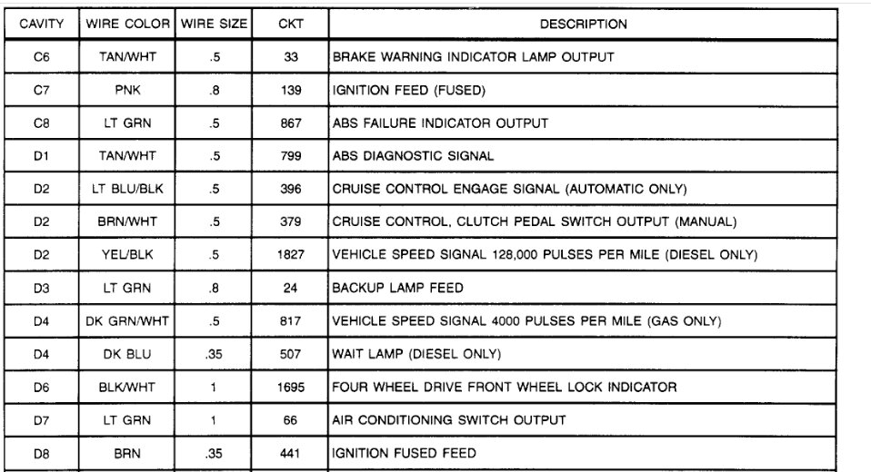

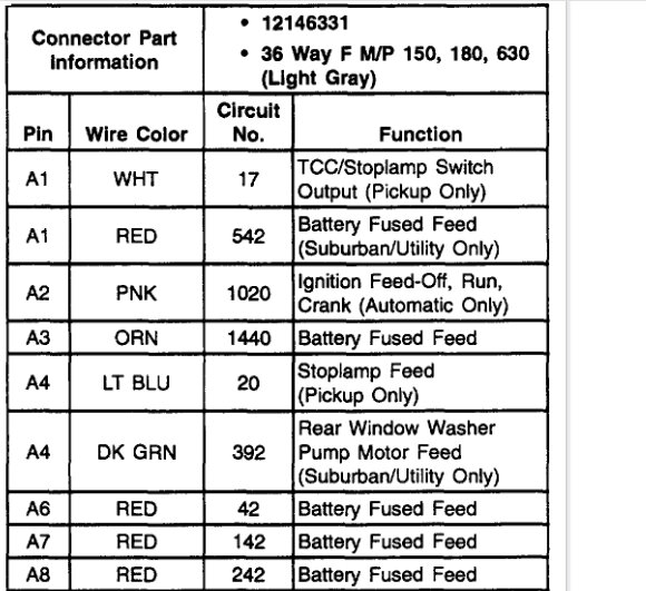

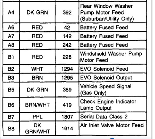

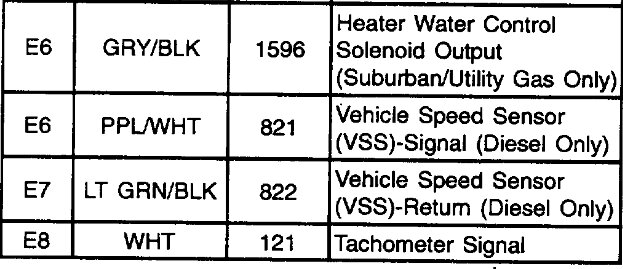

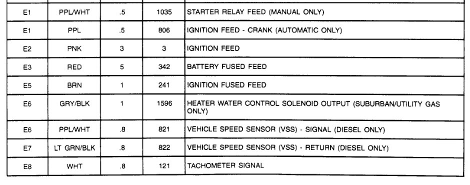

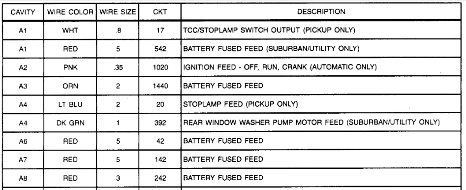

I believe I have the correct one for you. It should be a light gray, 36 pin connector. If that is incorrect, let me know.
If you look below, pic 1 is the connector. The remaining pictures indicate the function of each of the connector pins, wire color, wire gauge, and so on.
Take a look through this and let me know if this is what you need.

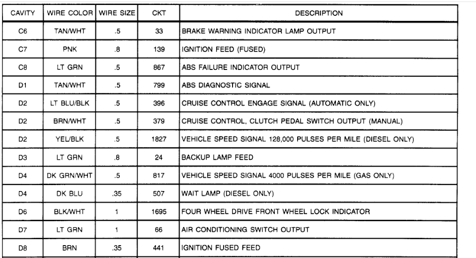

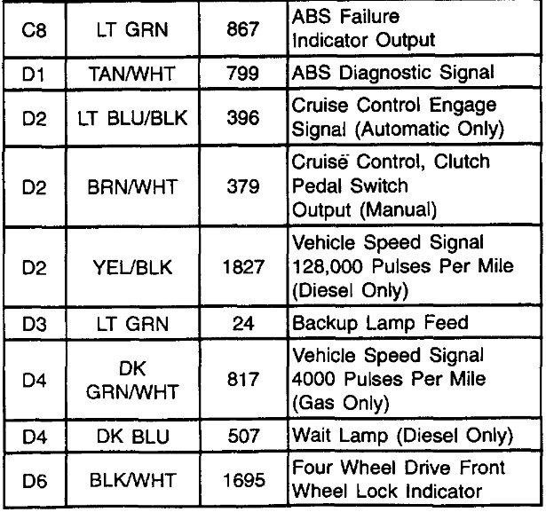

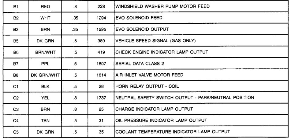

Yes, I think that’s right but by any chance is that a difference in that plug and a 1998 k1500 with a 5.7? If so, I need a pinout for that too.
Feb 24, 2024 at 11:58 PM
  • 110,244 POSTS

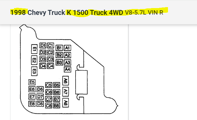

They appear very similar, but there are a few differences. What I recommend is to print out the information I provided and do a side by side comparison.
If you look below, I attached the info for a 98 with the 5.7L.
Let me know if this helps.

I double-checked and that is the only one for a 98. I suspect there may be connector wires that may or may not be used based on options.
