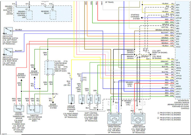

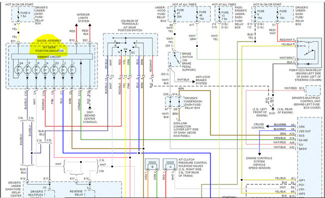

I had to add the extra components to the harness and repin a few of the connectors adding pins at the PCM as well. However it seems I'm still experiencing a few issues. All the gears engage and are indicated but the D5 light is flashing even though the connector is fine the pins are fine and the solenoid is working.

If you look at the attached pics below, I provided the entire wiring schematic for the transmission circuit. In the first pic, I highlighted what I believe you are looking for.
Also, I had to cut the pic in half to make them more readable. I did overlap them so you could follow from one to the next.
