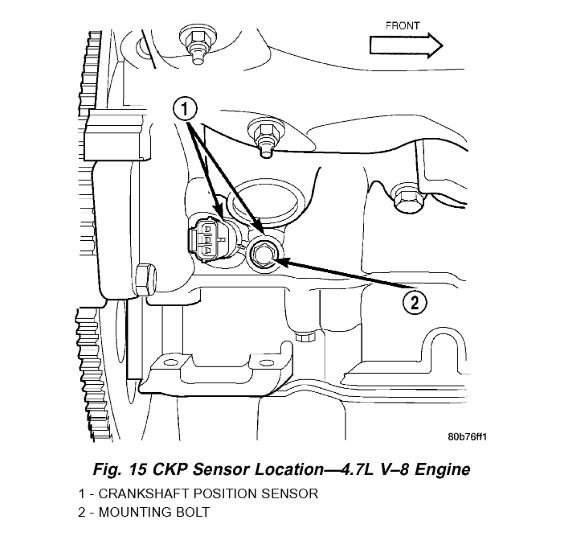

No, not at all. The sensor is at the back of the block by the transmission and the harness goes up but does not go through the bell housing.

Yes the solenoid itself in the wiring harness runs up where the number one is on that picture that you sent me.

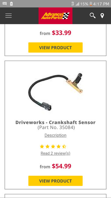

Oh sorry, it has been a long week with this truck. i meant the sensor. I'm trying to replace the wiring harness and I already replaced the sensor at the bottom of the motor just can't find the other end of the line.

It goes back to the PCM. There is no connector in the line.

This is the wire I was told runs from the sensor to somewhere.

That sensor connector just attaches to the connector that is on your sensor right now.

Yes, the picture you sent me is the crankshaft solenoid sensor correct. I have already replace that and I'm trying to replace the wiring harness. I need to know where the other end is located and how to get to it.

As I stated in my previous response, it goes back to the PCM. It is part of the main engine harness itself.
