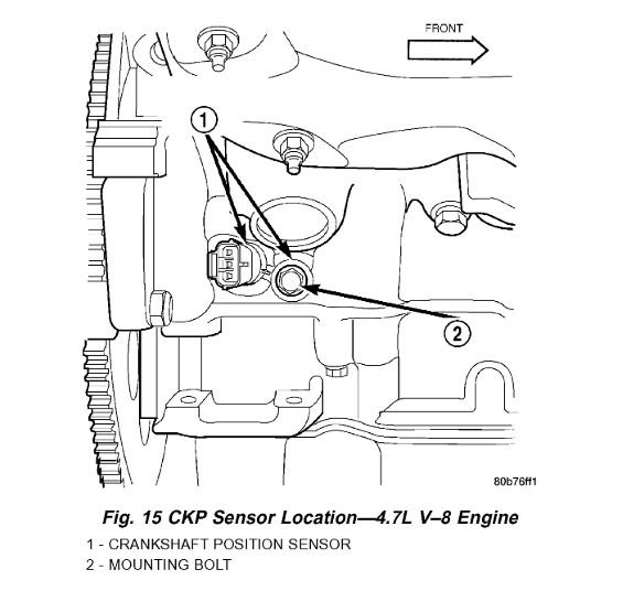

Do you have to drop the transmission on the vehicle listed above in order to replace the wiring harness that runs from the crankshaft position sensor to the top of the bell housing or the back of the engine believe it goes to the bell housing though?

Good afternoon,
No, not at all. The sensor is at the back of the block by the transmission and the harness goes up but does not go through the bell housing.
Can you see it go into the housing?
What is the exact issue?
Tuesday, November 19th, 2019 AT 11:36 AM

Yes the solenoid itself in the wiring harness runs up where the number one is on that picture that you sent me.

Oh sorry, it has been a long week with this truck. I meant the sensor. I'm trying to replace the wiring harness and I already replaced the sensor at the bottom of the motor just can't find the other end of the line.

It goes back to the PCM. There is no connector in the line.

That sensor connector just attaches to the connector that is on your sensor right now.

As I stated in my previous response, it goes back to the PCM. It is part of the main engine harness itself.
