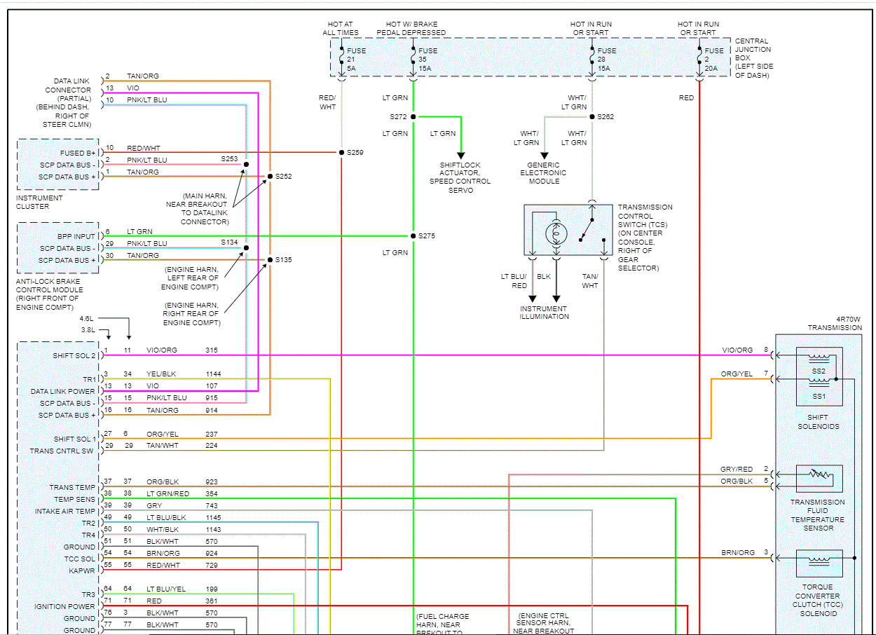

I am looking for wiring diagram of 15 pin connector going to back of engine towards transmission.

By chance, do you know what component or circuit this connector is related to? I tried really hard to find any 15-pin connectors, and the only thing I found was related to the airbag.
Let me know what circuit or circuits you are working with. It will help me find relevant schematics.
Take care and I'll watch for your reply.

It is part of engine controls so transmission wiring harness.

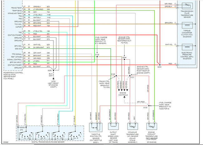

I attached the wiring schematic related to the transmission circuits. Take a look through them and let me know if that is what you needed. If it is something different, let me know and I'll try to get what you need.
See pics below. Note: The schematic was one page. I had to cut it in two, so it was readable for you. I did overlap the two so you can follow from one to the next.
