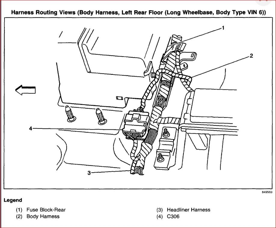

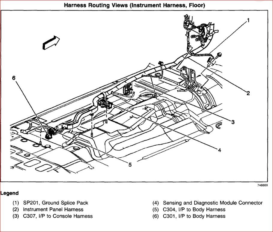

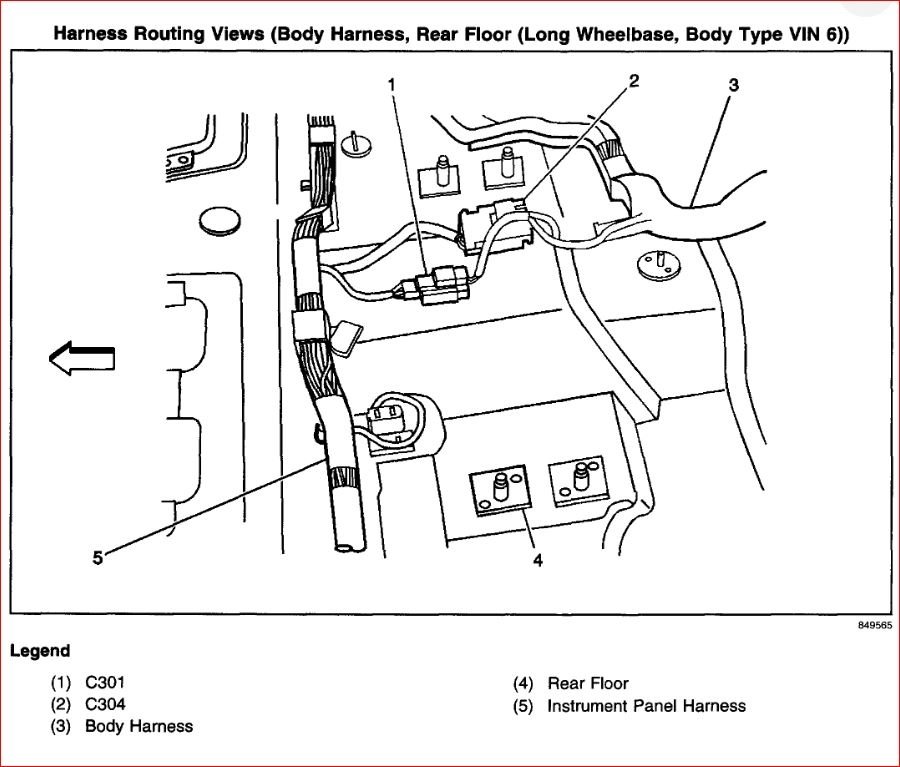

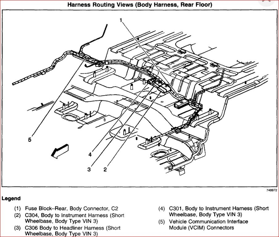

I pulled the center console in my blazer and I found a random wiring harness and I have no idea what it's for.
May 6, 2019 at 12:03 PM
Hi Houston,
Looks like these are all the harnesses on the floor. Does it look like any of these? Have you traced the wires? Does it look like an OEM harness or are they just loose wires? Take a picture of it and post it here if you want me to take a look at it.
Let me know if these are not it and we can go from there. Thanks

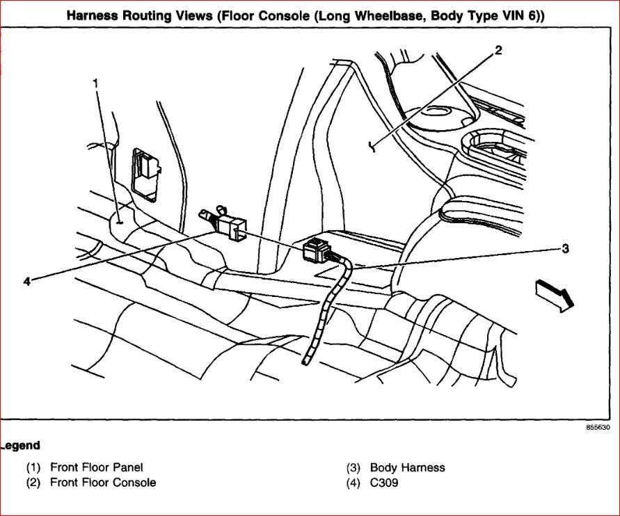

HOUSTON222

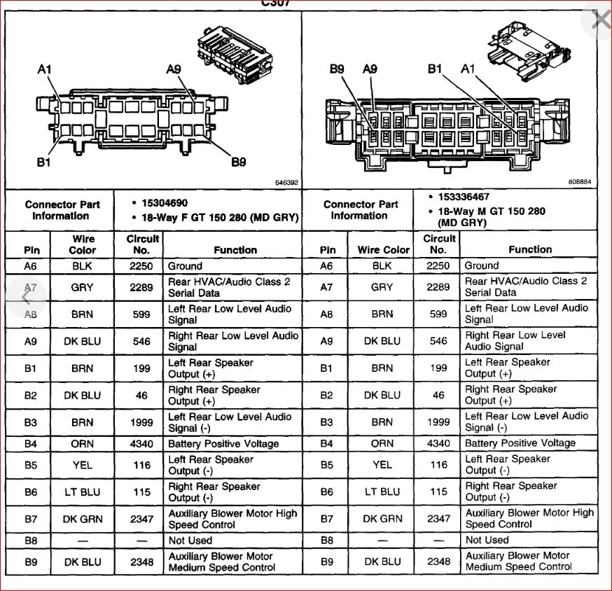

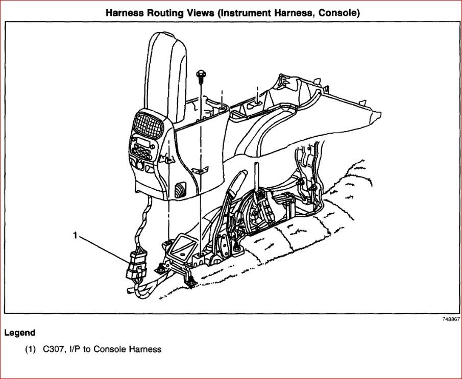

The fifth image shows the console wiring harness and that's what it is. I also need to find the fuse for it so I can use it for a custom console I'm installing.
May 7, 2019 at 1:40 PM

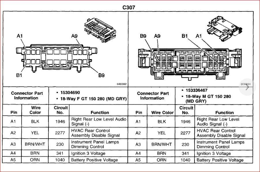

Well that is a little harder than you may think because there isn't a fuse for the harness. The fuses are for the individual circuits that may go through that harness.
Here are all the circuits that are part of that inline connector (C307) shown in the photo. If you tell me which circuit you want to tap into, I can get you the fuse for that circuit.
