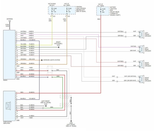

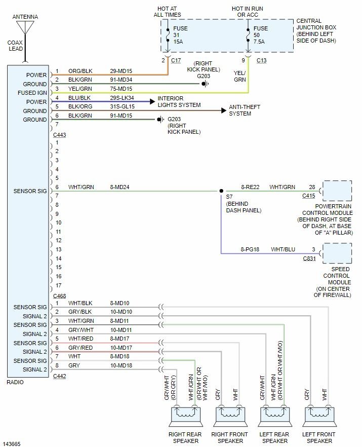

Need to know what wires go where when hooking up a Sony exploid cfx-gt620ip.

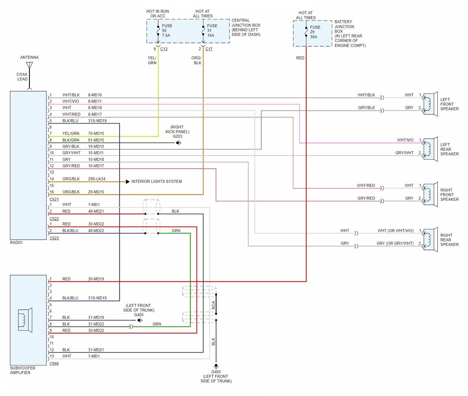

Looks like a head unit. Attached you will find the wiring for the base and up-level units. If you have the factory amp you may need a signal adapter if you want to use it.
