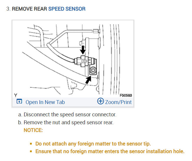

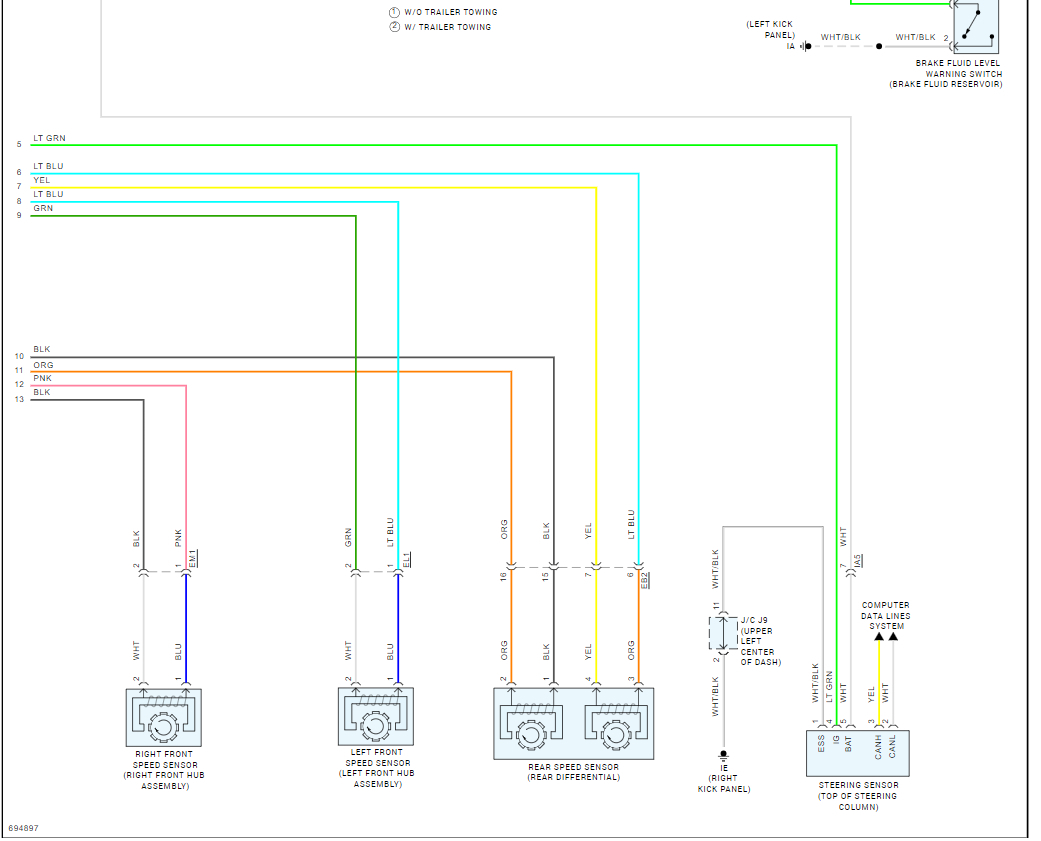

The rear speed sensor was severed. I bought a replacement, and I am preparing to replace it. Any informational videos out there?
Feb 5, 2024 at 12:42 AM
  • 55,433 POSTS

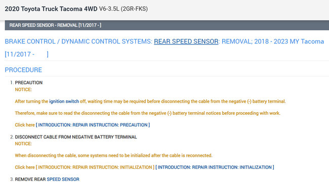

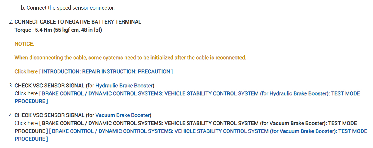

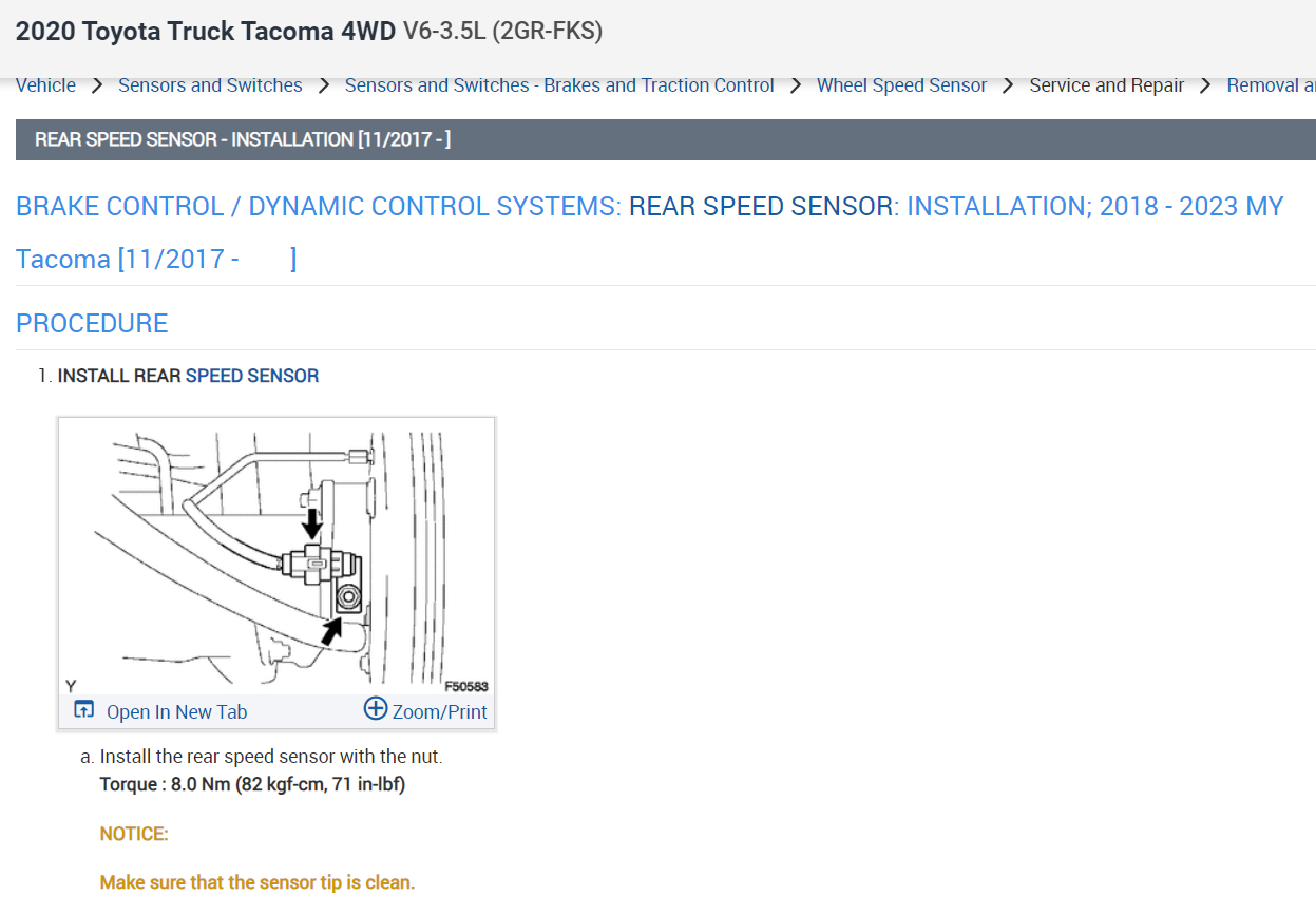

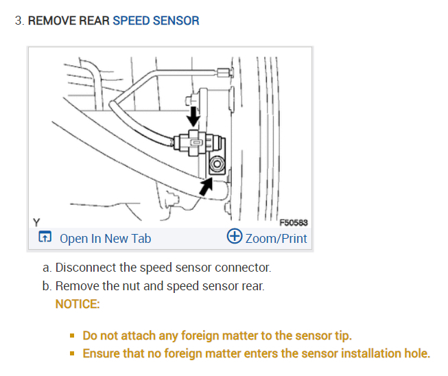

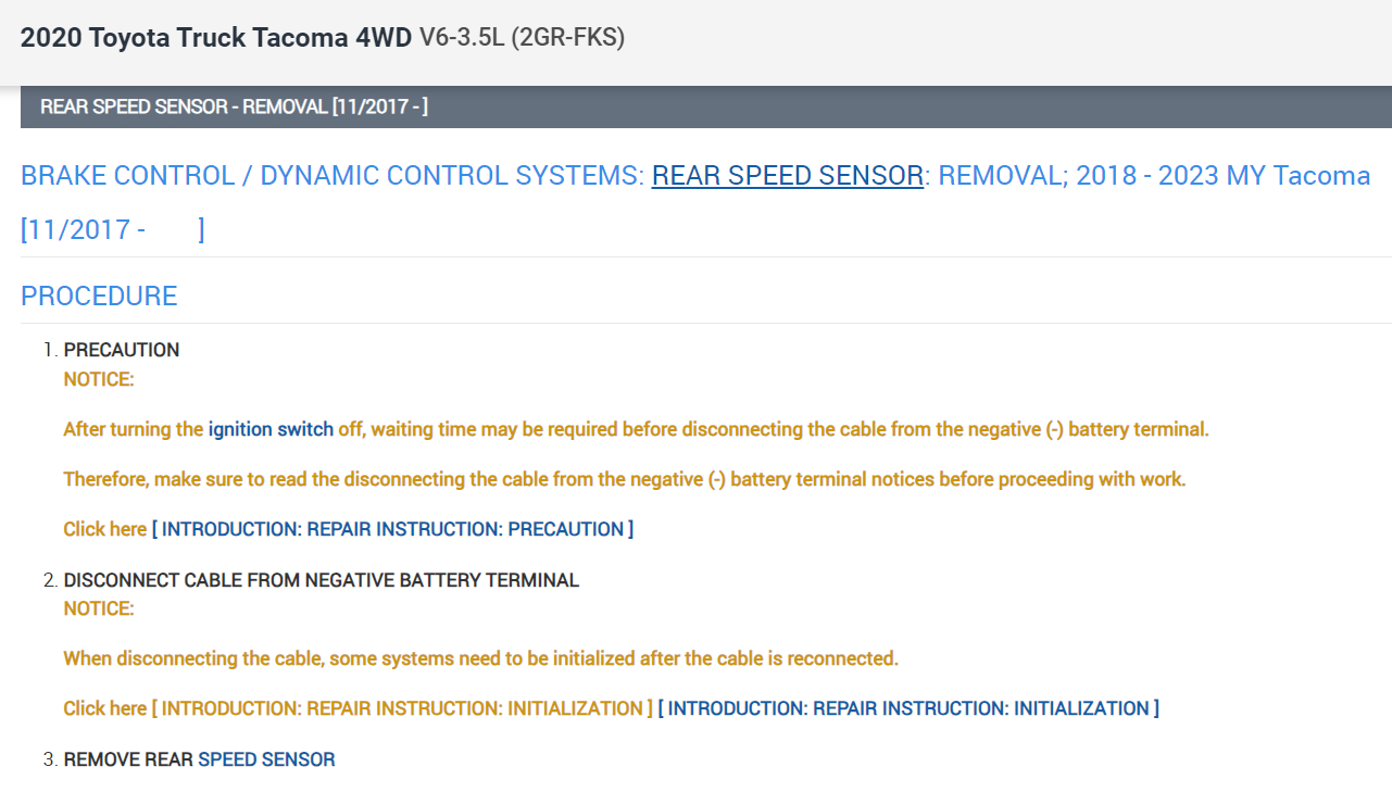

No videos but I have the instructions and location of the rear wheel speed sensors in the images below for you. Check out the images (below). Let us know if you need anything else.

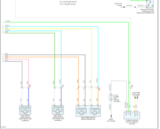

Whoops my bad, meant to describe it as the ABS speed sensor wiring harness.
Feb 5, 2024 at 9:39 AM
  • 55,433 POSTS

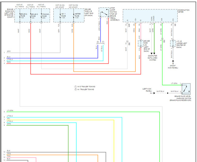

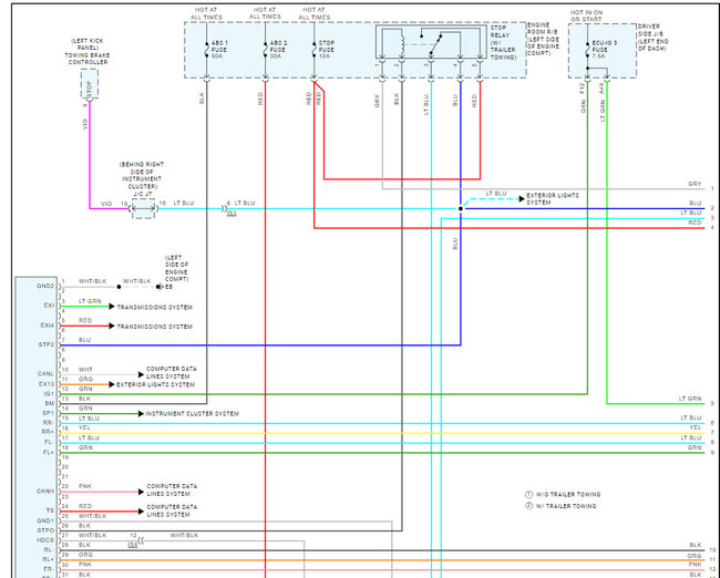

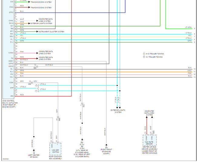

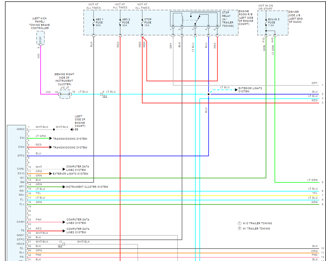

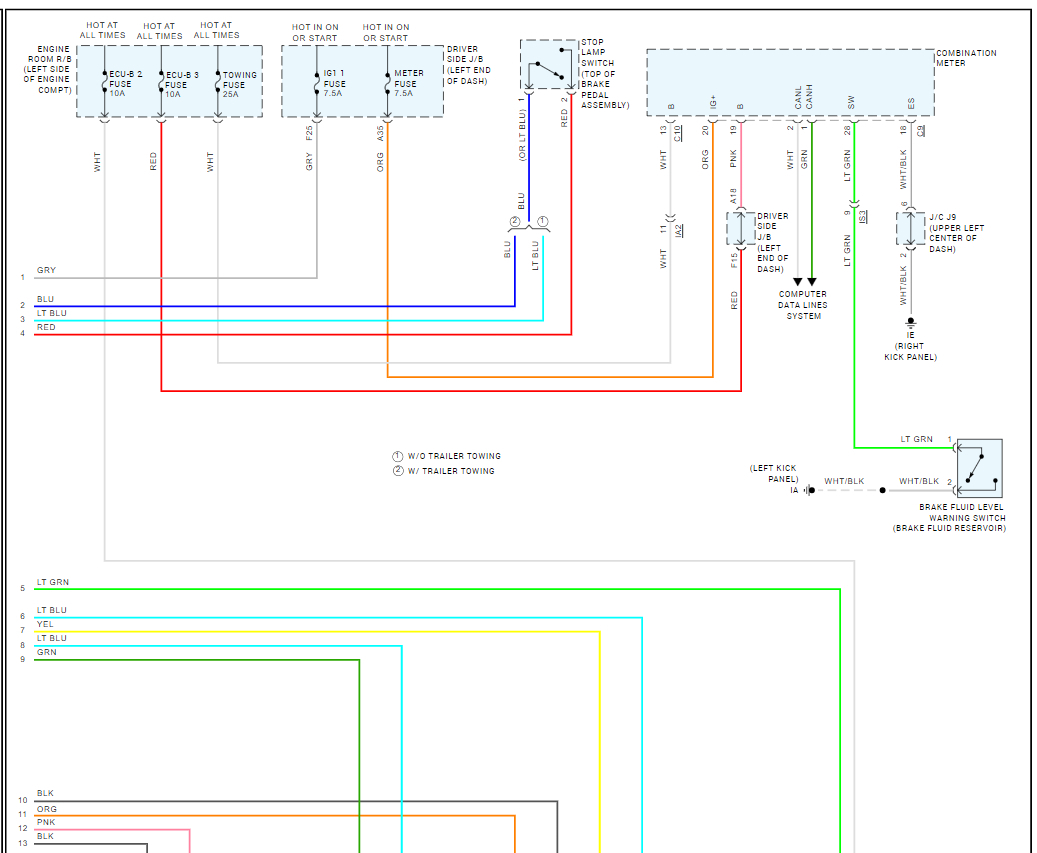

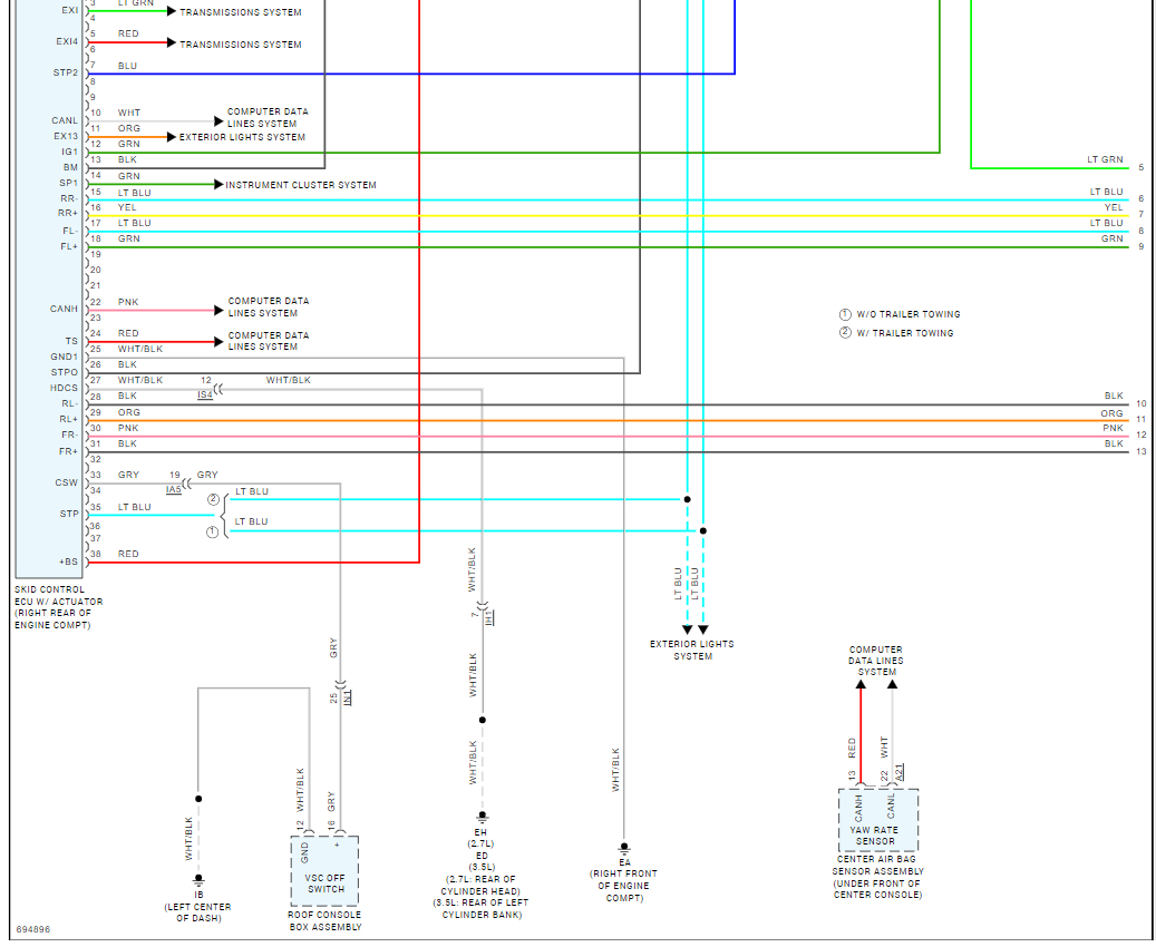

Do you need the wiring harness diagrams? I am not sure what you are saying, can you upload an image or short video? Here are the ABS rear wheel speed sensor wiring diagrams so you can see how the system works and how the wires are connected to the rear speed sensor. Check out the images (below). Let us know how it goes.
