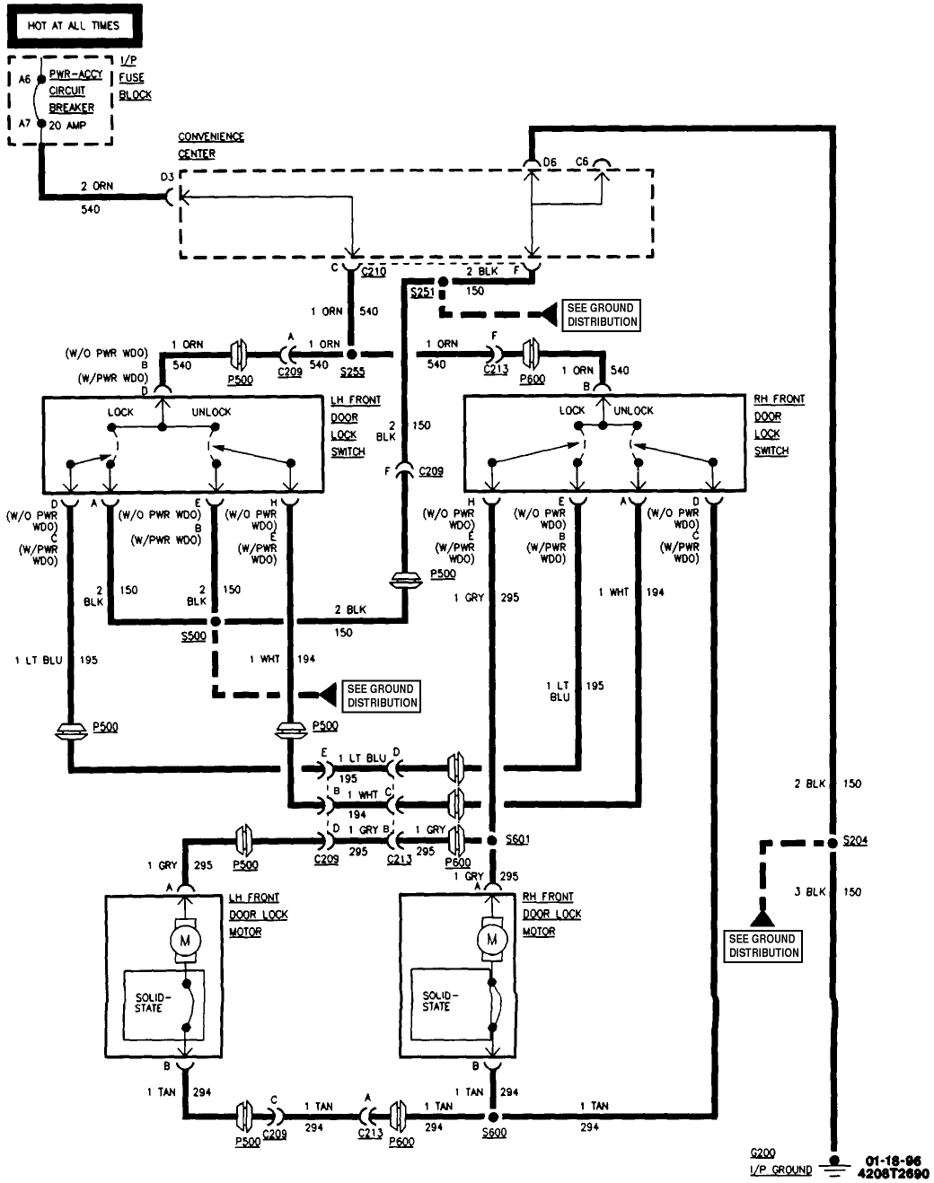

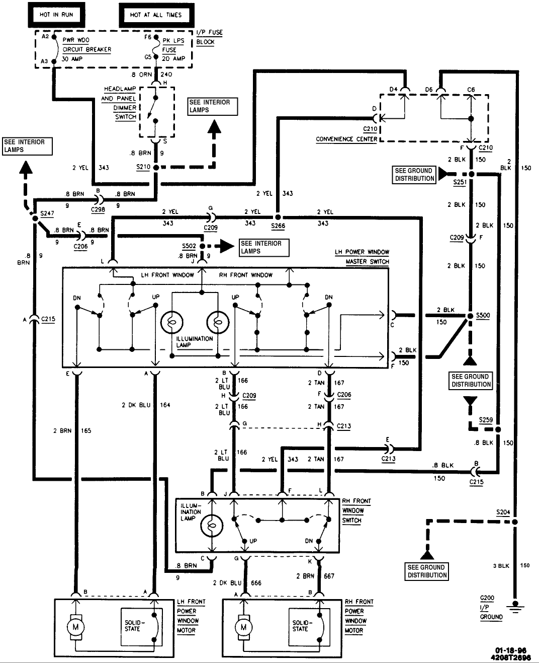

the power supply for the locks and doors has been cut. I need help.
Jun 22, 2017 at 2:51 AM
STEVE W.
  • 15,399 POSTS
The most common area for the power to fail is in the flex area from the pillar to the door. Not hard to repair, remove the inner door trim, then the lower kick panel. You will find a connector at one end or the the with the door wiring. Just follow the wires through the flex and repair the broken ones.
Jun 22, 2017 at 3:50 AM
BABYJAY531
  • 89 POSTS
I tried that it does not power on. i fixed some of it, but I cannot find the diagram to double check the wiring.
Jun 22, 2017 at 6:51 AM
STEVE W.
  • 15,399 POSTS
OK, here are the locks and windows. Yellow is the primary power for the windows, Orange for the locks. Both use simple polarity reversal in the switches to move the actuators.

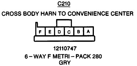

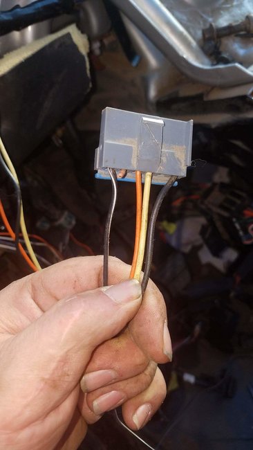

I finished the harness thank u Steve now I got another question I got this black and white wire that is in the convenience center I have no clue what is goes to I'm stumped

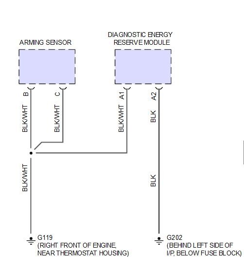

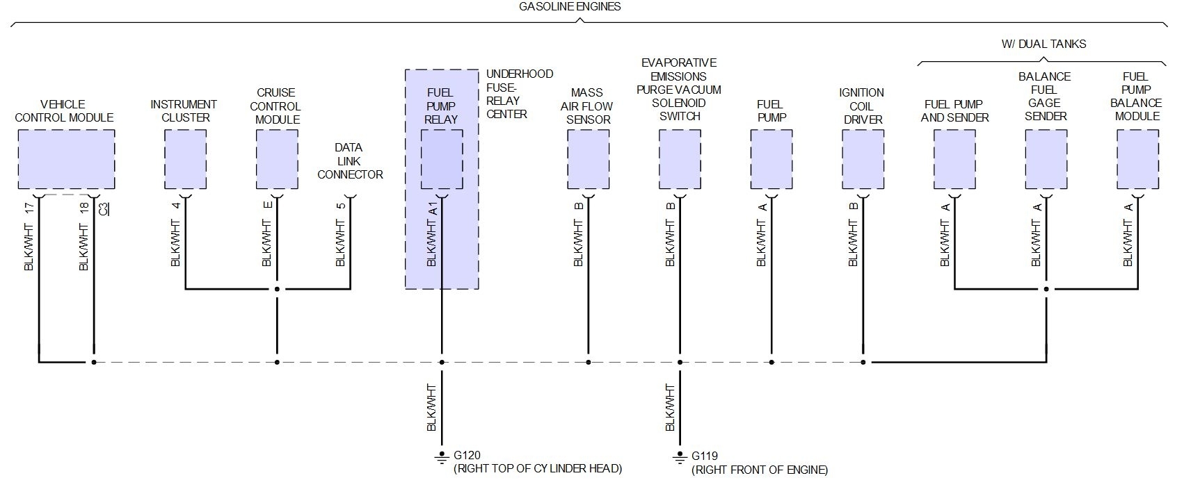

Black/White is a ground wire. Images show what uses that color. If I'm correct that is connector 210 a cross body harness. The wire is in position A The problem is that none of the diagrams show where the wires actually go !!!

I thought it was a 4wd indicator wire? My truck ain't starting because of the wire I think

The items in those diagrams are the only ones that use the black/white wire as a ground. 4WD indicator wire is one of them, but not the only one. What does the truck do in terms of not starting?

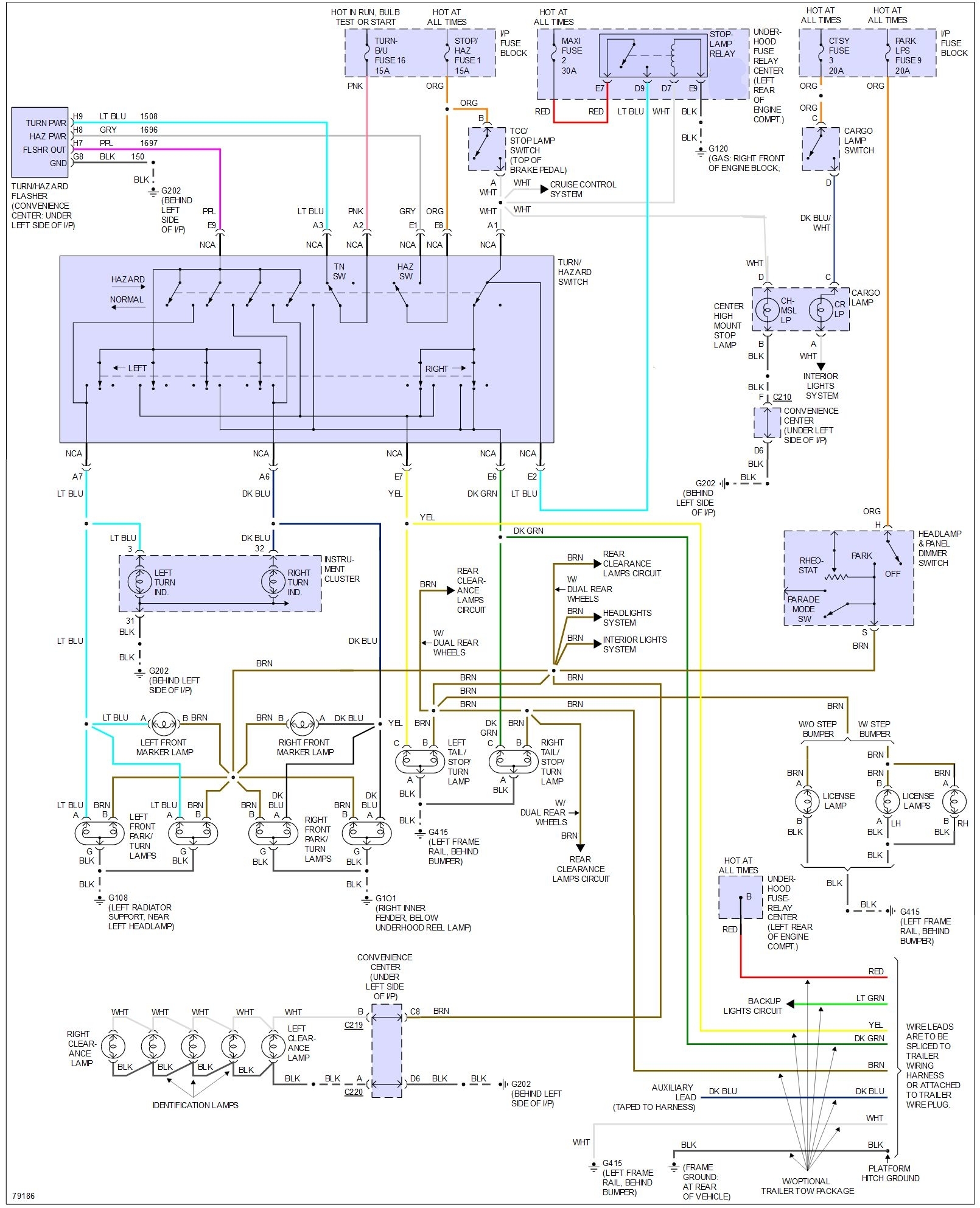

Ok I got another question everyone I push the brake pedal the brake fuse keeps blowing??
Jun 30, 2017 at 6:26 AM
STEVE W.
  • 15,399 POSTS

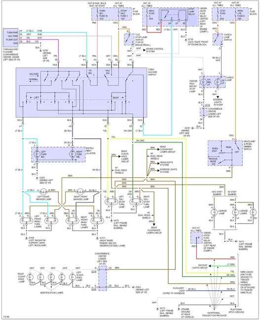

Short in the wiring, maybe why the CHMSL doesn't work as well. This is the wiring for the exterior lights. Might help.
Jun 30, 2017 at 7:53 AM
BABYJAY531
  • 89 POSTS
Ok so I tested the white wire for the third brake light and the test light lit up when I was holding in and it went off as soon as I let go of the pedal

STEVE W.
  • 15,399 POSTS
Been busy getting stuff ready for the 4th. Polishing fire equipment and mounting flags.
Anyway, I would say you have a short somewhere if it is blowing the fuse every time. Also check the ground for the light, if the ground is bad you don't get a light.
