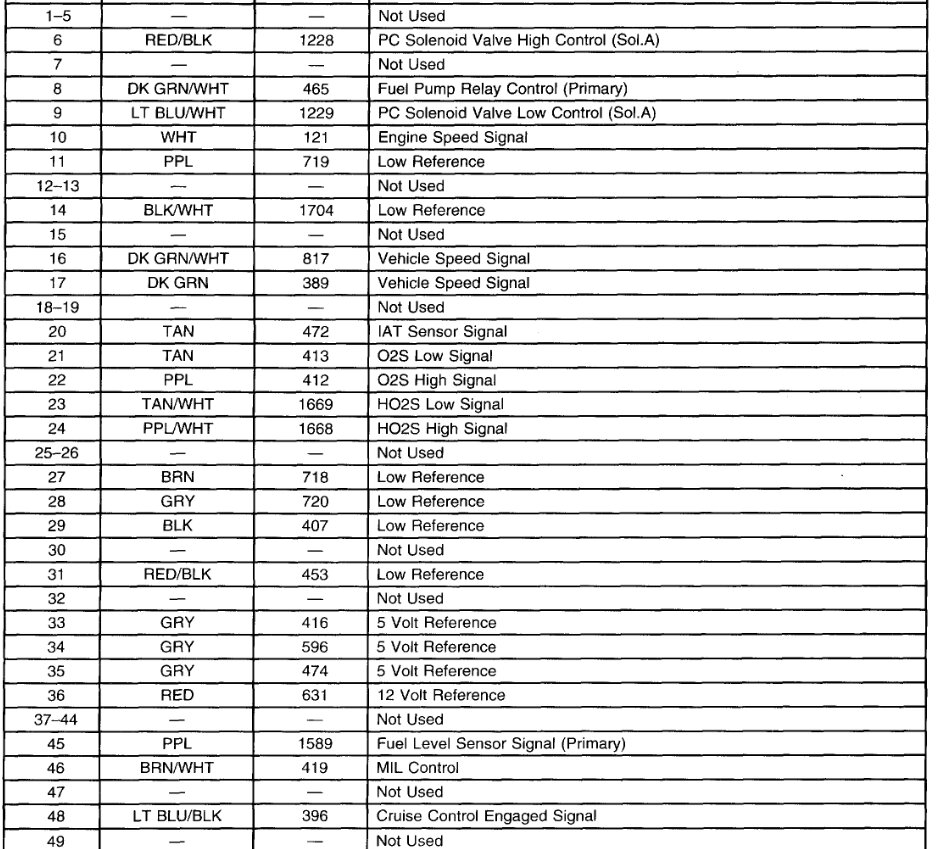

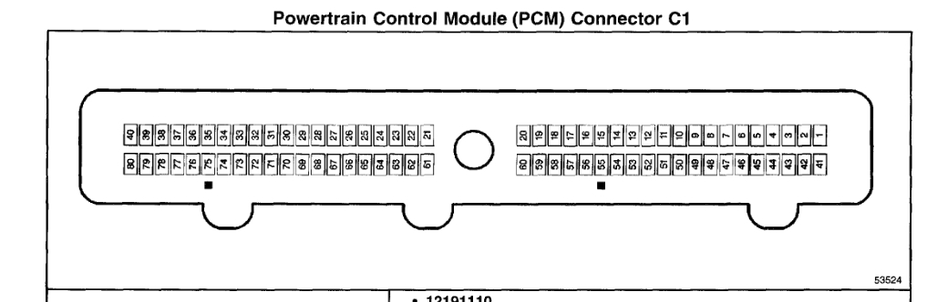

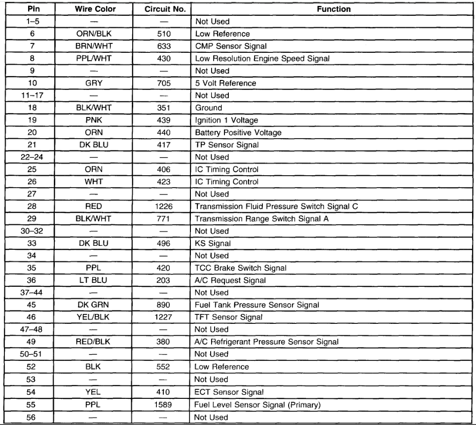

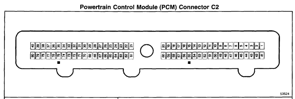

I have a wiring harness from a 2001 s10 2.2l. I need pin outs for the computer as the harness is going into my 98 s10 that is a 2.2l and I need to integrate it into the truck. Thanks in advance
Aug 22, 2024 at 10:02 PM
  • 55,433 POSTS

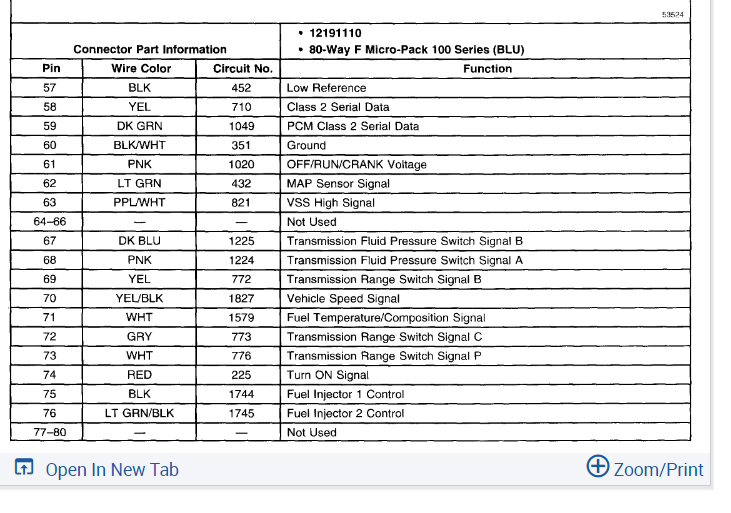

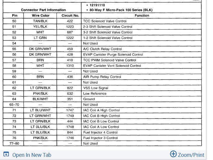

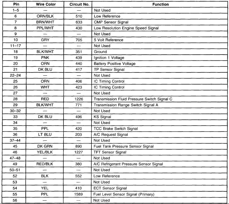

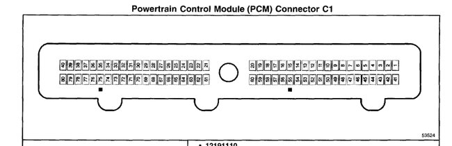

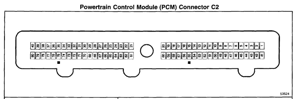

Sure, here are the PCM C1 and C2 connector pinout views. Check out the images (below). Let us know if you need anything else.

What pin outs are these? Are they for the 2001 or the 1998 I’ll need both for this to work.
Aug 23, 2024 at 5:01 AM
  • 55,433 POSTS
This post is for the 2001 CHEVROLET S-10.
