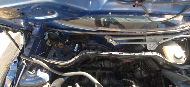

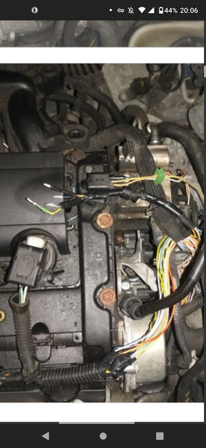

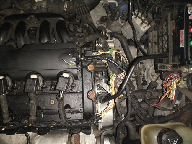

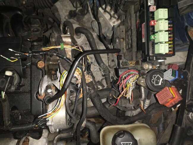

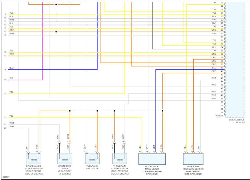

The wire harness was cut. Please see attached photos. Where do I begin? Almost everything electrical works. But I have a no spark/ no start condition. With the following codes U114B, U115E, U115B, P173B, P1776. I can't find a wiring schematic anywhere please help.
Oct 4, 2023 at 12:26 PM
  • 110,244 POSTS

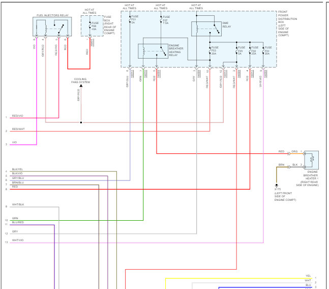

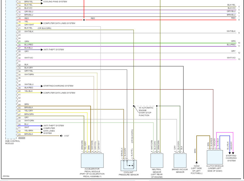

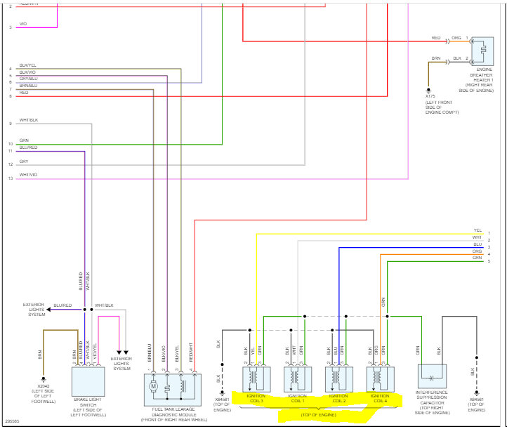

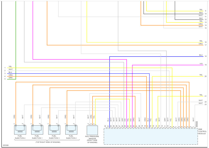

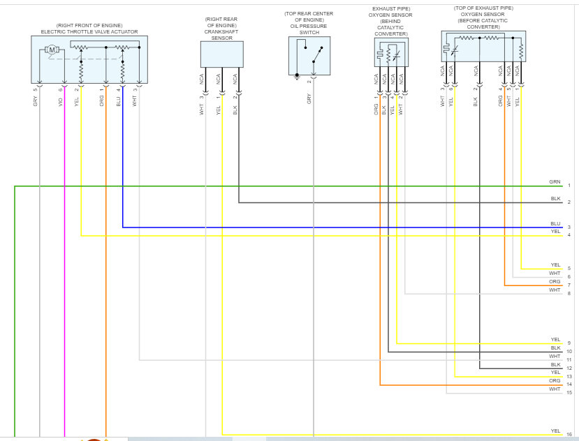

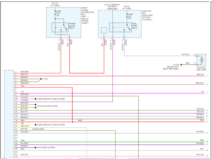

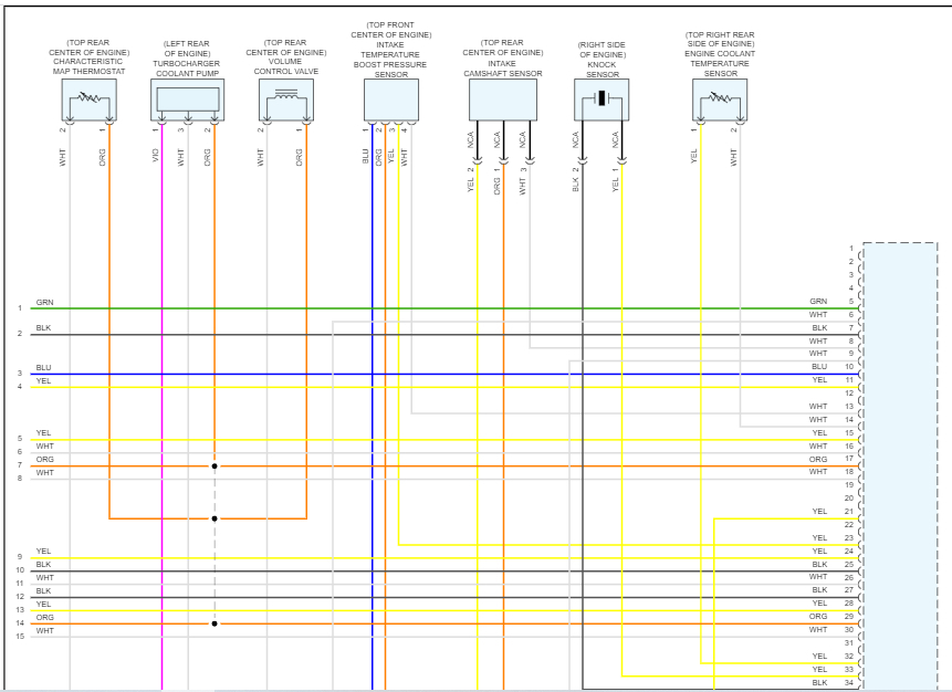

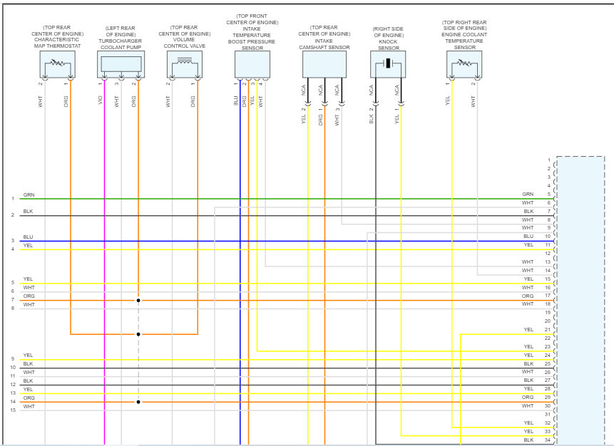

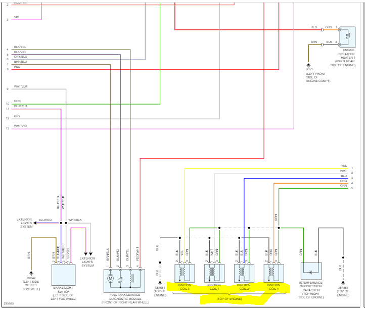

Wow. That is going to be a tough one. Not knowing what all has been cut, I'm going to start with the no spark issue.

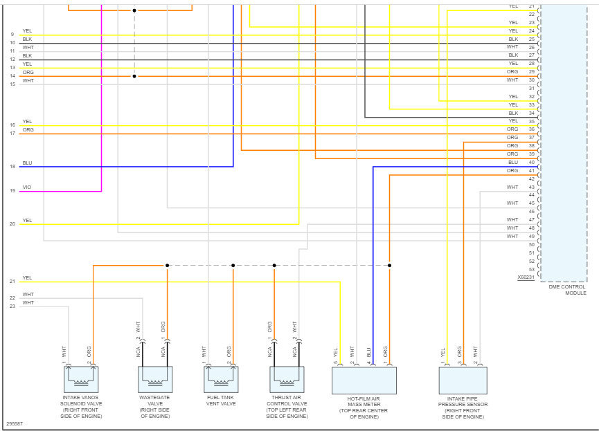

If you look below, I attached the wiring schematics for the powertrain management circuits. I had to cut each pic in half to make it readable, but I did overlap them where I cut.
In pic 4, I highlighted the ignition coils for you.
Let me know if this helps.

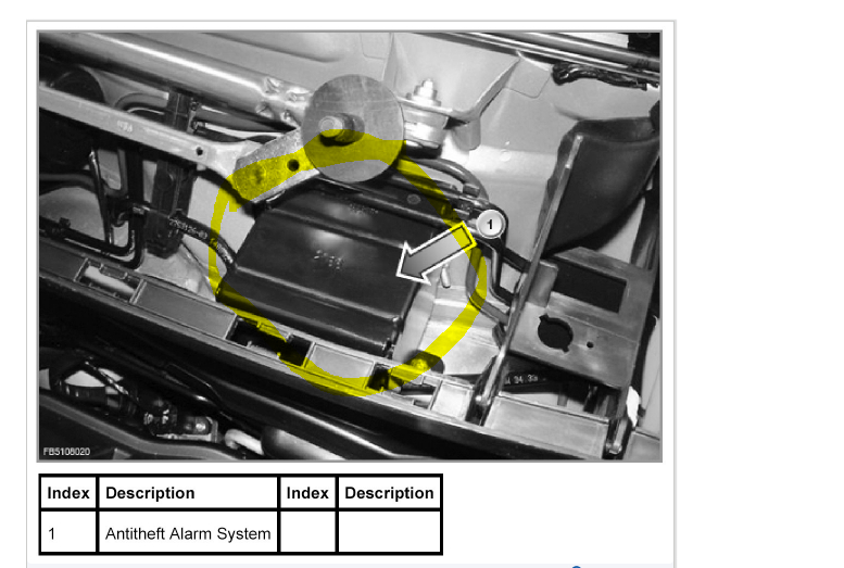

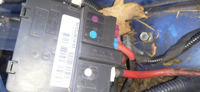

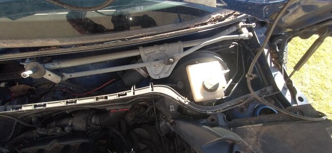

The yellow key light sounds like it could be related to the anti-theft. Was any of the wiring damaged at the anti-theft module? See pic below.
See pic below.
Oct 11, 2023 at 12:08 PM
MVANN74
  • 65 POSTS
The anti theft module pictured looks like it's under the cowl for wipers. It's not in that location on this mini s. But there is a little black box next to the battery.
Oct 18, 2023 at 3:35 PM
  • 110,244 POSTS
Did you remove the cover on the cowl? That is the only location it is showing in my manual.
Oct 19, 2023 at 10:09 AM
MVANN74
  • 65 POSTS
Removed cowl. The only box under there is the one in first pic. Is this the one?
Oct 20, 2023 at 6:16 AM
  • 110,244 POSTS
That appears to be it. It should have been mounted. Was it loose under there?

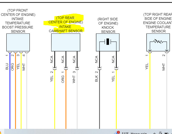

I knocked it loose a few days ago trying to install the battery. Although the red wire with white clip was not fully seated. Pushed clip in. Still nothing. Still no fuel no spark condition. There's also 3 wires see pic below that are I believe go to the cam sensor. They are orange, white, and yellow. Would that cause a no spark no fuel condition?
Oct 20, 2023 at 11:09 AM
  • 110,244 POSTS
The wire colors you mentioned appear to be for the camshaft position sensor. Is the connector still there? (see pic below)
As far as no spark or fuel, I would think the DME would go into a preset mode to allow the engine to run, but anything is possible. They need to be connected, so it would be worth a try.
On the other hand, if there is no ignition received (engine starting), the fuel pump is turned off to prevent flooding.
See pic below.
Oct 20, 2023 at 2:35 PM
MVANN74
  • 65 POSTS
There is no connector for cam sensor. Neither is there one for the MAF the 4 wires next to it in same pic. Will definitely get those connectors on there and let you know how it goes.
