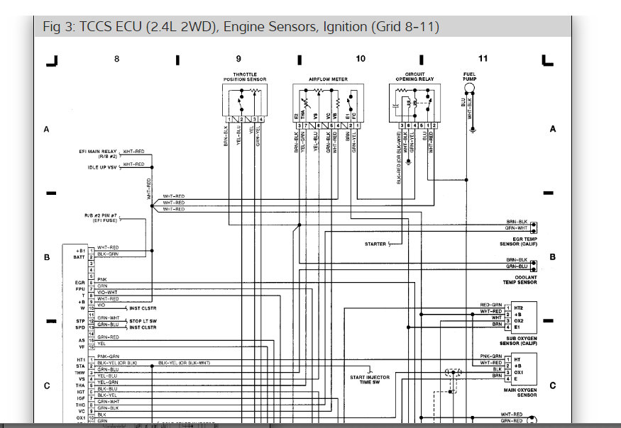

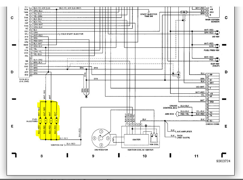

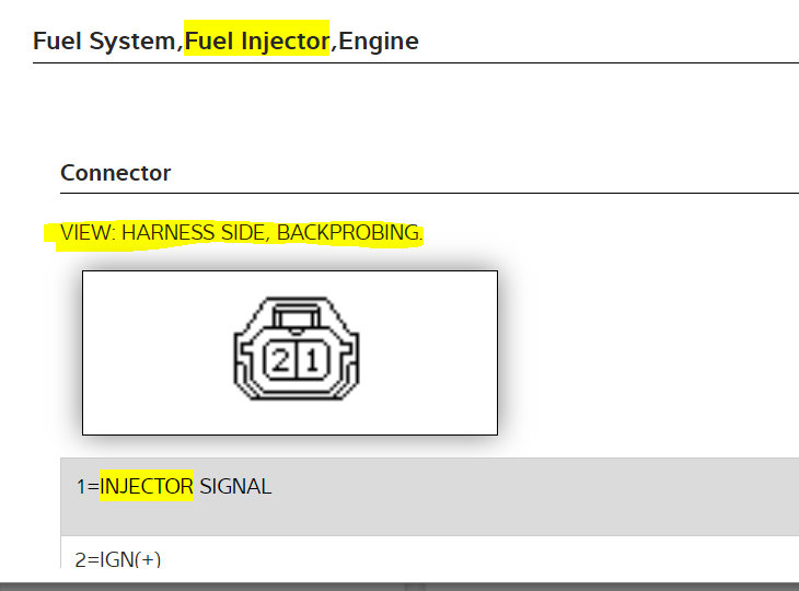

i forgot how to re connect my injectors the right way.
Sep 1, 2019 at 2:22 PM
SCGRANTURISMO
  • 4,897 POSTS
In the wiring diagrams down below I have included the wiring diagram showing the fuel injectors for your vehicle. I have also included a diagram of the fuel injector connectors so you can match up the wires to what cavity they go on the connector. Please use these diagrams to get the wires matched up on your fuel injectors and let us know how everything turns out.
