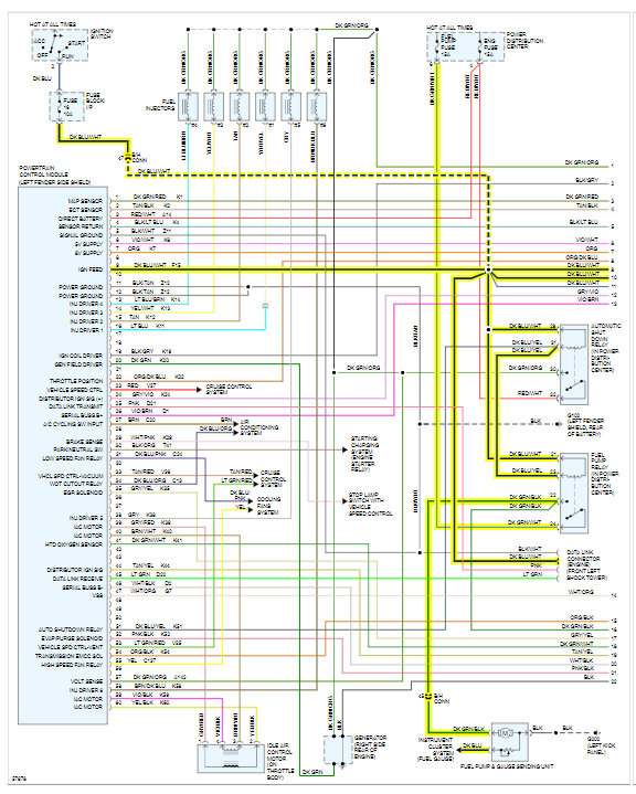

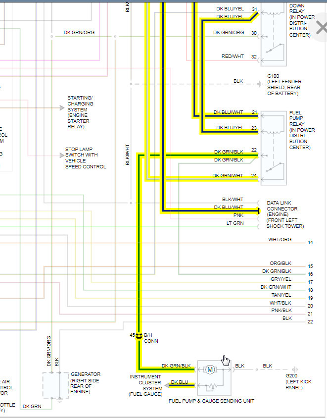

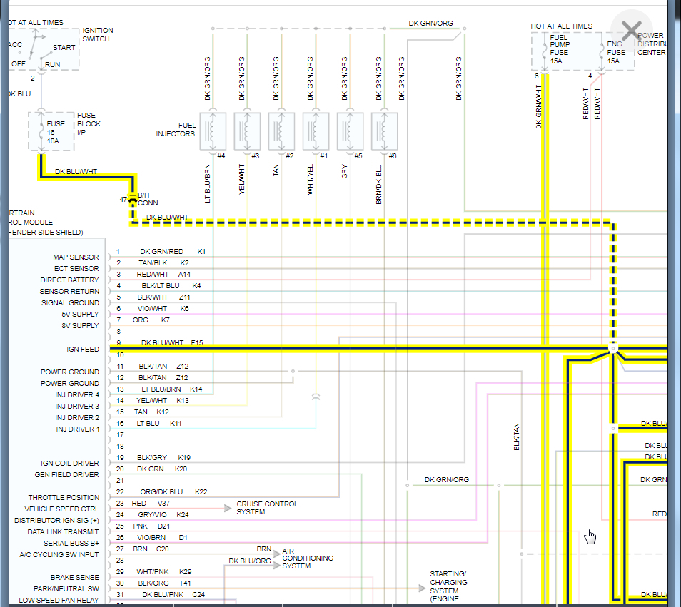

Fuel pump will work. I need pump wiring diagram so I can see were all wires go and what they do no power to rear at tank. I have made a jumper wire to check pump that is the only way it runs. Thanks
Jun 24, 2018 at 6:01 PM
More then likely the fuel pump fuse in the PDC has failed. Take a look at the wiring diagrams I attached below and you can follow power back through the system. If the fuse is ok, then the relay is most likely the next issues.
Here are some guides that will help with this:
Run through this material and let me know what questions you have. Thanks
