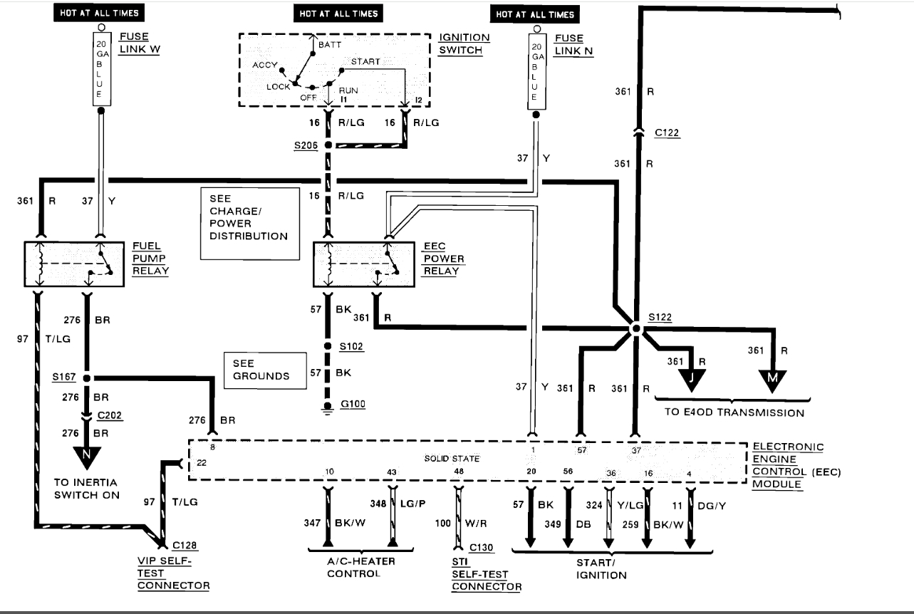

Wiring eec relay and fuel pump relay fuel pump not co.i g on check engine lightt when key on not coming on?
1990 FORD F-150
300,000 MILES • 5.0L • AUTOMATIC
GABB33
  • 9 POSTS
Had a blow out driver front tire wheel well got tookn out some where ripped not alot relays where gone need to figure out what right red wires go where I checked power at starter relay so no fusible link blown I don't think

Computer not waking up cranks over no start my lights come on

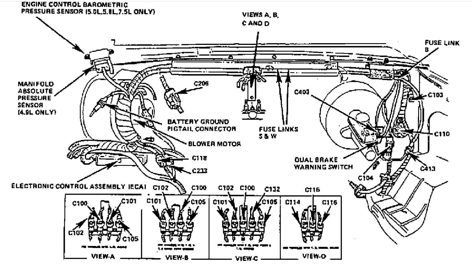

Yep, this is common when one of the fusible links goes out, most of the time they get old and just corrode. Check out the image below.

Wires to relay a couple got ripped 5 pin relays 2 red wirs on one slot forget wich relay two yellow on eec relay
Sep 21, 2026 at 5:57 AM
  • 55,381 POSTS
Gotcha, here is the wiring diagrams for the ECC relay.
