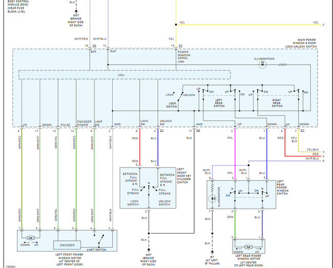

My wiring got unplugged from the bracket when repairing my window regulator and I need help with the correct wiring locations to go back . The whole piece didn’t come out just the wires and I can’t remember what way they went
Apr 21, 2026 at 6:33 AM
  • 55,399 POSTS
I got you covered, here are the wiring diagrams for the window motor and main switch. Check out the images (below). Let us know if you need anything else.
