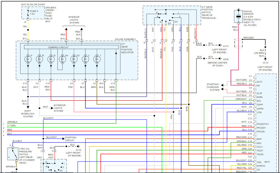

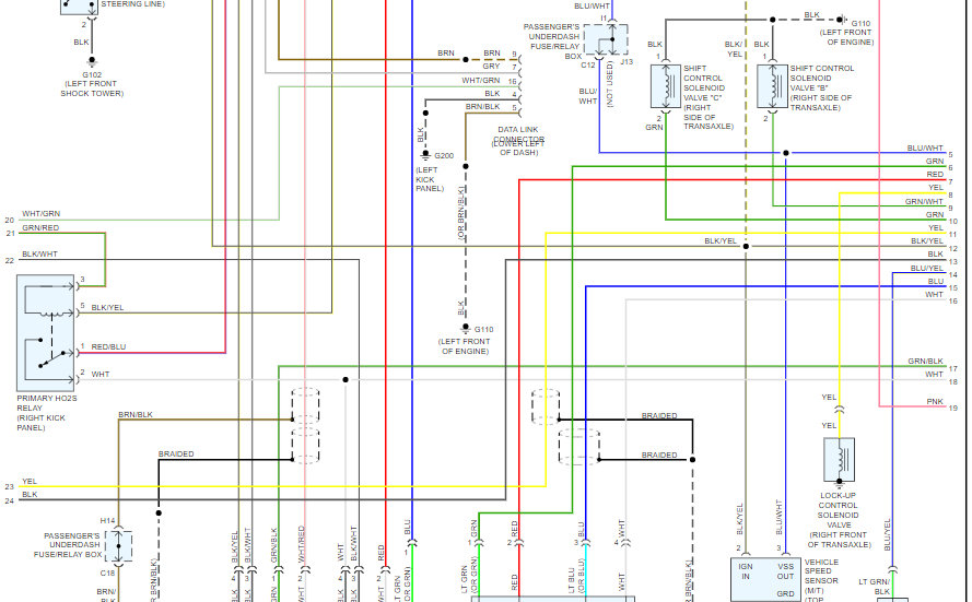

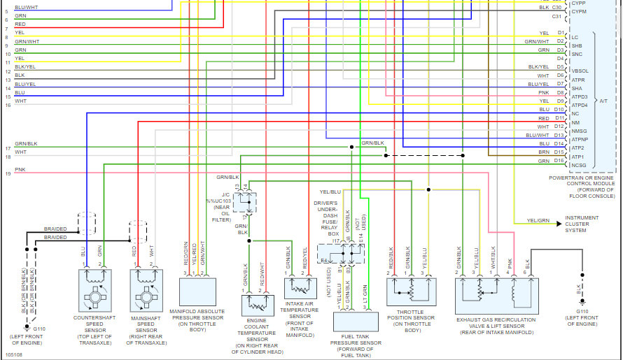

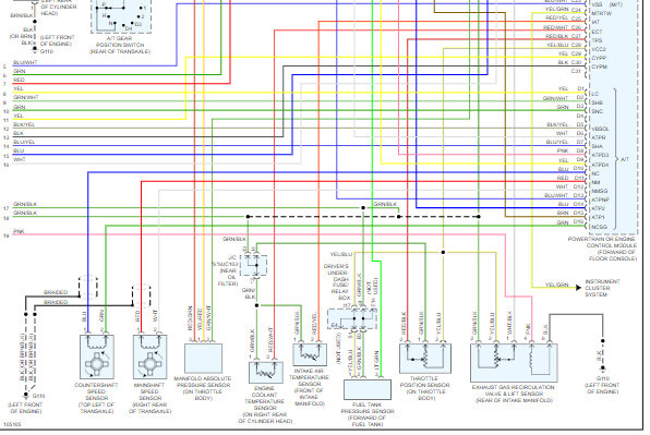

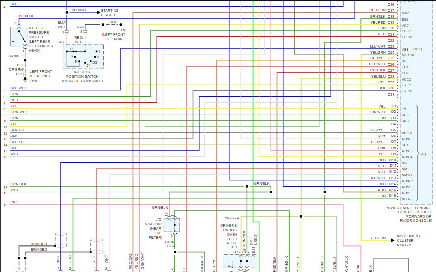

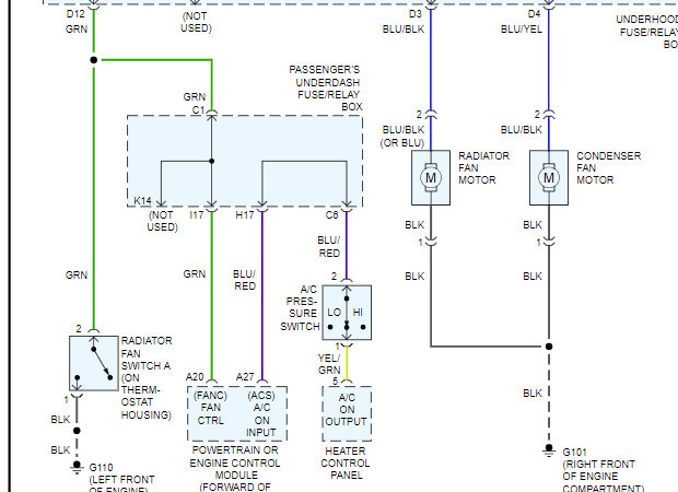

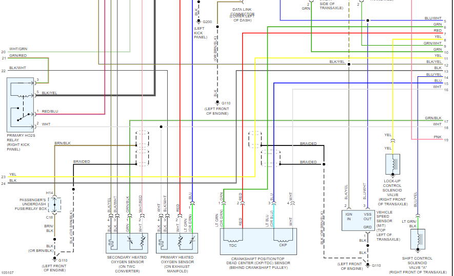

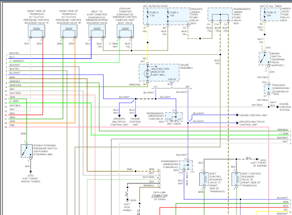

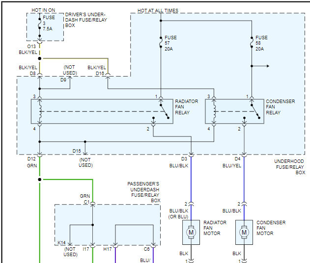

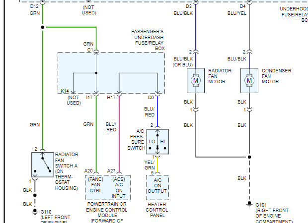

Hello guys. When ignition key is turned to "run" I am getting engine cooling fans on [high] and fuel pump not priming. Can I get the Engine Cooling Fans and Engine Management wiring diagrams please? Thank you.

Hello, I'm Danny.
Here are the 2 wiring diagrams you requested.I based this off an Accord EX. I've cut the pictures in half so you can view larger.Hope this helps and thanks for using 2CarPros.

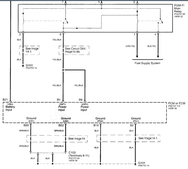

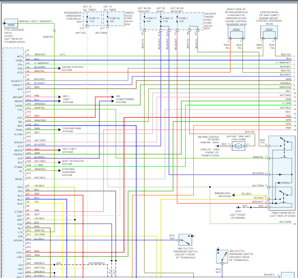

Hello again,

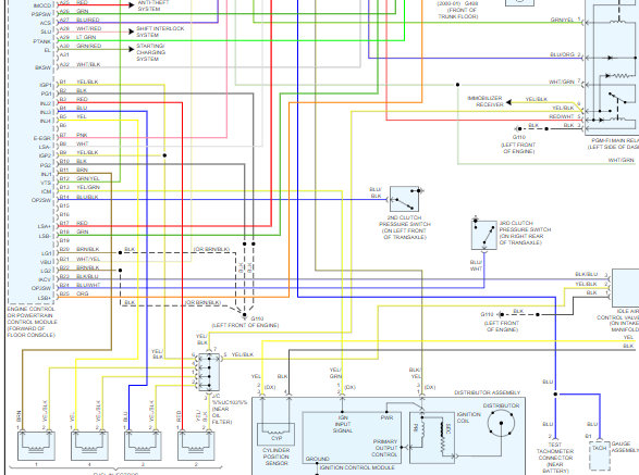

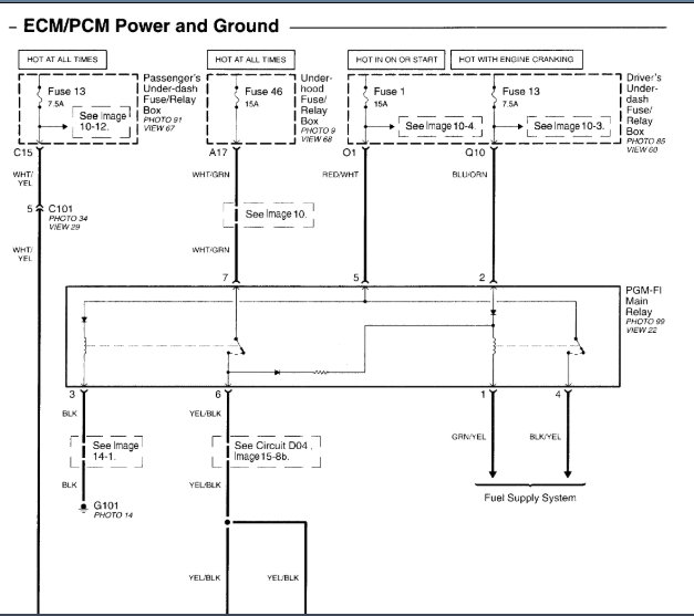

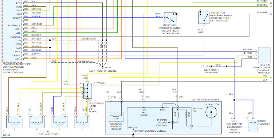

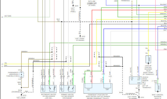

Can I please get the Engine Management wiring diagram set from Alldata?

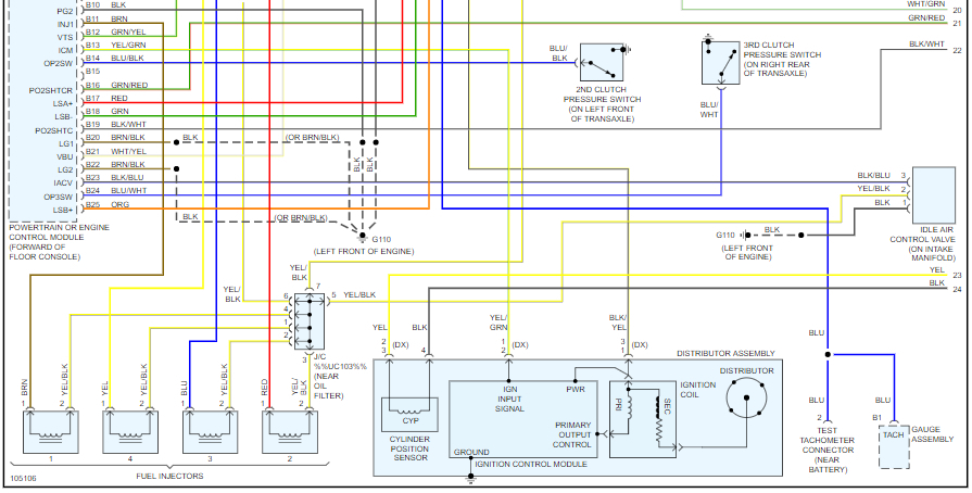

Hello again Alex.
Here are the diagrams you asked for. Again, I've cut them in half to view larger and posted them below.This is for Without Ultra Low Emissions. If needed I can additional attached more for the Ultra Low Emission as well.Hope this helps and let me know if any other diagrams needed.Thanks again for using 2CarPros.

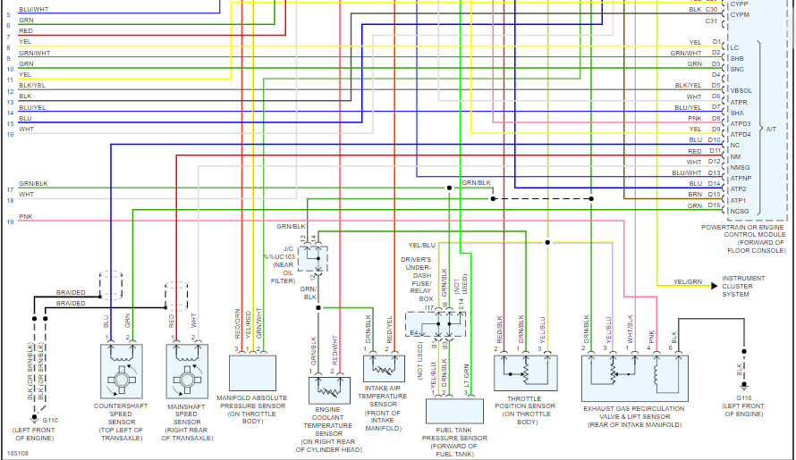

Hello again,

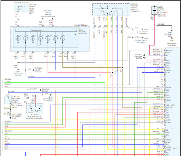

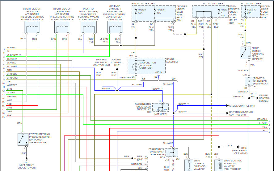

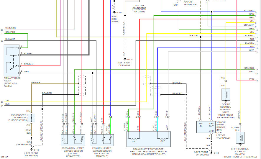

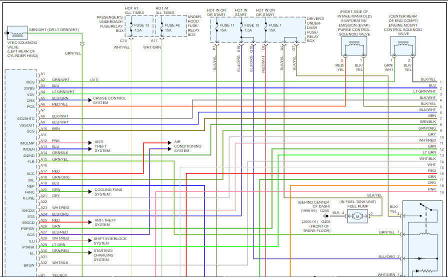

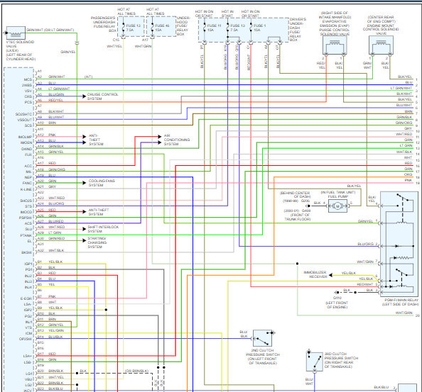

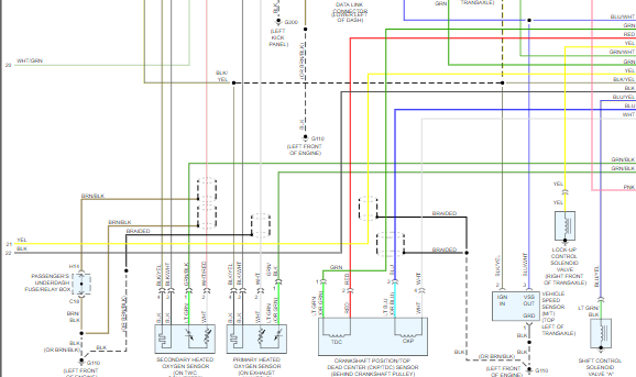

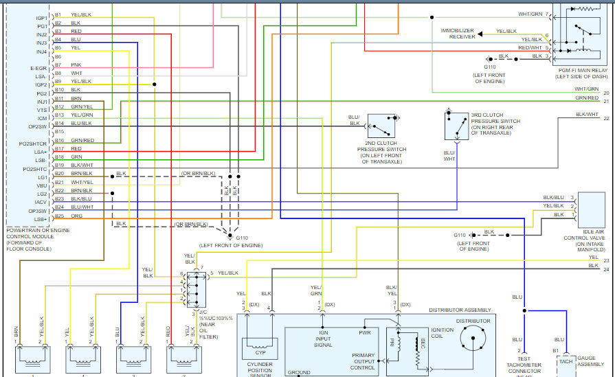

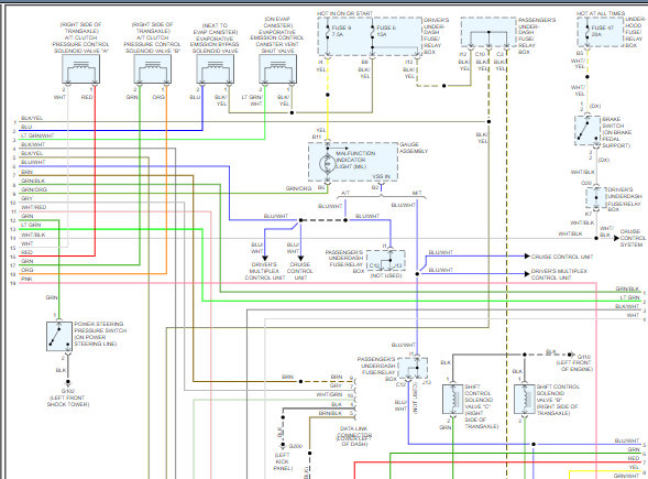

I am working on a ULEV. Sorry for not mentioning that. Could you send those along to me as well?

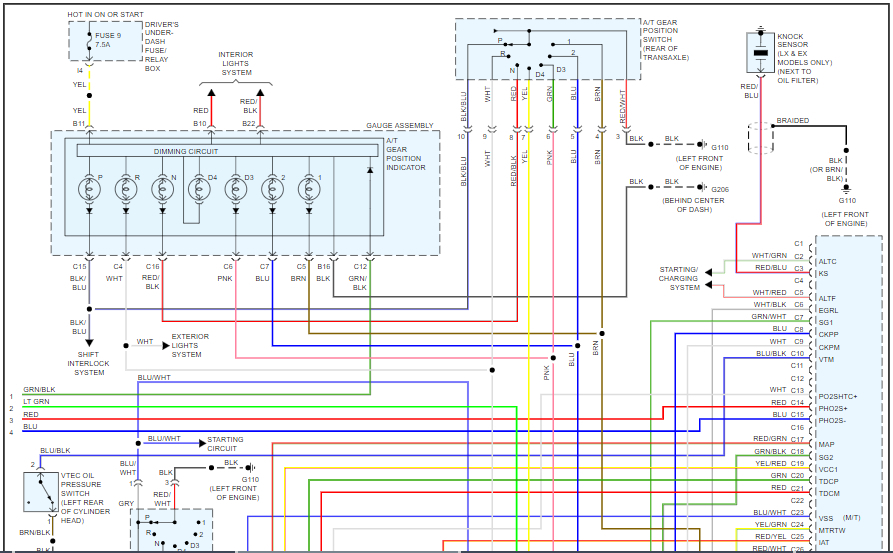

Hello again Alex..
Here are the diagrams for an Ultra Low Emission Accord. I've cut them in 3 pieces each to view larger.Hope this helps and thanks again for using 2CarPros.
