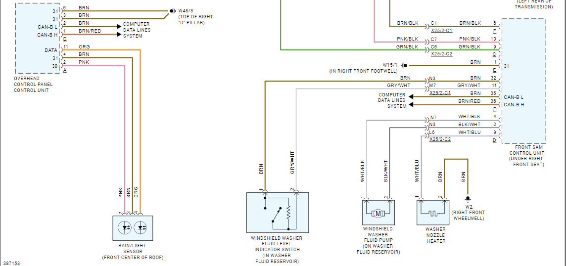

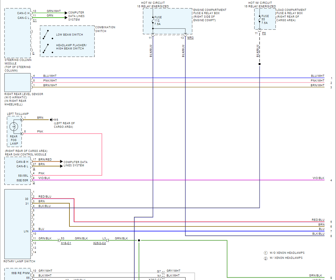

I need wiring diagrams for 'headlight system' and 'wiper/washer system' from Front SAM.

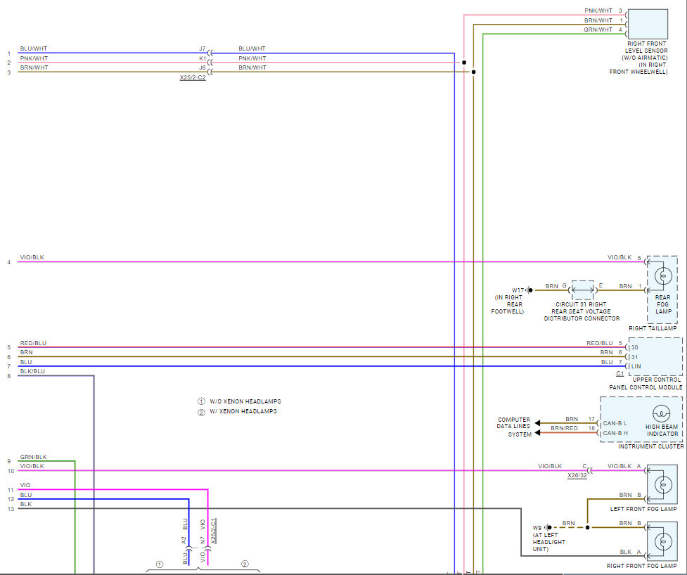

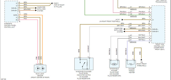

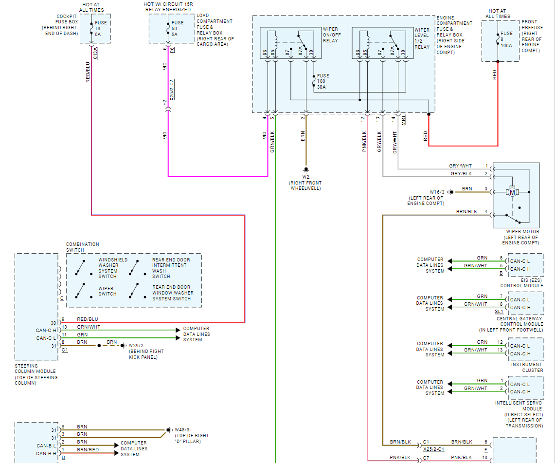

Here's the Wiper/Washer to start with Top and Bottom, I'll look for the OEM after posting the aftermarket ones so you can get started.

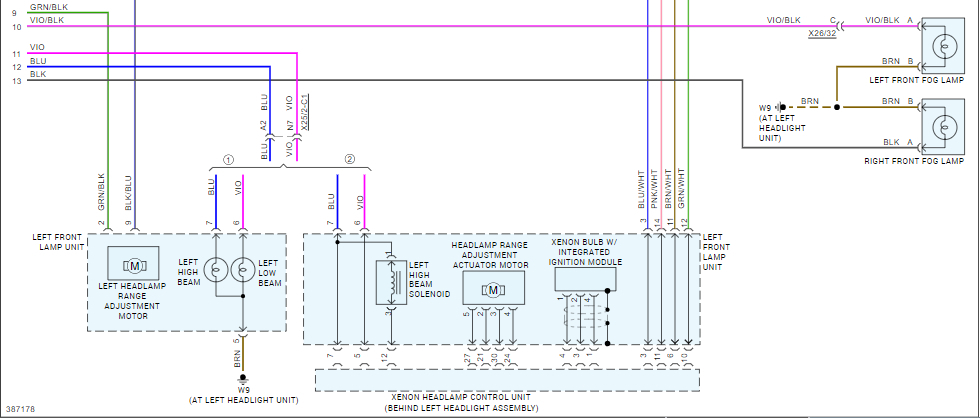

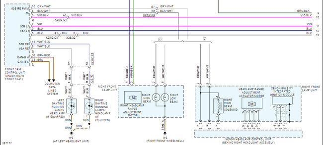

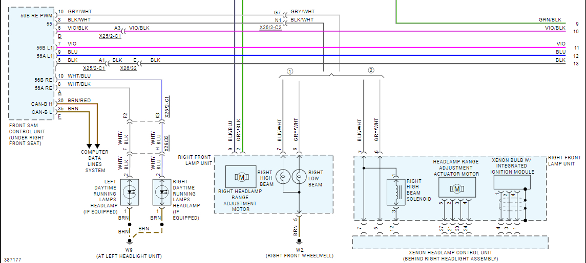

Here's Headlamps top and bottom page 1 (diagrams 1, 2 ) and page 2 (diagrams 3, 4).
