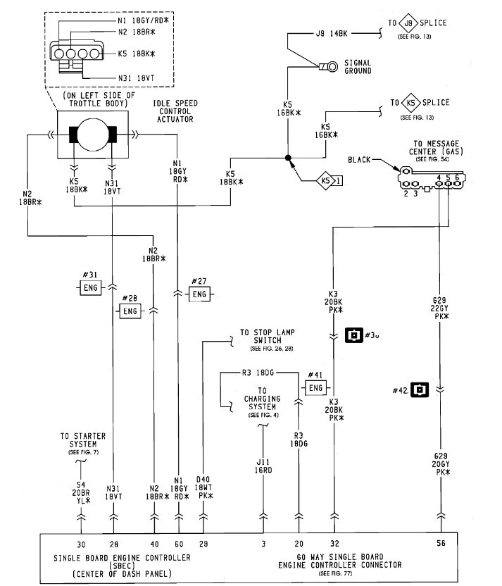

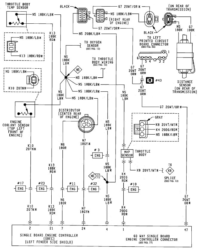

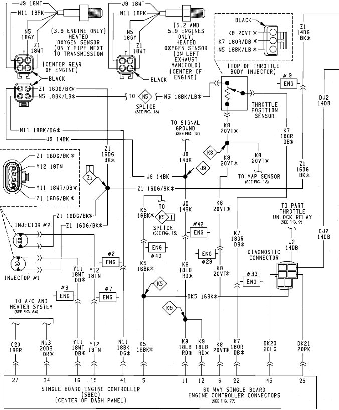

Yep, here are the engine wiring diagrams that include the engine control module and I have included a guide to help you test the wiring connections as well.
Oct 16, 2023 at 5:09 AM
JAIR
  • 8 POSTS
This is helpful, but are these diagrams for a diesel truck? My truck is diesel and i noticed that these diagrams might be for a gas truck. Thanks for the help in advance.

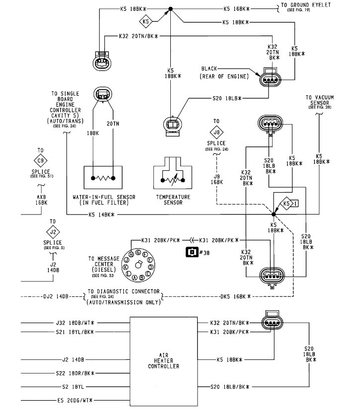

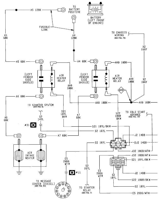

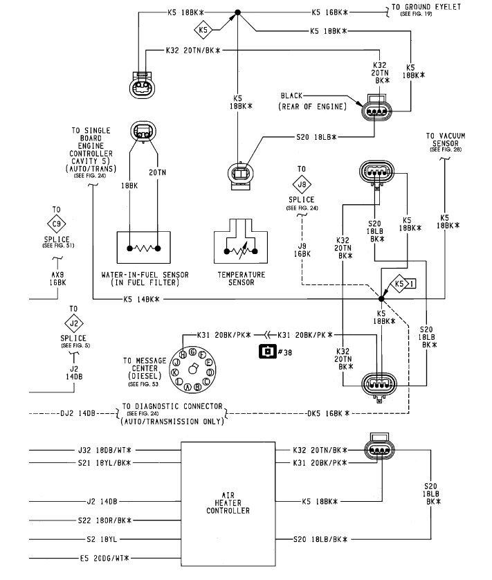

Uh not that i know of it is a 1990 Dodge W250 with a 5.9L turbo diesel.
Oct 17, 2023 at 2:48 AM
  • 55,433 POSTS
Gotcha, here are the engine wiring diagrams needed. Check out the images (below).
Oct 17, 2023 at 2:53 AM
JAIR
  • 8 POSTS
Okay, thanks this is helpful. Also, if you have one for the main wiring harness that is in the engine bay (which plugs into the cab) that would be awesome.
