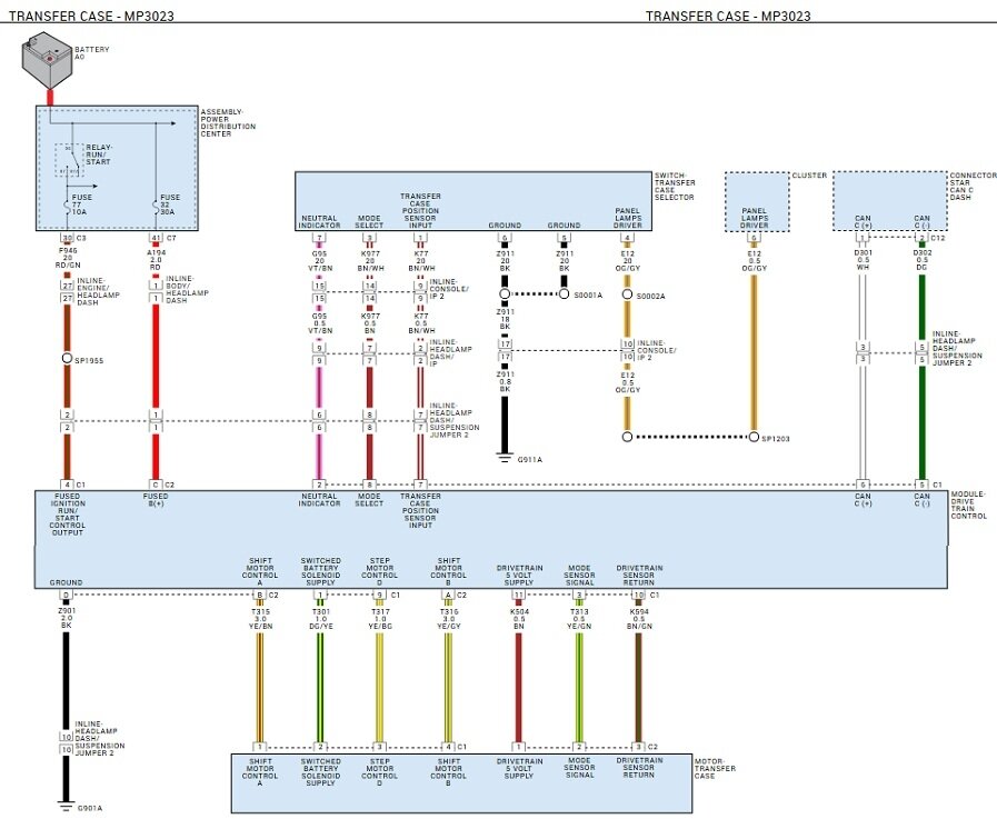

My TCCM (transfer case control module) isn't receiving power, according to two shop diagnosis. I can't seem to find any wiring diagrams online?

Unfortunately, around 2013 - 2014, AllData stopped using the manufacturer's diagrams. This is their aftermarket version. If you find this hard to read, copy and paste it into a typing program such as MS Word, where it can be expanded. I can help with that, if needed.
