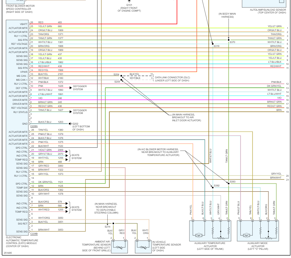

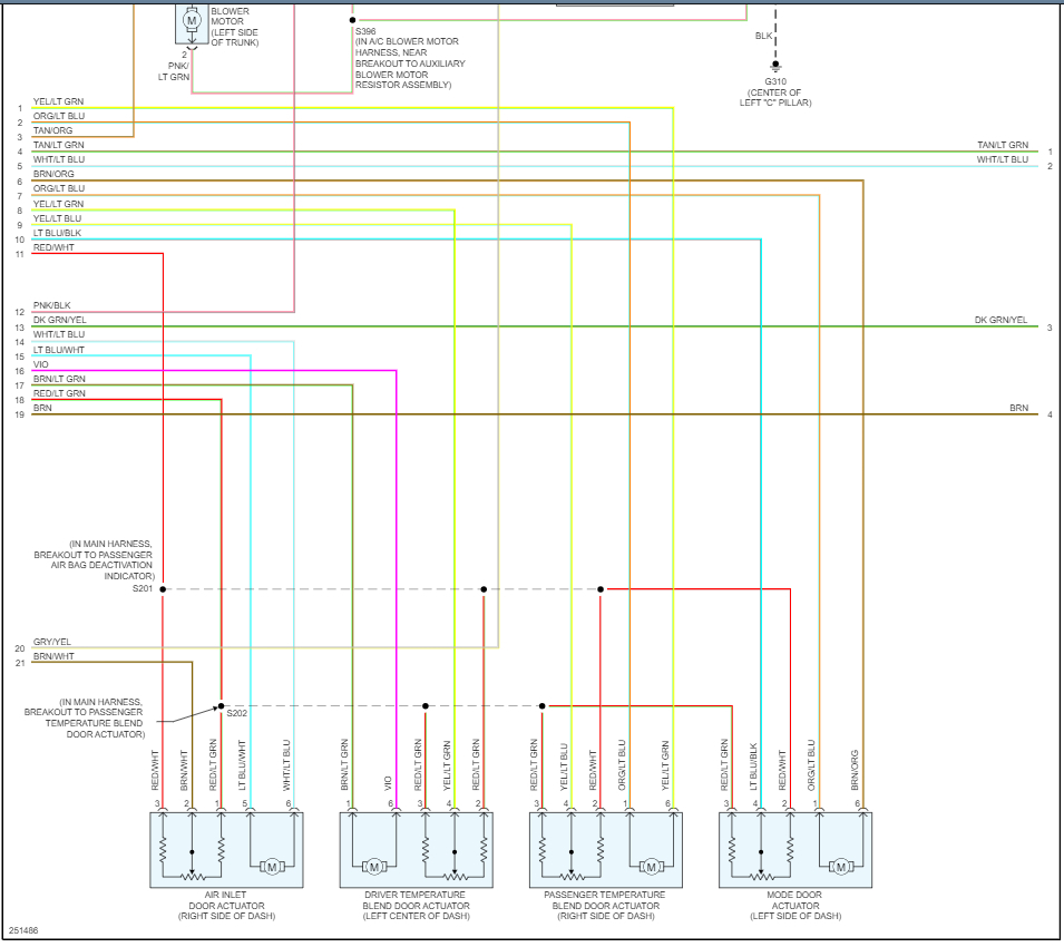

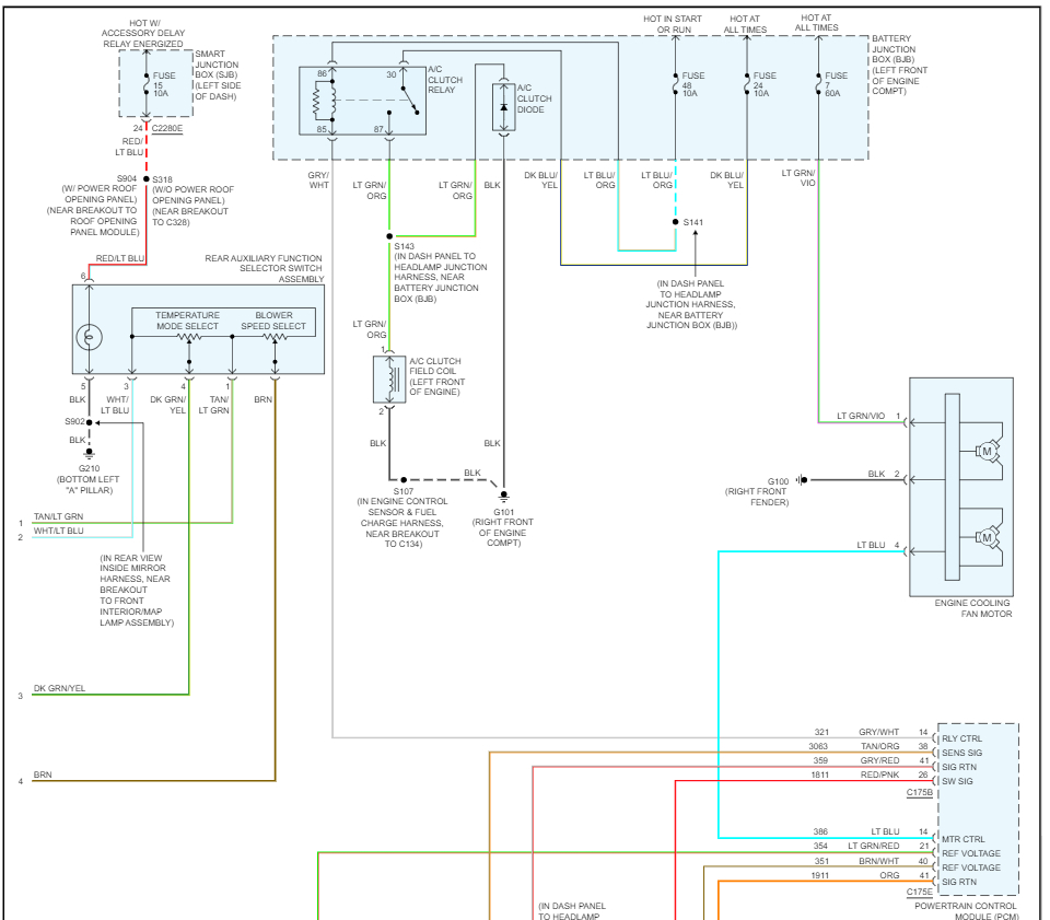

Wiring diagram with dual A/C rear/front?
2007 FORD FREESTYLE
122,220 MILES • 3.0L • V6 • 2WD • AUTOMATIC
CODEY ALLEN
Overcharging battery/alternator from ECU/ECM.
Jul 7, 2023 at 11:45 PM
  • 54,840 POSTS

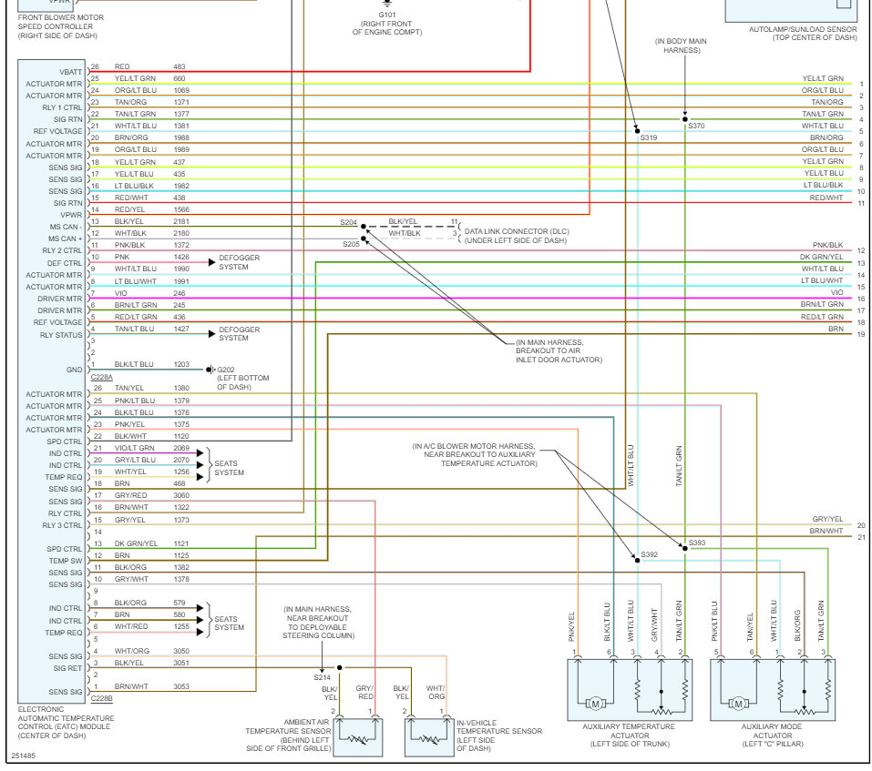

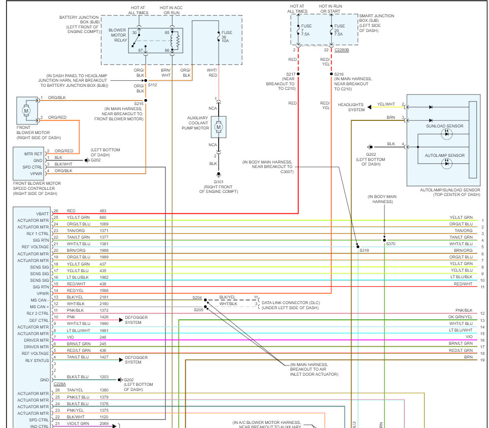

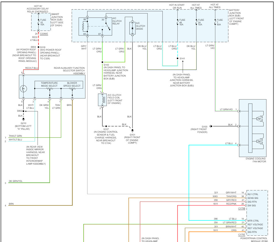

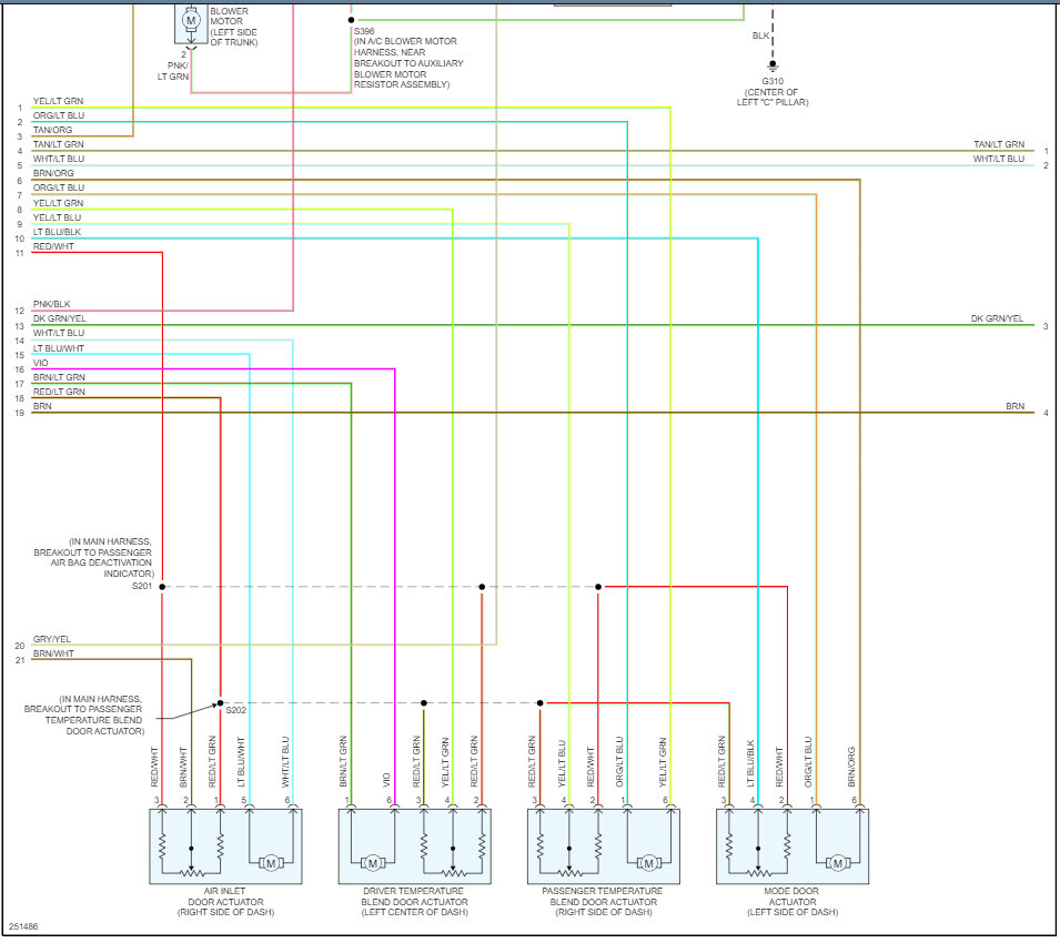

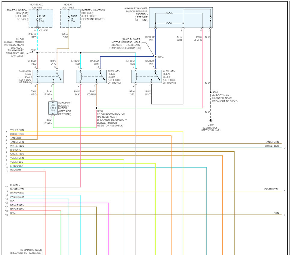

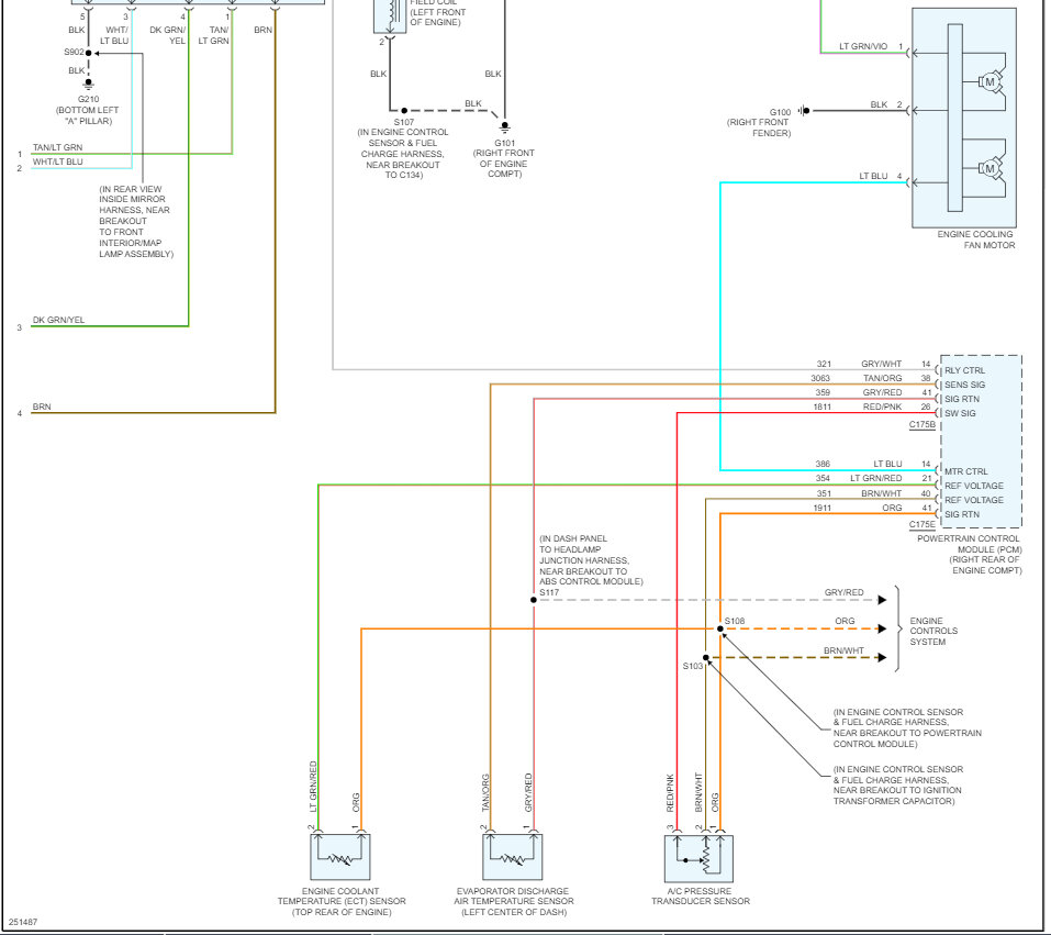

Here are the wiring diagrams as you have requested but I don't think they will have anything to do with the car overcharging the alternator. This guide can help you test the connections:
Check out the images (below). Please let us know how it goes
Jul 8, 2023 at 12:40 PM
