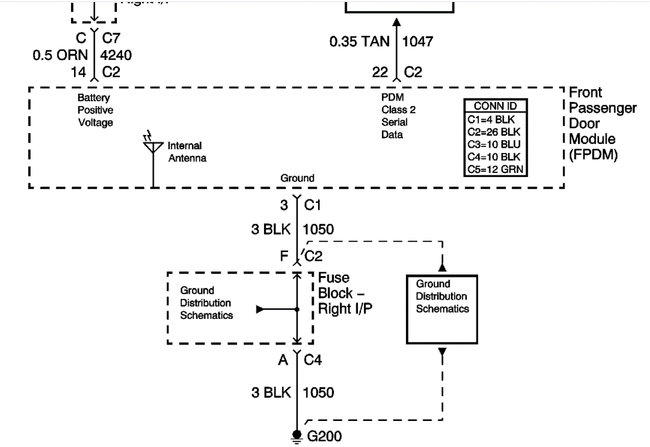

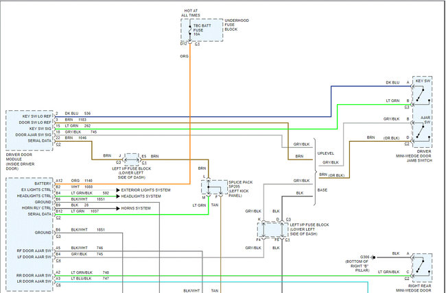

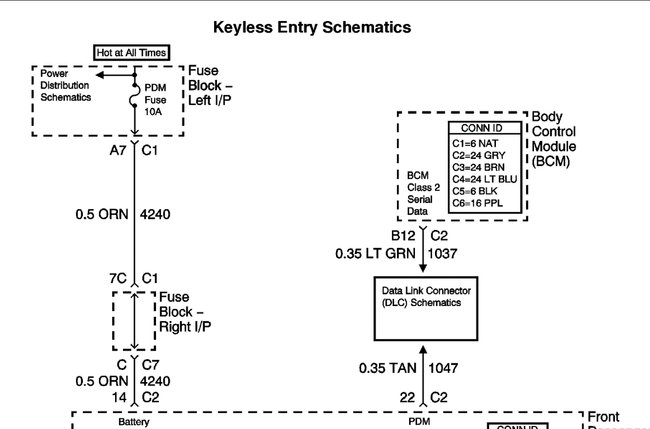

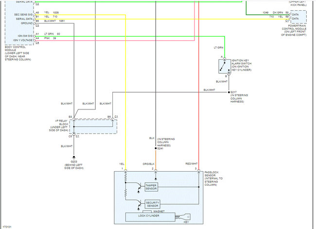

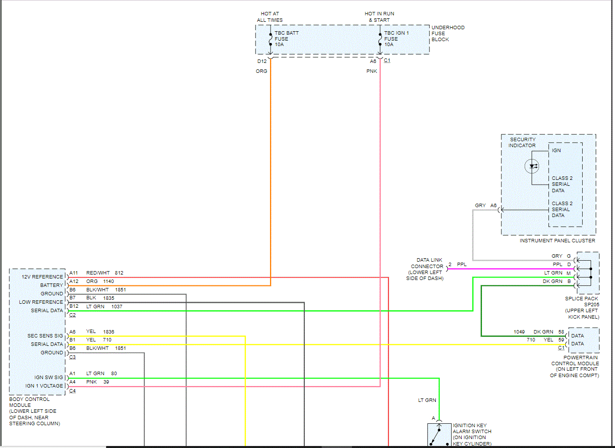

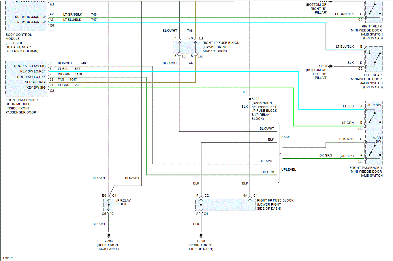

As far as the VATS, the first two pics below are the schematic for the forced entry circuit and pics 3 and 4 are for the pass lock circuit. The last two pics are the manufacturer's schematics of the keyless entry.
I had to cut each pic in half to make them readable, but I did overlap them so you can follow from one to the next.
Let me know if this helps.
